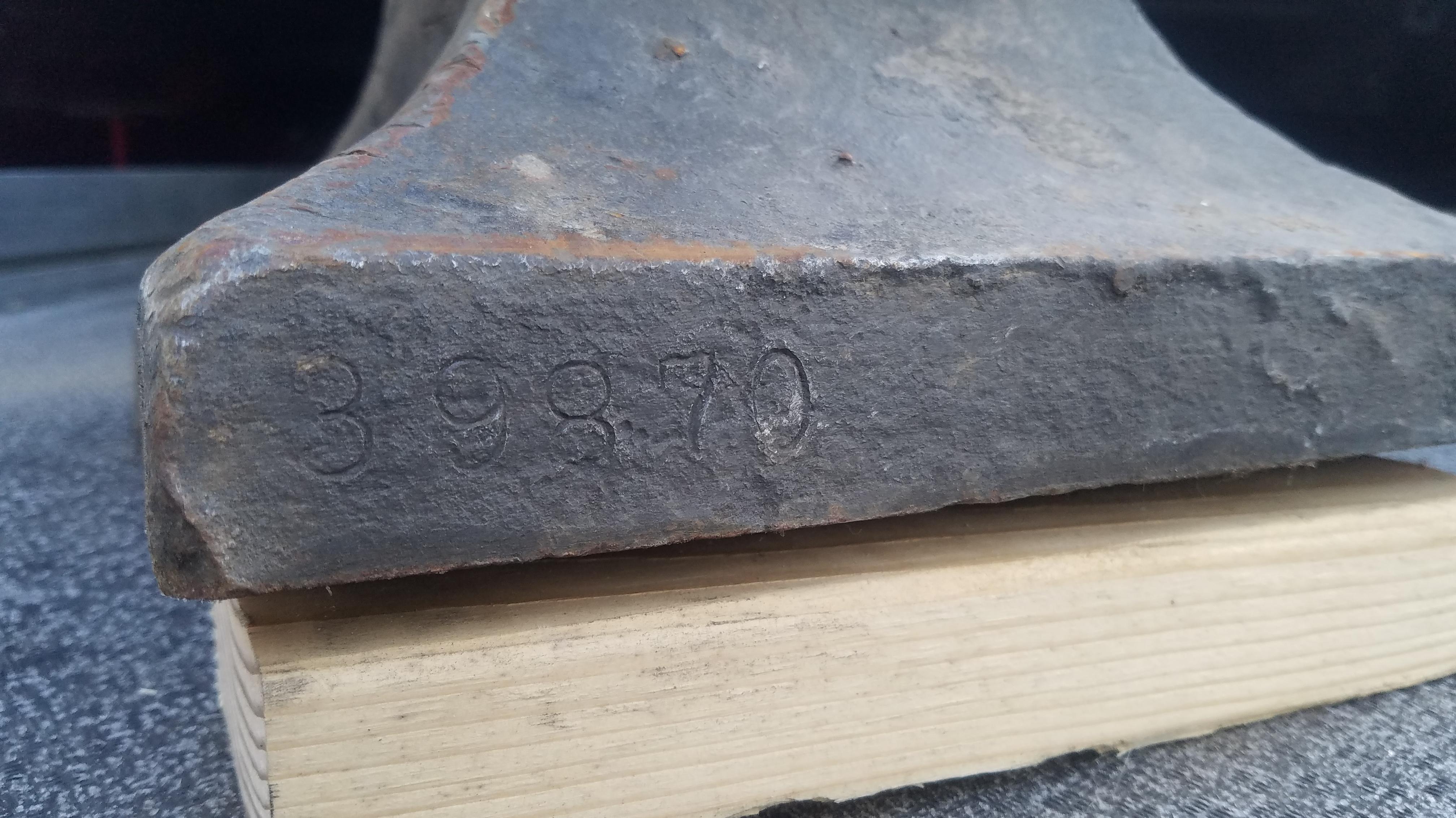

Avirgo Posted January 11, 2020 Share Posted January 11, 2020 Hi all, not trying to hijack this thread but have the same question and this seems like a good place for this information to live. I just picked up an Arm & Hammer anvil and would like to know the sam info on mine! on the Arm & Hammers is the weight marked as lbs or do have to do the stone conversion thing like a Peter Wright? my anvil says 265 for the weight? and the SN# is 39870 thank you "ALL" for all the info on this site!! Quote Link to comment Share on other sites More sharing options...
Irondragon Forge ClayWorks Posted January 11, 2020 Share Posted January 11, 2020 Welcome aboard... have you read this yet? READ THIS FIRST It will help you get the best out of the forum. A&H marked their anvils in pounds. I'm sure someone with a copy of AIA will be along to give a date range of when it was made. It was made by Columbus Anvil & Forging, Columbus Ohio. It's a good looking anvil from the pictures. Have you done a ring & rebound test on it? I hope you have read about not doing any grinding, milling or welding on the hardened face. As far as hijacking (snort) we do that all the time. There are several other interesting threads about the A&H the read this thread will explain how to do an effective search. Quote Link to comment Share on other sites More sharing options...
Avirgo Posted January 11, 2020 Share Posted January 11, 2020 Thank you Clay, I read the link you added it was very informative I will have to reference it for a while I think! Quote Link to comment Share on other sites More sharing options...
