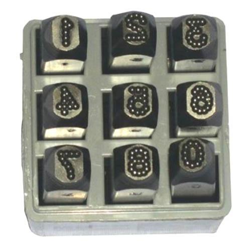

BIGGUNDOCTOR Posted April 5, 2018 Share Posted April 5, 2018 If these are pressure cylinders you use a rounded punch to avoid stress risers. There are companies that sell number and letter punches just for that application. Quote Link to comment Share on other sites More sharing options...
Claude Brandon Posted April 5, 2018 Author Share Posted April 5, 2018 Thank you for the advice. Quote Link to comment Share on other sites More sharing options...
BIGGUNDOCTOR Posted April 6, 2018 Share Posted April 6, 2018 they are called low stress stamps. Quote Link to comment Share on other sites More sharing options...

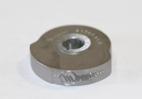

Claude Brandon Posted April 9, 2018 Author Share Posted April 9, 2018 Hi BGDoc , unfortunately the customer wants a punch made of their company mark ,else it would have been a simple solution. The one they have had made looks like it has been machined but does not perform very well on the stainless steel cylinders they are punching on as the cylinders are small and round so with a square punch the marks do not look very nice and is not easy to punch. Many thanks for your effort though. Quote Link to comment Share on other sites More sharing options...
ThomasPowers Posted April 9, 2018 Share Posted April 9, 2018 talk them into electro-etch! less problems with stress risers and you can do great marks---a lot of knifemakers use it. Quote Link to comment Share on other sites More sharing options...

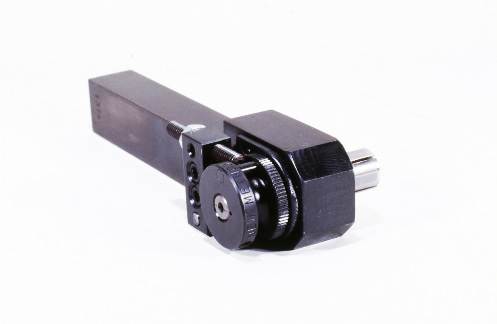

BIGGUNDOCTOR Posted April 9, 2018 Share Posted April 9, 2018 May need to look at roll dies instead if they want a stamping. Quote Link to comment Share on other sites More sharing options...
