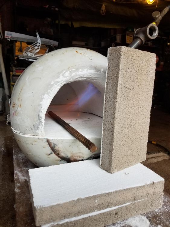

cbrianroll Posted April 7, 2018 Author Share Posted April 7, 2018 Well....slowly made progress, forgot to take pics along the way.... Here I am today..first firing...hows it look? Rebar was in there just for fun...turned red (inside the forge, took it out couldn't see it) in 3 min roughly, wadnt really keeping an eye on it. Don't seem to sputter....sounded like a weed burner. Still new to this do I'm not exactly sure what to look for in flame color....and should I fire a few small times to break it in? Burner angle is off abit still I just got my tap today. Thanks Quote Link to comment Share on other sites More sharing options...
WayneCoeArtistBlacksmith Posted April 8, 2018 Share Posted April 8, 2018 Looks good to me except I would angle the burner more to run across the top to swirl the flame around inside the chamber. Let me know if I can help you again. Wayne. Quote Link to comment Share on other sites More sharing options...
cbrianroll Posted April 8, 2018 Author Share Posted April 8, 2018 Not a bad first try lol, thanks to everyone who's posted tutorials and offers advice!! I'm not happy with several things about this forge (the way i made it) but now I know what to do differently next time. Hopefully tomorrow I'll get a chance to mess with it a bit more. Quote Link to comment Share on other sites More sharing options...
