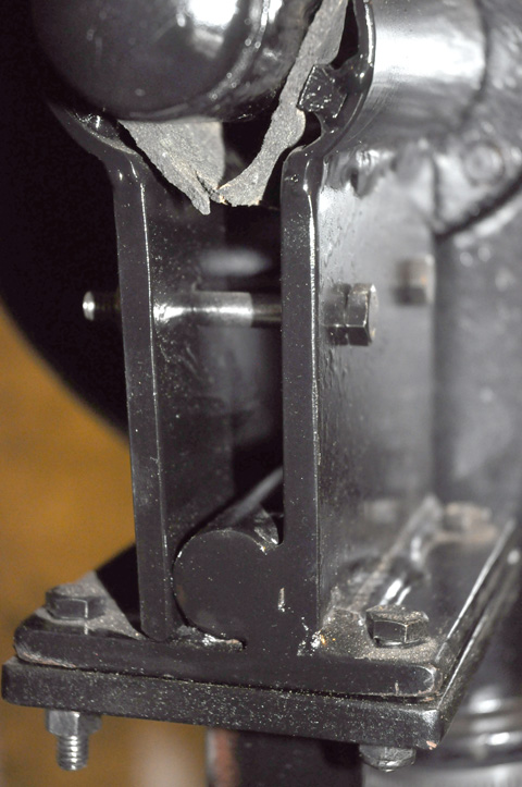

Here are a couple of photos showing the improvised bracket. The round rod shown is welded to the base plate and the jaw to the right and serves as a pivot point for the movable jaw to the left.  Each jaw (cut from a segment of heavy wall tubing) has a rib (cut from the same tubing) on the inside.  There is a sheet of thick cork gasket between the blower and clamp, and the two bolts draw the clamp together.
