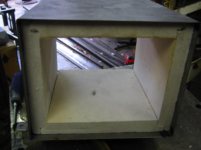

Howling dog forge Posted March 1, 2018 Author Share Posted March 1, 2018 First layer refractory cut and notched, trial assembly. notching fixture what to do with these?? Quote Link to comment Share on other sites More sharing options...
Howling dog forge Posted March 2, 2018 Author Share Posted March 2, 2018 two pounds of Kastolite mixed with 10 fluid Oz. of distilled water covers 72in² at 1/2" thickness. Now we see if it will stick to the Duraboard. This is where the whole thing could fall down. and have to be rethought. in retrospect I think 1/4" thick may have done the job. Quote Link to comment Share on other sites More sharing options...

Howling dog forge Posted March 6, 2018 Author Share Posted March 6, 2018 7 minutes ago, Binesman said: Kastolite is super sticky i dont see you having any issues with it bonding to duraboard At 3 oz water per pound it just rolled off, mixed a bit wetter than I had originally planned at 5 oz per lb. Quote Link to comment Share on other sites More sharing options...

Howling dog forge Posted March 24, 2018 Author Share Posted March 24, 2018 trial fit of bottom and sides, angle of burner path. Holes line up pretty well. so far so good. Quote Link to comment Share on other sites More sharing options...
Howling dog forge Posted March 27, 2018 Author Share Posted March 27, 2018 I put my panels in the oven at 350º for 30 minutes just to be sure they were dry, and then put them into my old forge at 2100º for 20 minutes and slow cooled. assembly showed a very marked shrinkage, No wonder monolithic cast cracks. Now to decide what to do with the gaps, I can leave them, fill them with kastolite or fill them with Kowool. I am going to put a 1/2" face on the openings if for no other reason than to protect the soft refractory. Quote Link to comment Share on other sites More sharing options...
Howling dog forge Posted March 30, 2018 Author Share Posted March 30, 2018 put everything together and fired it up, Some mistakes were made and changes are planned, the thermocouple was a waste of time and money, it works OK but I think the position is a bit of a problem. the lift door locked up as the support heated, easy enough to fix that one, I think 1/4" kastolite is better than 1/2", it takes too long to heat up and go infrared. I think I may change the 35º burner angle to 45º. I managed a 3 layer faggot weld in 3/8" round without much problem. All in all I think it shows promise. The first picture is after it was off for 10 minutes or o and I lit it for affect. tune in next week when we cut some of it apart and re weld it. I think I would like to see what a .030 mig tip will do as well. Quote Link to comment Share on other sites More sharing options...
