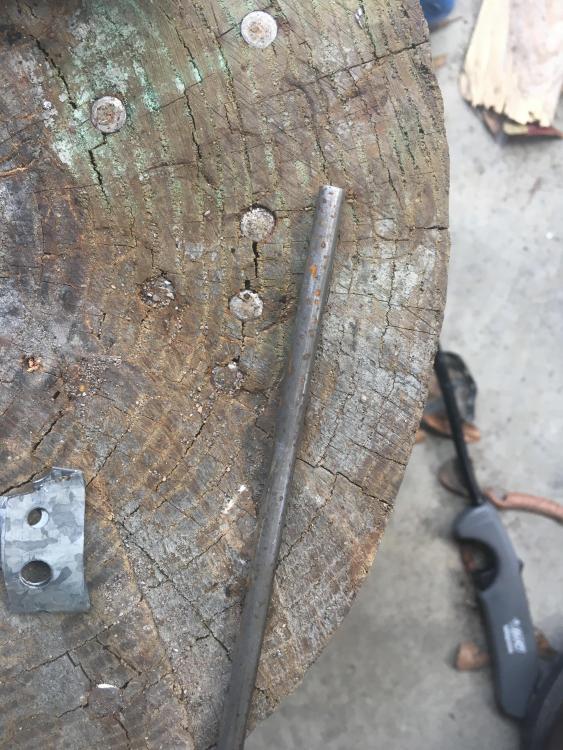

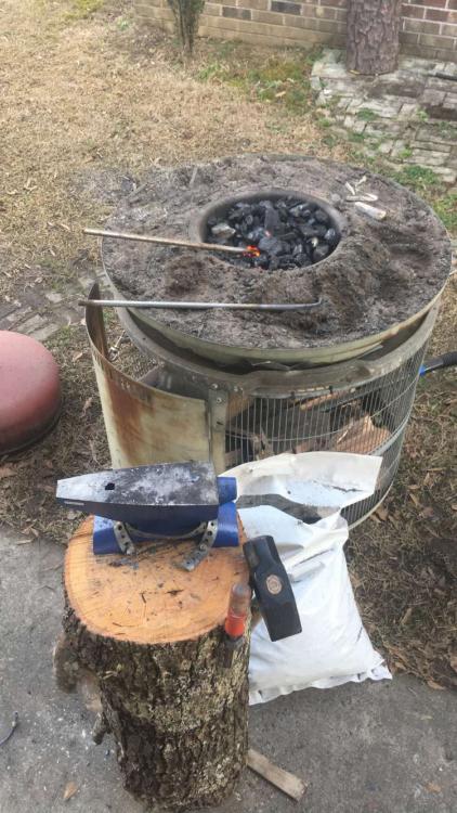

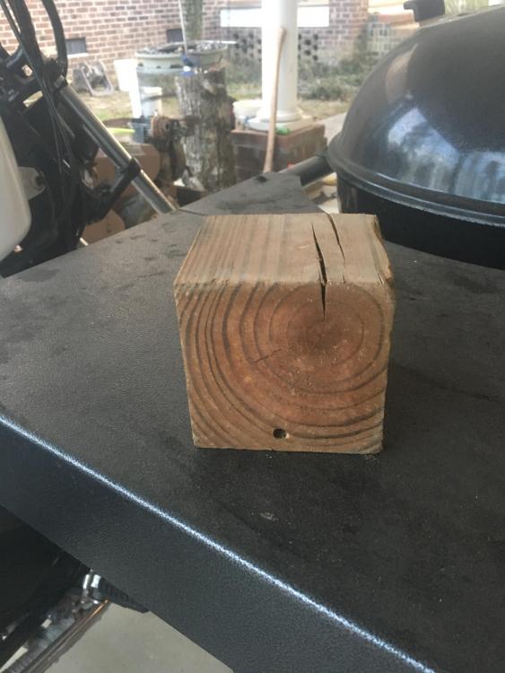

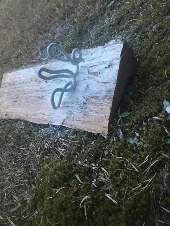

SmithCaleb Posted January 25, 2018 Share Posted January 25, 2018 What's up fellow smiths! My name is Caleb and I'm a beginning smith from South Carolina. I've only been hitting hot metal with a hammer for about 5 days now. I finally finished my first project after coming home from work and immediately fireing up the forge everyday this week. I've always been interested in smithing and I finnaly got the chance to do it after lots of preparing. Here is a picture of my set up... forge is the shell of an old hvac system shop vac for air and a cheap harbor freight anvil. so on to my first project.. but alittle back story first. Since my girlfriend has had to put up with my constant babbling on about blacksmithing and put up with binge watching forged in fire for the past couple months I decided to make her a gift a my first project. I decided to forge her initials out of some 1/4" round stock (from tractor supply) once I finished the forgeing i painted everything and decided to mount it on a wooden block. Here is what I came up with (its a little girly but she likes cute little things so it works out) 1/4" round bar from TSC forging complete painted glossy white cut a cube out of a 4x4 and drilled a hole for mounting letters painted block finished product!! let me know what you guys think! Has anyone ever done any cursive? Or words out of a single puce with no welds if so I am very curious to hear about it because I couldn't don't any info on the subject so I just had to figure it out as I went along. Im hoping to start forging my first knife soon and get back into some more manly forge work lol ps. Comment if you can read the letters lol I can easily see it but then again I already know what it says so any feedback would be great!!! Quote Link to comment Share on other sites More sharing options...
Marc1 Posted January 25, 2018 Share Posted January 25, 2018 You got me ... I don't know what it says ... a, l, ? ... alice? I like it anyway. never done any signs or lettering that way. Why don't you try knots? There is a guy here that does knots sculptures that look terrific. PS I got my boat from South Carolina Quote Link to comment Share on other sites More sharing options...
SmithCaleb Posted January 25, 2018 Author Share Posted January 25, 2018 It's her initials only 3 letters. But hey if you can read 2/3s of it hopefully she can to and can figure out the last one lol Quote Link to comment Share on other sites More sharing options...

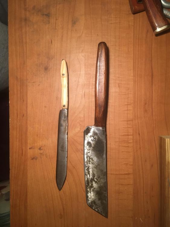

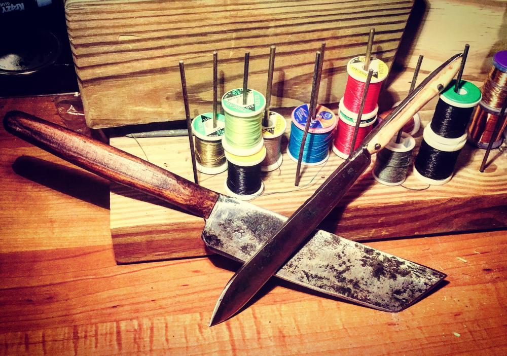

SmithCaleb Posted February 12, 2018 Author Share Posted February 12, 2018 Update: I have since made my first 2 knives and this is what I came up with. The Tanto is rr spike with the head cut off and flattened and the smaller one is rebar. I quenched the rebar in water and tempered at 400 for an hour. The edge is hard and the spine is soft I tested with a file. The handles are pieces of pallet wood because that's what I had laying around and nails as pins. Next I want to do a knife out of good HC steel and nice handle material. I'm probly going to use 1095. Any suggestions or tips on heat treating or recommended handle material would be great. Quote Link to comment Share on other sites More sharing options...
Latticino Posted February 12, 2018 Share Posted February 12, 2018 Kevin Cashen is the man as far as heat treating blades is concerned. He has a great outline on heat treatment on his site, and specific info on heat treatment of 1095 here: http://www.cashenblades.com/steel/1095.html. Most reasonable hardwoods will work for handles (avoid ebony though). For a low cost alternative you can always get scrap from a heavy pallet (often oak) or cutoffs from a wooden flooring contractor. Personally I've become kind of attracted to using cherry. It not the most figured of woods, but it is a nice natural color and complements brass fittings well. There is also a lot of info on knifemaking in this forum. I strongly suggest you read through the stickies. Looks like you have gotten off to a good start with your first two, but I suggest you do a little more reading on optimal knife crossections, profiles, materials of construction and heat treatment. Quote Link to comment Share on other sites More sharing options...
