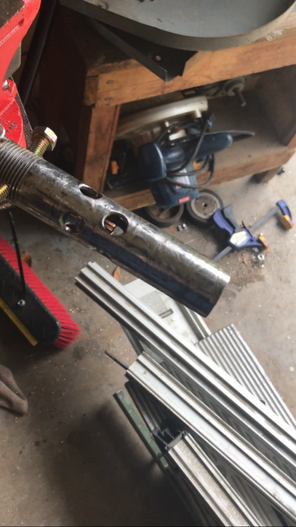

Is the tube as designated in the directions? How do you measure the tube length, from where to where?
I don't see an elbow at all. Does the designer say why it's important to use a "street" elbow?

pretty sure they call for a 9" pipe not a 6" pipe like I have on there right now. But Without a good flare I'm kind of at the mercy of what I've got at the moment.
Holes are measured out 2" from the end of the pipe and 2 3/4" and drill them out alternating pattern around the pipe.
The video didn't give a good explaination for the street elbow. However I did read a post YOU replied to Frosty about a Mathewson burner and you had stated how you didn't understand the need for the elbow (which I agreed with) so I by passed it for now until I get another reason for it.

My question wasn't clear. The overall length of the piece of pipe you make the burner from isn't that important. By tube I meant "Mixing" tube, not being clear was my bad. The mixing tube is the length of burner from the last air intake port to the outlet end. Not counting the flare.
If you packed all that in a 6" length it's WAY short.
How can the holes be drilled from 2" AND 2 3/4" from the end?

Oh mixing tube? Then yeah I'm short cause the entire tube is 6" haha.
this is the burner with a longer pipe and bell reducer. Seems like the pressure maxed out on me again. It works but not much of a jet stream coming from it. I will try a different size mig tip to see if it boosts the performance.
Are you going to use it as a torch? If not why are you tuning it in a vise?
This is my first burner so I really just wanted to make sure it works and is able to be tuned. Wanted to make sure it was completed or at least operational before I put the wool/fumed silica in the forge body so I'm able to cure it.
