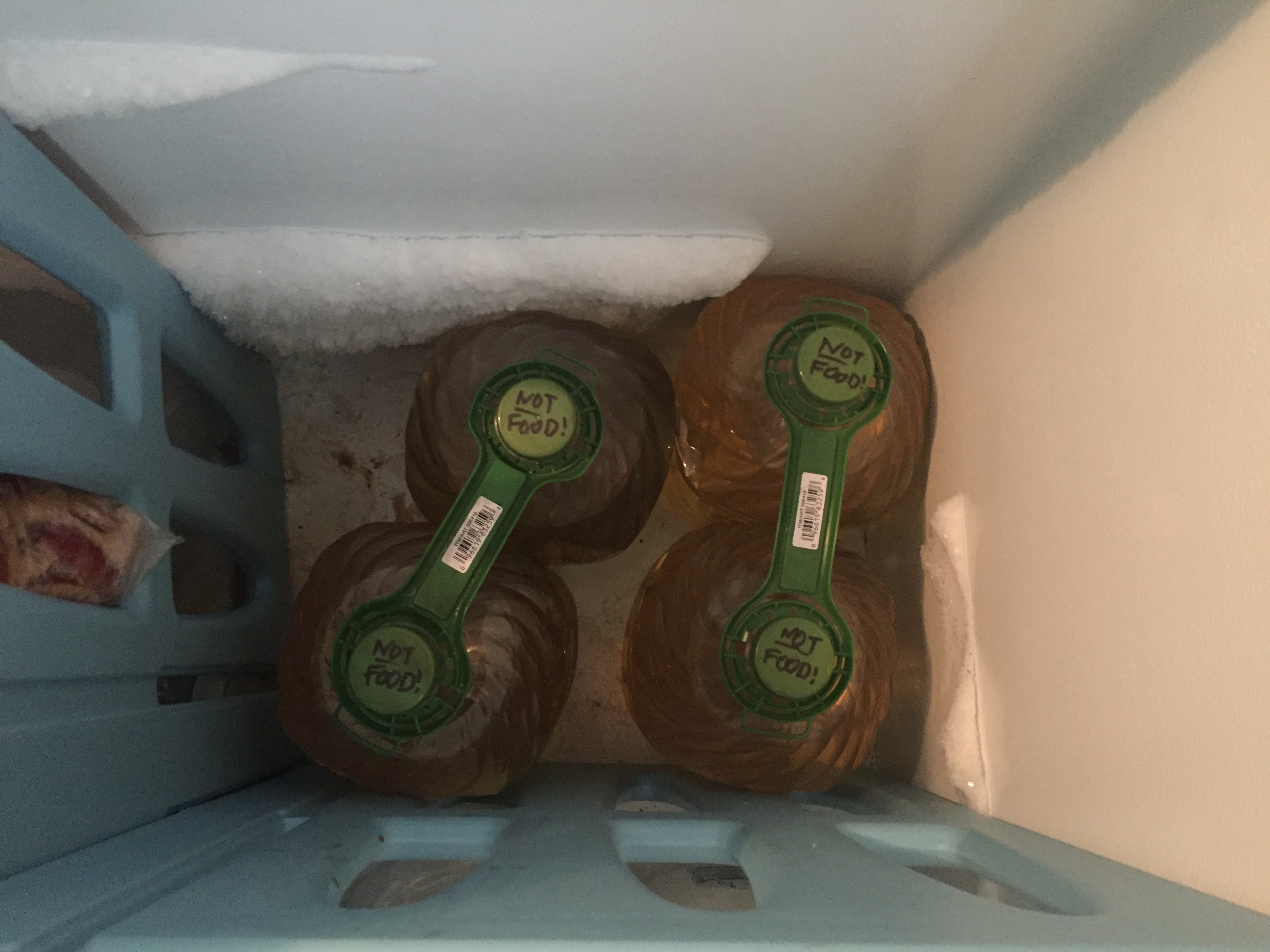

Stealing an idea from the preppers, I've decided to keep my canola oil in the freezer, in its original jugs. Should keep it from oxidizing so much between uses.
Note the labeling of the caps.
