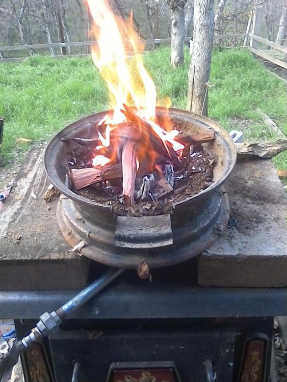

Just starting out and have a tire rim with cinder blocks around to keep the fire contained...  I'm using my air compressor and blowing from the top right now.  Since I'm on a limited budget I'm using solid wood,  combination of oak and manzanita.  Anybody have any advice for how I can improve this setup?
I'm thinking of making a permanent forge approx 2' x 2' but not sure if I should build it from bricks or lava rock.

A steel wheel rim is not a good choice in my opinion. It will work, just not well.
Try a brake drum, the ones with the groove around the edge. Make a circle from 1/4 inch flat bar and weld the circle to the bottom of a table top say 20 inches square. The circle should drop into the groove. This will give stability to the table top as well as make the fire a bit deeper. Remember to support the forge as the table top will just sit in the grove, on the top of the forge. The table top will keep the fuel (coal or wood) from falling onto the ground, and allow a deeper fire.
You will want to have a deeper fire is you are using wood. This allows the wood to convert to charcoal as you forge in the charcoal or embers. With the table top you can then make the fire the depth you need for the wood fuel. Depending on the project, a smaller but taller fire is the key. Use a ring of sheet metal, bricks, mud, what ever, to deepen the fire when needed.
This is one area where the 55 Forge is good. It can be as deep as you want, or can be modified as you need.
The compressor as an air supply will work but is too concentrated and high pressure an air blast in many cases. You can feed it into a larger pipe and make it work if you throttle it down.

Well... Like I said a very limited budget... I have tire rims laying in a pile but no brake drums haha.  This is one where I can only use the material already on hand.  I have a big pile of bricks, lava rocks, cinder blocks and tire rims.
As for the air, yes I was thinking attaching a larger pipe, most likely 2' and having the regulator set around 3-5 psi with a lever valve so I can open partially and increase the amount of control I have over the air.
Then build two forges, one from tire rims and one from bricks. Remember to make them a bit deeper as your using wood for fuel.
There was a fellow on the site that built a forge that burned wood by just stacking bricks. It was normally aspirated and worked to get him started. I think he later added air to make it better.
Was your air compressor free and can you replace if for free if you wear it out? There are blowers you can get often for free that will work better and BE MUCH CHEAPER!  (Got a local HVAC place? ask them about the exhaust assist blowers for super efficient furnaces that are on the bone pile after being replaced.)

With charcoal you need a deeper fire as the fuel does not contain as much heat BTUs per weight as coal. When you go from wood to embers you need a deeper fire still in order to convert the wood to charcoal. The charcoal can then be turned into embers for forging. How much deeper depends on your set up at your location and the amount of heat you need.
The issue of how much air will resolve itself with a deeper fire. Use just as much air as is needed to get the heat you want from the fuel. Overfueling is not a problem as fuel down not make a fire hot, air makes a fire hot.
