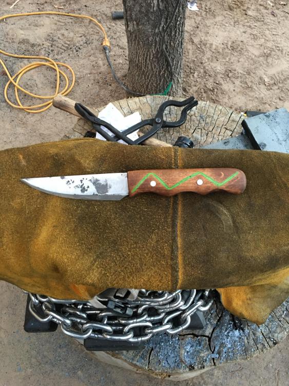

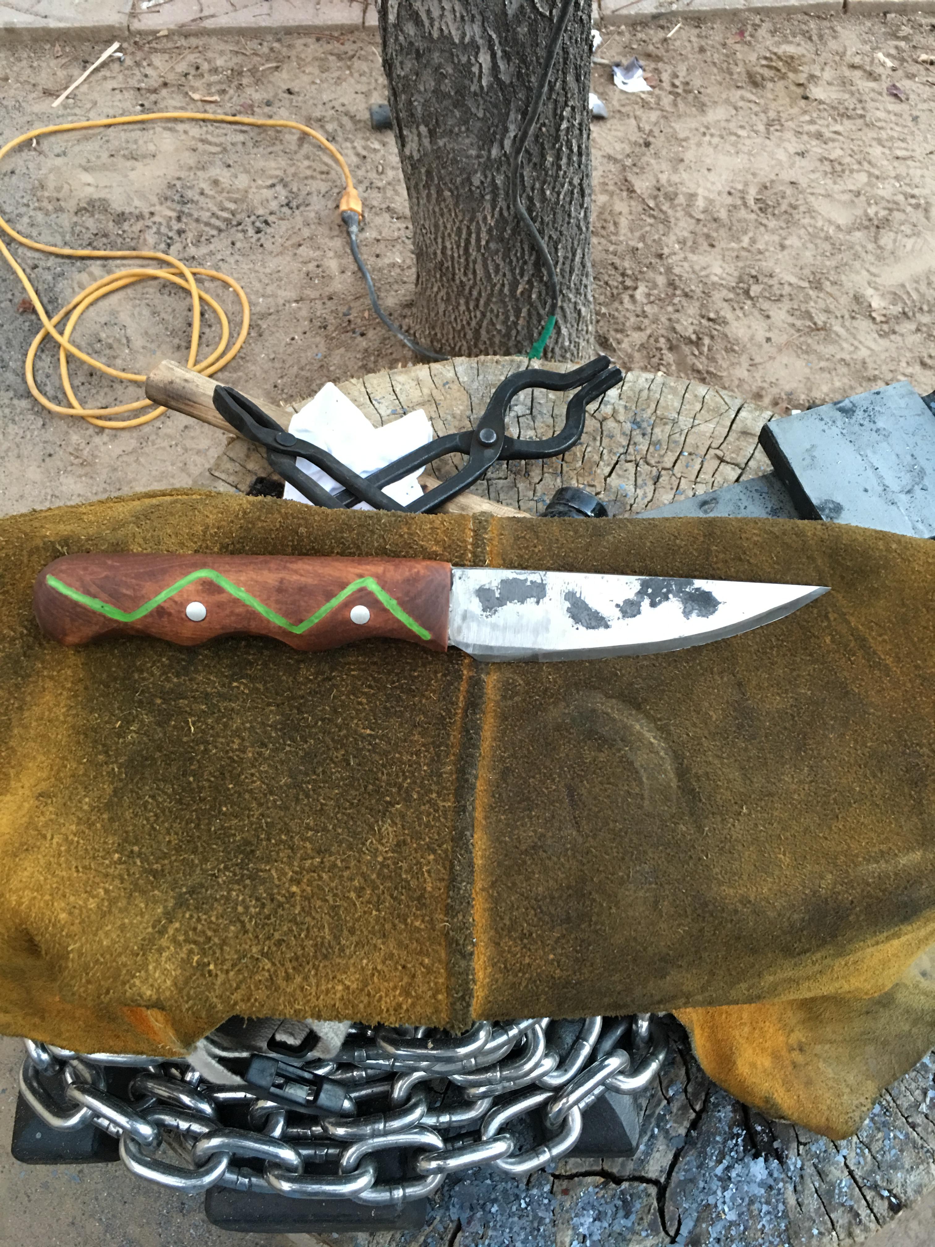

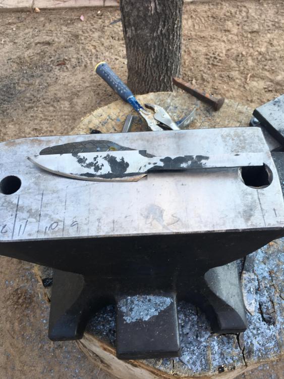

Wayne Mitchell Posted November 20, 2016 Share Posted November 20, 2016 I forge welded six pieces of flat strap into one billet? (Is billet correct term) then forged the blade. I honestly have no idea as to what I am doing in terms of education, I was not able to get the blade to harden. Metal is still soft so will not be able to use as a real working knife Quote Link to comment Share on other sites More sharing options...
ThomasPowers Posted November 20, 2016 Share Posted November 20, 2016 Was the strap high carbon steel before you welded it up into a billet? Forge welding usually lowers the carbon content so if it wasn't high carbon to start, (or was borderline) then it won't harden after being welded into a billet. Making sure to keep the forge atmosphere reducing helps as does keeping it hot as little time as possible. Many people starting out take a lot longer to forge a blade than with experience and you are losing C with time at temp! Quote Link to comment Share on other sites More sharing options...
Wayne Mitchell Posted November 21, 2016 Author Share Posted November 21, 2016 Not sure what the strap was, bought it at Home Depot, so probably very low content, I never even thought about carbon content at the time, just has to see if I could weld it with a forge. i did time it. Right at an hour and half to forge the knife shape from the billet blank. So as I understand your message I need to become much more efficient with the amount of time I work the steel to shorten the amount of heats. Thank you for the advice it will be heeded. Quote Link to comment Share on other sites More sharing options...

lionheart Posted November 23, 2016 Share Posted November 23, 2016 Looks a xxxxxx lot better than my first try! Echoing what Mr. Powers said, most strap available at hardware stores won't make a decent blade--especially after you beat the carbon out of it, but it's sure fun to practice isn't it? Anyway, not a bad first piece! Quote Link to comment Share on other sites More sharing options...
Steve Sells Posted November 23, 2016 Share Posted November 23, 2016 Are you sure about that? I am not aware of how beating removes carbon, and as stated so many other places, mild steel does not really have much carbon to begin with. Quote Link to comment Share on other sites More sharing options...
Tubalcain2 Posted November 23, 2016 Share Posted November 23, 2016 5 hours ago, lionheart said: Looks a xxxxxx lot better than my first try! Echoing what Mr. Powers said, most strap available at hardware stores won't make a decent blade--especially after you beat the carbon out of it, but it's sure fun to practice isn't it? Anyway, not a bad first piece! it's my (limited) understanding that you can lower the carbon of steel by overheating / heating to many times, but i dont think the actual hammering will do that. i am not sure on that, though. Quote Link to comment Share on other sites More sharing options...
