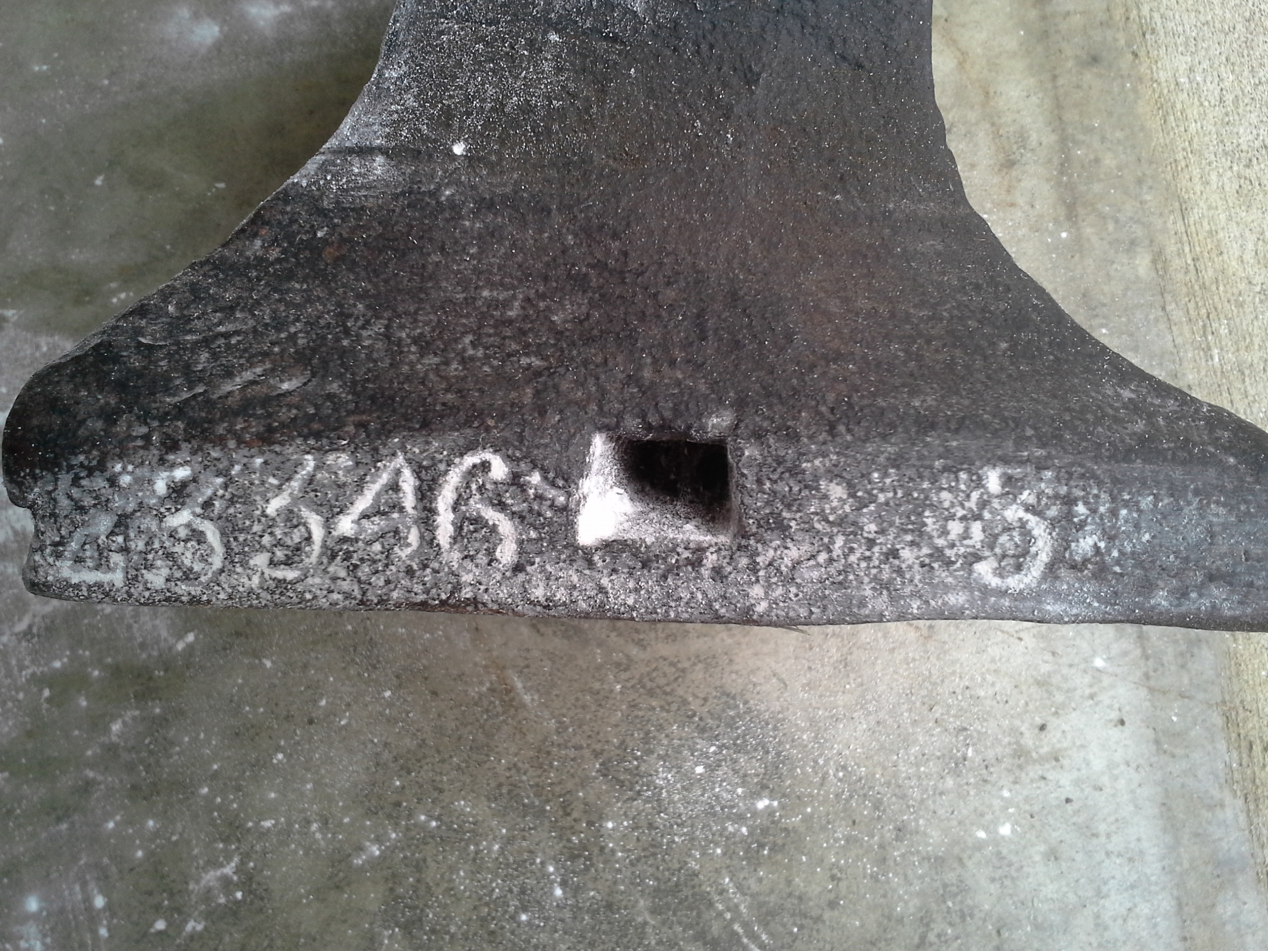

Venture A Guess ?
I got the weight.  That was easy. But I say Acme. That's a brand, yes?
There be much jiberish on this thing. I can see what may be "PATENT" as well as "ANVIL"
Seems solid. Heck of a ring and rebound on a hammer and 1/2" ball bearing.
1 hour ago, SReynolds said:
jiberish
   I associate "jiberish" with Mouse Hole. In the first picture, the weight in stones, Mouse Hole. No way its an Acme. Acme was a Sears brand. Euro Sears, cant be.
  Oh no, there's more than one picture. Those aren't Mouse Hole feet. Oh no, serial numbers. Acme?
  Who made that? The plus side, ring and rebound. Hammer on.
        N.N.F.                         Beautiful, Manchester, Michigan. USA
Acme isn't that the brand that keeps landing on the Road Runner?
This is what I see above the stone weight and definite Mousehole feet.
(Illegible)
HOLE
FORGE
SHEFFIELD
ENGLAND
(WARRE)NTED (mouse shaped logo) HOLE
PATENT
Thank you. I will dust it again and adjust the light/take another look.
It weighs 85 pounds. That sounds about right?
