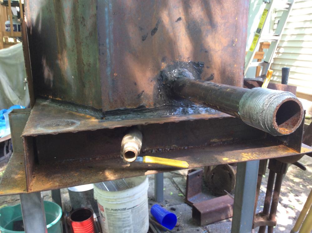

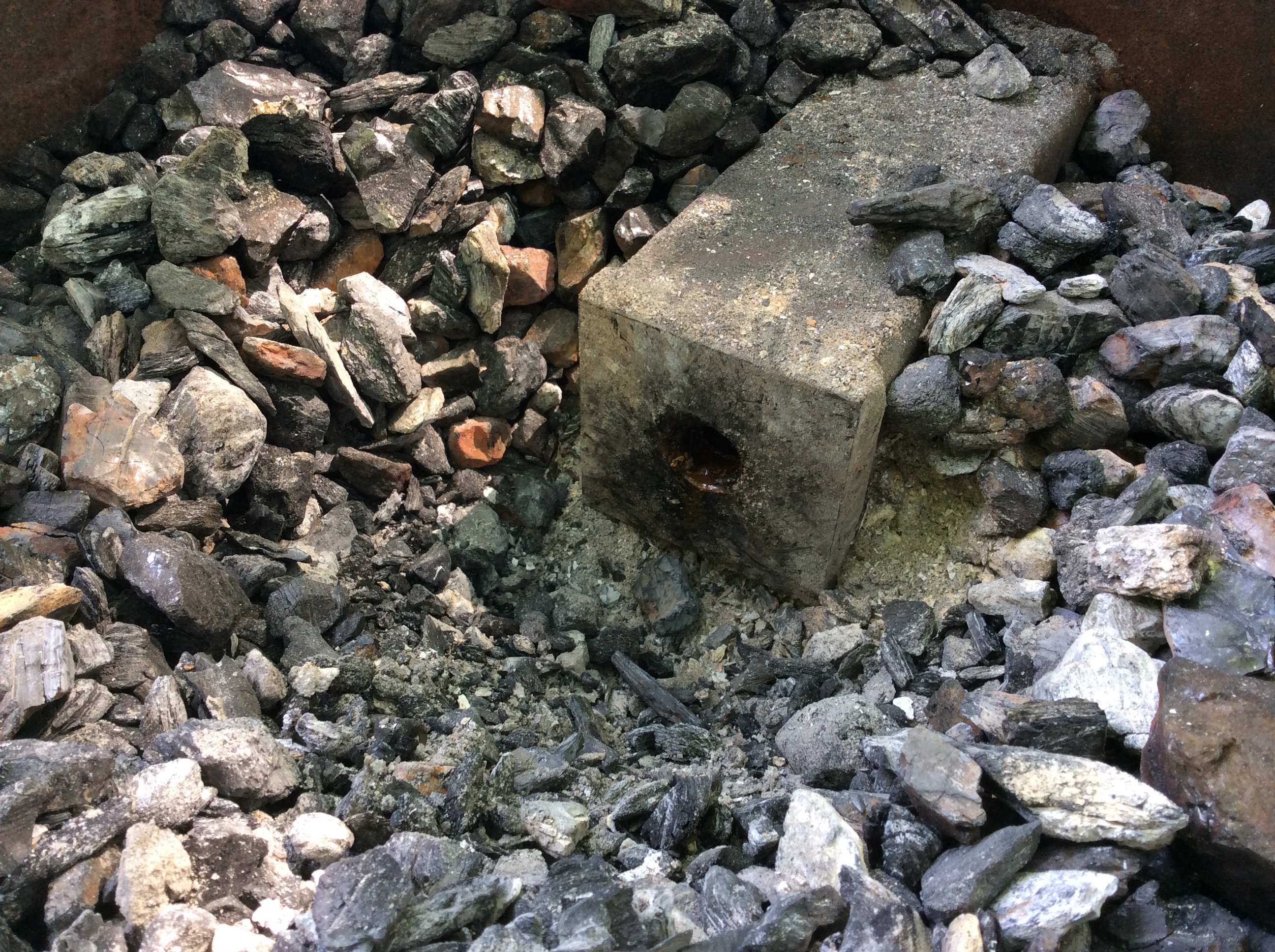

image.jpegThe tuyere is a 1 5/8" pipe jacketed by the 3/16" square tube seen here.  The biggest design flaw I have noticed so far is the size of the air outlet.  It is now about 3/4" but I think the size differential is causing a pressure drop and has made air a challenge.  Right now I have an old dirt devil vacuum that is way too strong (I use it to establish the size of the fire) and a bathroom vent fan that struggles to overcome the pressure drop (I use it to maintain the fire once it is strong).  Switching air sources is tedious and I'm looking for a quiet but stronger option.
image.jpegFrom this view you can see the bosh.  The pipe runs through and out the back.  Welding this up was a serious challenge and I ended up deciding to double down and use some high temp silicone sealant as insurance.  I had a few small leaks and didn't feel like chasing them with my welder for days.  According to everything I have read I should not have put the wall of the bosh right next to the fire but, so far I have run this thing for over six hours and not reached boiling temps with the water tank (it holds about 20 gallons I think).  The shape and size was totally based upon the materials I was able to get cheaply.  I could have paid to have plate steel cut to my dimensions but I'm too cheap.
image.jpegHere you can see the drain I installed along with copious amounts of insurance caulk!  The duct tape is for fitting the pipe with the pvc elbow I use as an adapter for my Frankenstein air system.  Please feel free to laugh at my welds.  I'm still learning how to use this thing efficiently but it sure can create a super hot fire.  Right now I can't get the control of the heat and have quiet at the same time.  I hate running the loud dirt devil vacuum and would love any ideas for a more quiet option.  Currently I'm using anthracite because it is the only thing available to me.  Plus, I live in suburbia in an uptight town and fear getting shut down if I produce too much smoke.  Problem is, anthracite is really picky about needing constant and consistent air.  After reading some here on IFI I'm thinking about using two fire bricks to shape my fire better but, aside from that, I would love more feedback and ideas on how to improve my setup.  Thanks in advance,

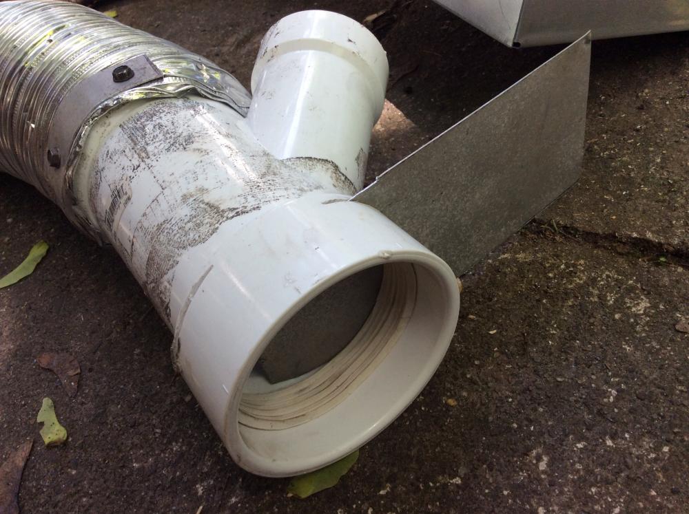

The easiest way to update your setting for variable air volume would be to use the Dirt Devil vacuum and modulate the output in one of three fashions:
  1. Put an outlet TEE, or cut a hole in the connecting pipe, that can dump out some of the air before it gets to the tuyere.  Use a movable cover on that outlet (dump gate) to increase the bypass air or the air fed to the tuyere as required.
  2. Add a butterfly damper to the supply side of the dirt devil vacuum (may be a problem with the fan motor as the extra resistance that cuts the air supply will force it to work harder)
  3. Put an adjustable shroud over the air inlet for the vacuum and open and close as required (mock this up in cardboard to see if it works.  some constant speed fan motors don't like getting starved).

Latticino, I rigged up an air diverted out of a pvc three way connector but haven't used it with the dirt devil because the connection between the two is a minor pain but mainly because I hate the loud whine of the thing.  My neighbors can hear it three houses down and I find it maddeningly loud.  Does everyone just learn to deal with the volume of their blowers?
My jury rigged air diverter:  I am thinking that maybe the air flow should be straight through and the release should be the angle.  I did it the way I did just for convenience because the smaller pipe section fits my tuyere pipe.  Thoughts?
I have to take moving to charcoal seriously but I want the forge to be capable of using any fuel successfully.  Do you think increasing the diameter of the air inlet at the end of the pipe will help?  I would have to drain the bosh in order to drill it out with a unibit because making it any larger will compromise my welds.  So I'd also have to reweld it once I finish.  It's a bit of a pain to do but, if it would fix my air problems it would be worth it.  I guess this is what happens when a novice tries to build more forge than he needs!  I sure learned a lot in the doing though.

Buzzkill, I already have a 100 CFM bathroom vent that is super quiet but can't push through the coal pile to maintain the fire well enough.  When I put work into the coals they move around and just one piece of coal can plug the air outlet such that the fire loses its mojo.  When I move that piece of coal two more fall into its place every time.  Raking coal is quite possibly the most frustrating thing about blacksmithing so far.  I swear the stuff is alive and actively trying to get itself where I don't want it!  What I'm trying to figure out is whether or not pressure drops in my air system (venting, air outlet diameter, etc..) are causing my problems or if it is an underpowered fan.  If others are succeeding with bathroom vent fans then it must be my air system.  If that's the case, I need to keep asking questions and seeking fixes.
A typical bathroom exhaust fan has, at most, around 0.5" of external static pressure capacity at the lower of the airflow rates it is designed for.  A fan curve or chart will tell you more.  Your diverter appears to be designed backwards.  You can definitely use a Wye fitting, like you have, but the variable damper should be on the outlet side of the of the bypass (or release as you call it) side, not on the main inlet.  In this I assume the flex duct connects to your forge.   If it actually connects to your fan, and you don't have enough airflow, I suggest that you damper the bypass side and close up the slot you made.  As I said, exhaust fans don't develop much static, but you shouldn't need too much provided you keep your duct lengths short, avoid elbows and offsets, use smooth wall ducts and avoid rapid transitions in diameter (30 degree transition angle is a good rule of thumb).  A photo of the entire system, setup with the fan in place, would make it easier to diagnose.
Others might be able to comment on the size of your coal.  The last workshop I went to we made an effort to screen out all the "fines" leaving us with only the larger size pieces (these were still in the 3/4" -2" minor diameter size though, not huge fist sized chunks.  This worked extremely well for the upblast style forges we used, but I'm not that familiar with a side blast, so don't know what kind of pressure and airflow are needed.  All I can say is that the conventional hand cranked or electric forge blowers I've seen all are more of the low airflow/high pressure style (radial paddles) instead of the high airflow/low pressure style (squirrel cage centrifugal) like your bathroom exhaust fan.  The former most likely develop 4 times the pressure yours does, for the same airflow.  If nothing else see if your exhaust fan has a backdraft damper built in.  Remove that.

Latticino, I can't help but think you are right.  The flexible hose was connected to the vent fan.  I made my decisions for convenience and I think I set myself back.  I was also concerned about coal size.  Small pieces of coal have kinda gotten wedged into the tuyere outlet and large ones have redirected the air flow causing me to have two separate fires on the side rather than one in the middle.  The dirt devil vacuum powers right through it Åland the air always diffuses right where I want it.
I was working under the assumption that the side blast would have less problem with air pressure.  I'm going to rework my knuckleheaded air ductwork, remove the backdraft damper from the fan and have another go at it.
Currently I'm using nut coal but I'm going to pick up some pea and rice sized and do some comparisons.
