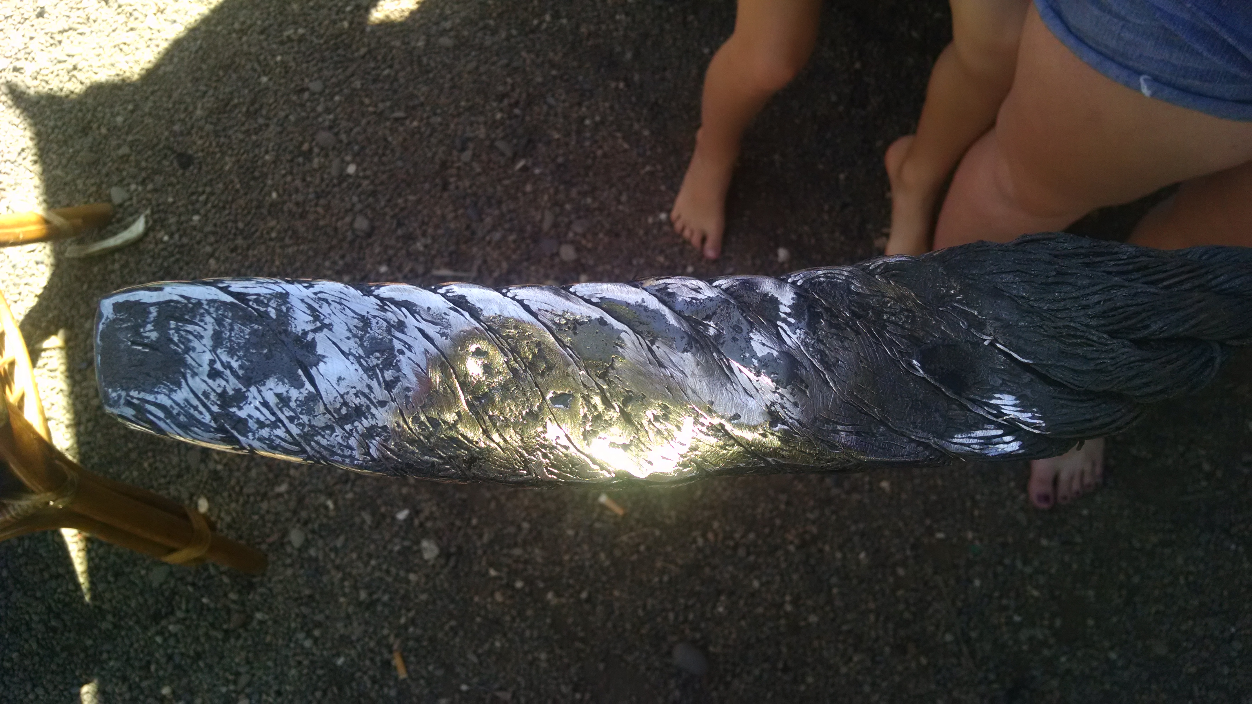

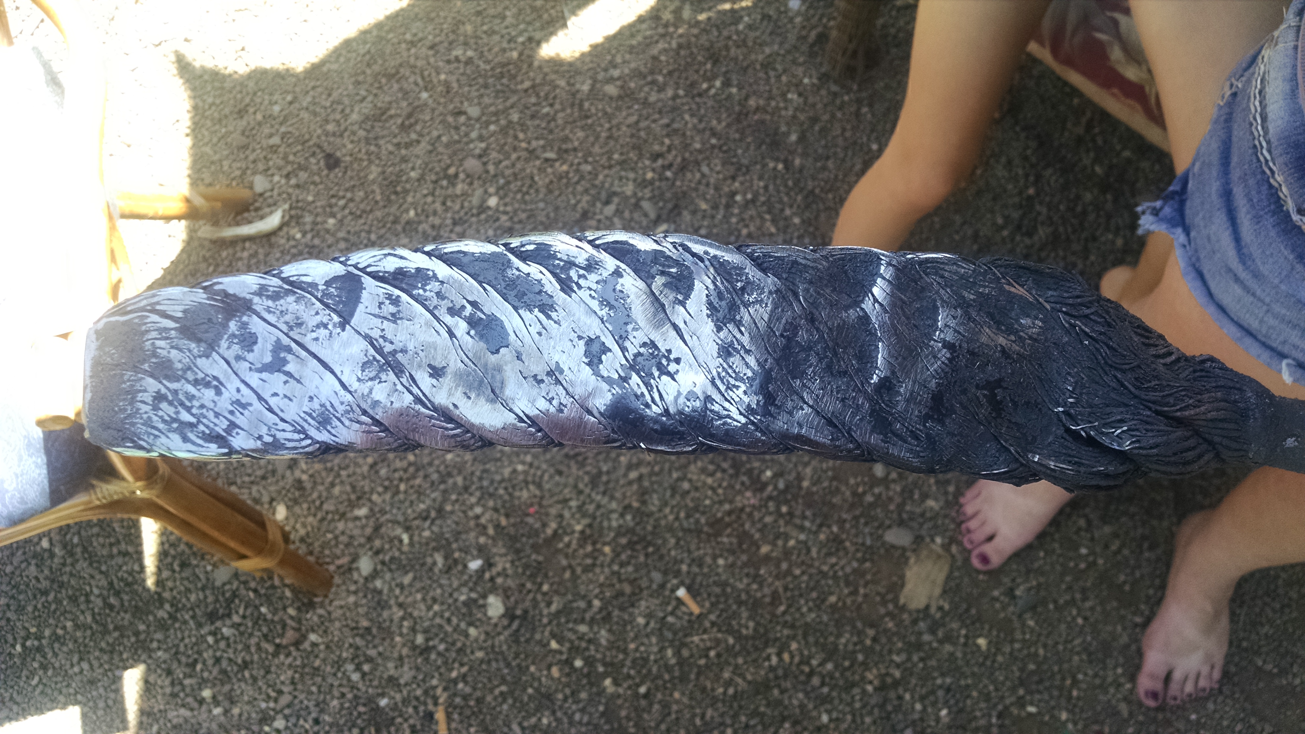

Hey all. This is my first attempt at forge welding. It was an old chocker cable and thanks to information on this and other sites I think it came pretty good. I made my forge using a frosty t burner .it took a while but I finally got it to 1960°  at 13 PSI. Any can't wait to start making a knife out of it . Thanks for all the great information .
Any advice from what you see. Did I hammer it too much ?
Thanks .
Really you want the billet to not show any signs it was a piece of cable unless you want a live edge spine.  Welding cable does take practice but it isn't hard.  You'll know how well you did when you grind the edge in and heat treat it.
Thanks . I don't think I had enough heat. I need to build another T Burner to add to the forge.

You can Consolidate the bar more and make it more like a billet that will take more heats and alot more hammering to draw the bar out. Unless you are using part of that barstock as a handle in that form and consolidate part of it as the blade.
I thought about cutting and folding it after I grind all the decarb off .
I've read that you begin to lose the detail of the cable if fold it .
The bar stock is not part of knife .  If  I shorten my forge I might be able to get to 2300 ° . I will need to remove the square stock handle and use my tongs

I have some band mill blade thats from a sawmill. It's 15n20 and ,072  . If I stack a couple of pieces in between and I can 2300° it might look pretty good.
Eventually after many folds it will become a homogenized bar, I did 2 such cut and folds or was it 3 and ended up with a wood grain type pattern in the cable. But yea the cable should be real clean to do it.
