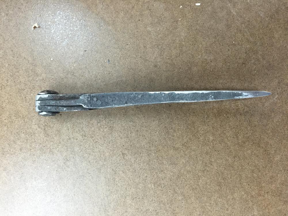

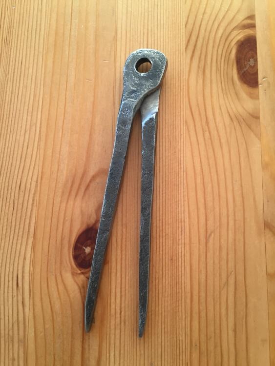

A couple months ago, I watched the Peter Ross video on making a wood worker's compass (divider).  This is my first pair. I made these for my neighbor and he will finish doing the filing work on them.  I thought they turned out really nice.  Also, this was my first attempt at fire welding and I was very pleased with how it turned out.  I plan on making many more pairs of these and getting good at making them.  One improvement I want to try is fire welding a carbon steel bit into the tip to begin with so the tip is more durable.
The one mistake I made was bending the hinge a little when I set the pin.  They still work just fine though.  This compass is about 6 inches long and my neighbor was thrilled to get them.  He spent some time showing me how he would use them to lay out a dove tail. I had no idea how useful they were.
Anyhow... super fun little project to hone your black smith super powers.

Nice work, Matthew. Funny I thought about the same thing a couple thousand miles away from you. I did it today, it's another style, not ready yet. I'm also thinking making one in this style, I watched the same video.

Those look really nice.  Thanks you for sharing. Please post a photo when you get them completed.  When I first thought about a compass, that is the pattern I first thought of, with a simple single hinge plate and identical halves.  I will probably make some like that as well.  A little easier to make and you can hot punch the hole.

I made this pair a few weeks ago. Needed a larger pair for a project. I must say I really enjoyed making them, good fun.
BreakDown, in the third pic is their a crack starting were it hinges and going down towards the end of the compass, or is it just some fire scale?
                                                                                         Littleblacksmith
Little,  the "crack" you are referring to is a forge weld seam.  Most of the weld took but a small part at the edge of the weld near the hinge didn't.
Handy to lay out distances on hot steel too.  With a little practice dividing a line or circle in even segments is fast and easy and a good "trick" for students.

That is a very nice compass.  How did you make the double hinge on the one half?  Also, how much of that is forged to finish, or did you do some filing work too?

The hinge way hot cut. I find I get more precision with the hot cut rather than a fireweld. I hand forged it right down to a fine finish then used the hand file on hot metal to get the finish.

Thanks. I can't remember where I saw this done first but I copied the idea from somewhere.

How long are those, and are you getting any flex?

Thank you. They are 20", there's no flex. I'd imagine you would be using them all the time in a sheetmetal shop.
