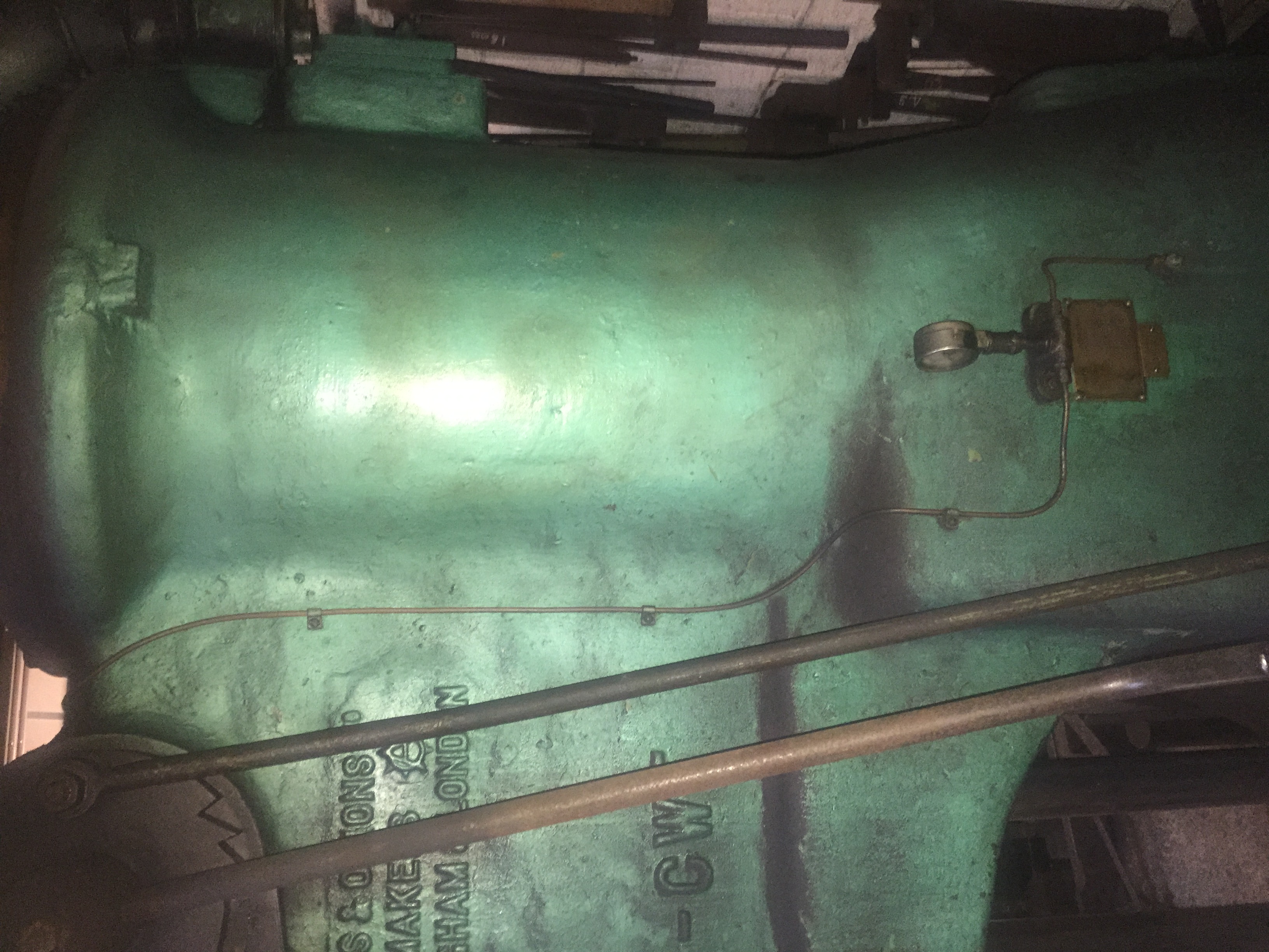

Herewith photos of the oil pipes.  The 3cwt has the automatic system, the pump delivers to the main bearings and the oil runs through the crankshaft to the big end and from there an oil pipe runs up the con rod to deliver to the little end. The other pipe from the pump goes through the casing an out to an oil pressure gauge and from there up to the rotary valve chest.

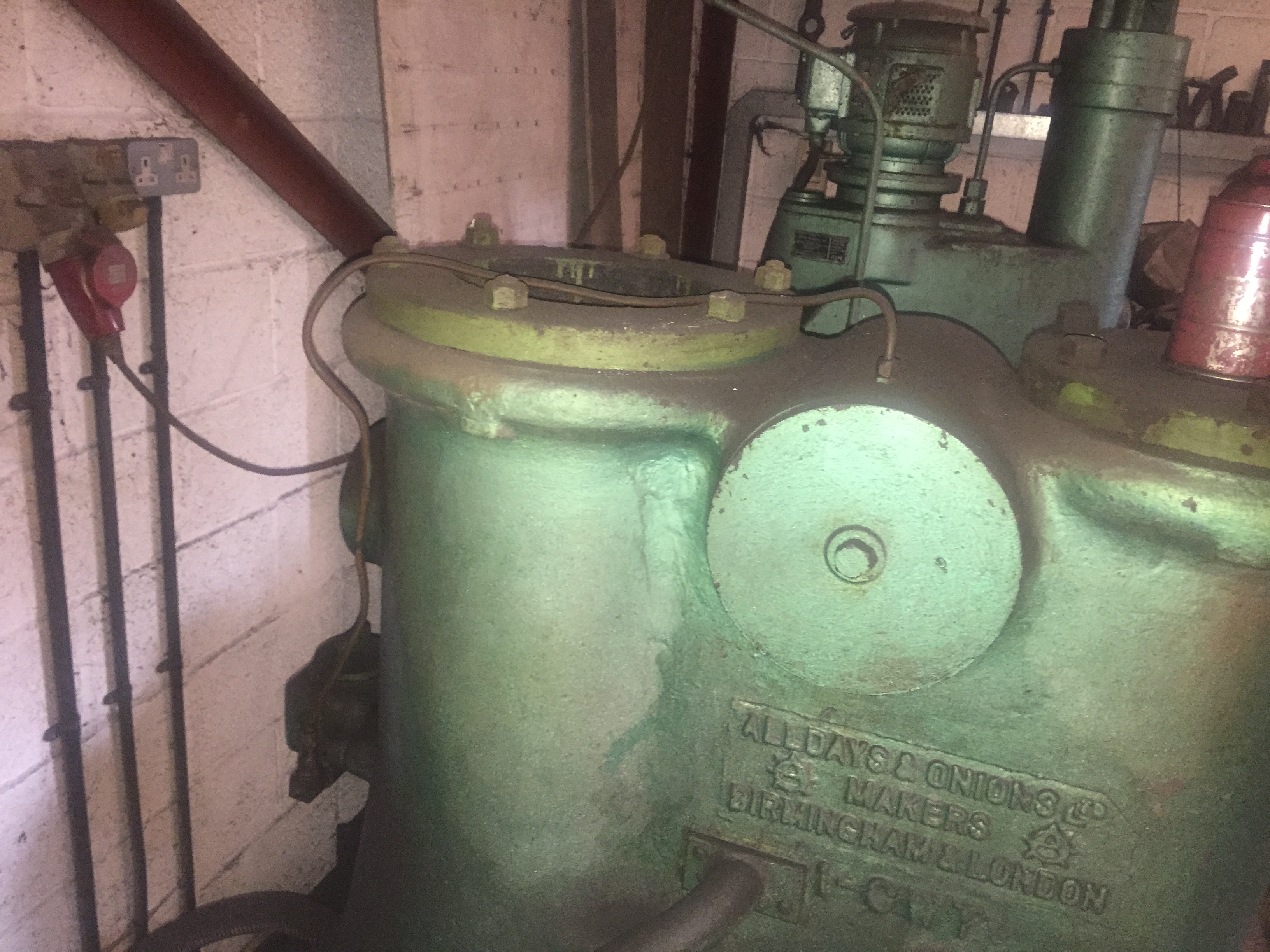

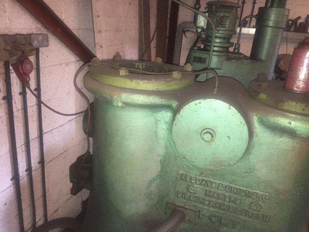

The 1cwt has a plunger pump on the back and an oil pipe goes up over the top to the same point on the rotary valve chest.
Have a careful look on yours at those connection points. Someone may have done the dirty trick they did on my 5cwt Massey when it was in storage. Nicked the copper pipe and smashed the glycerine sight glass.
Hope these help.
