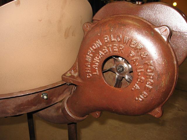

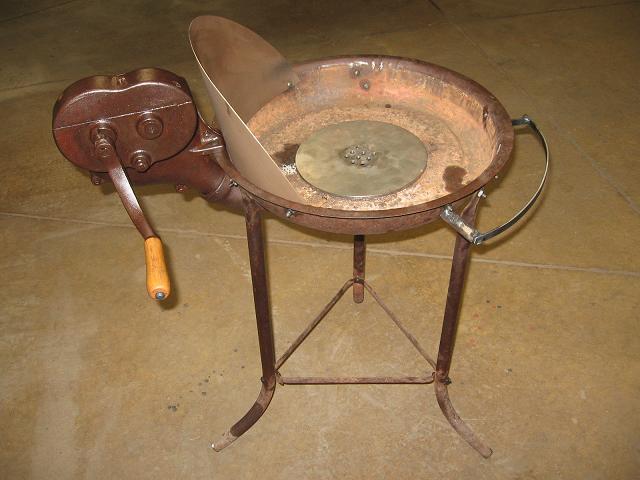

see below. I use this. Regularly too. I would consider buying another or just the blower and mount it on a home built forge (for a deeper fire pot) It is super sweet.
THis is hands down the best I have used. It is way far better than a 400 unless.......................you have replaced every bearing race inside the 400. The 400 is simply too noisy with pitted races. I have a nice 400 that is quiet. The only one I have ever encountered. They are not the best, though the advertising tells us otherwise.
The Champion #1 is an awfully nice blower. I have use one. But never had opportunity to dismantle one to see it's innards. The one I used was smooth as butter.
The ones with a bunch of ball bearings just don't work well unless the bearings are super clean i.e. no pits or grooves. I have used a Buffalo 201 and it was quite noisy too.
The $120.00 Champion blower that I can buy looks like the one in your picture, except that it does not have the tabs to be able to connect to the fire pan, I stands alone. It is very noisy and loose. It was my first choice.
