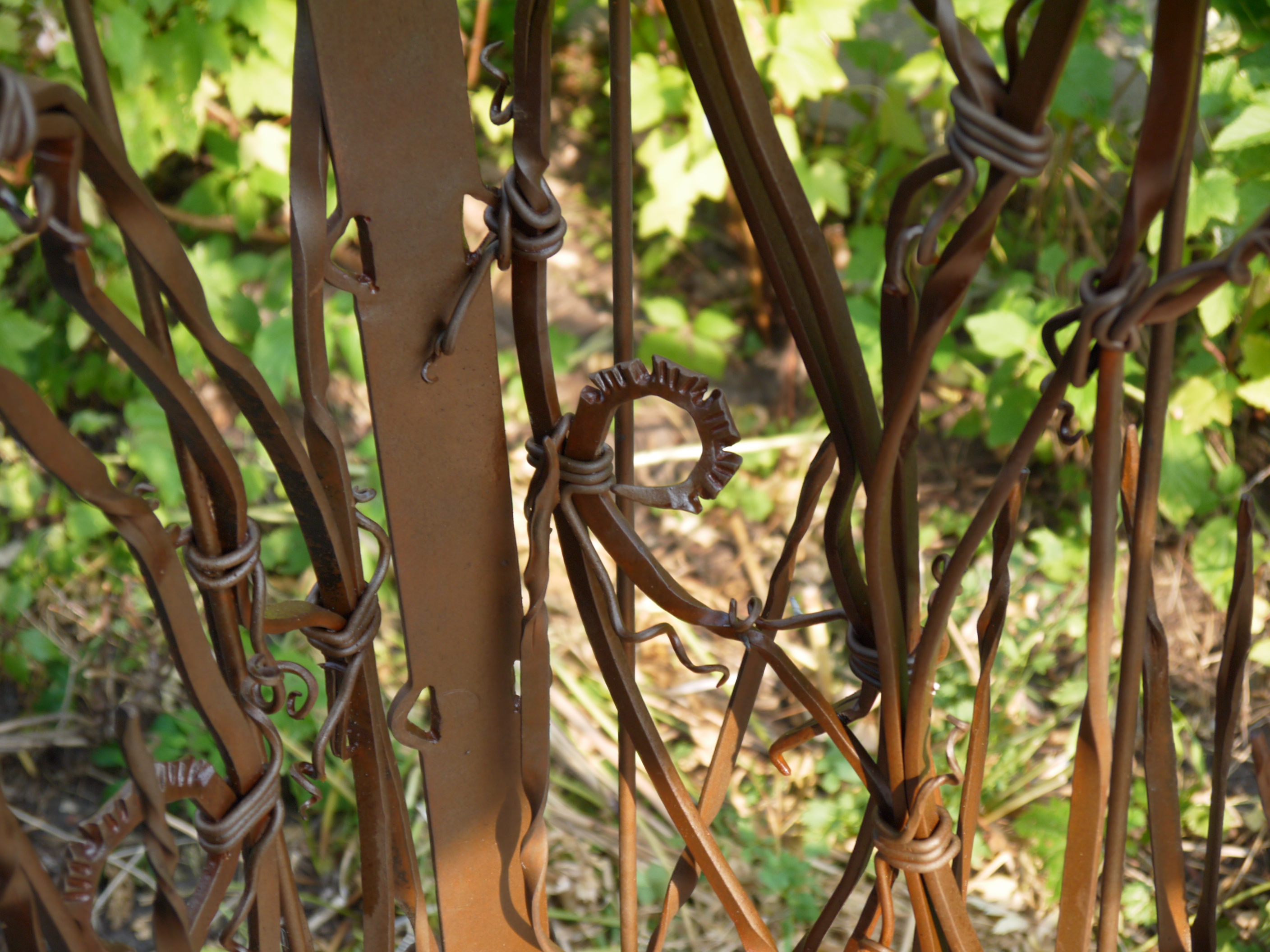

yves Posted September 10, 2015 Share Posted September 10, 2015 It was an important commission for me, my first big one. I was lucky to have a client who dared choose this design. On installation day, I was also commissioned to forge a replacement for the wooden columns. View from the east.In the sweet morning light.A view from one stair.A view from the other stair.Details.Details will be added : herbs will come out of the hand rails. Quote Link to comment Share on other sites More sharing options...

ThomasPowers Posted September 10, 2015 Share Posted September 10, 2015 That is a piece worthy of a *LARGE* check at completion; I did think the scroll work areas look a bit odd---perhaps a few "tendrils" reaching into it and twining around a few pieces to "bring it in" to the "burgeoning nature" look? I'm sure you should receive more such commissions! (a coworker walked past my cube, stopped and said---"that's beautiful!") Quote Link to comment Share on other sites More sharing options...
yves Posted September 10, 2015 Author Share Posted September 10, 2015 Thomas,I thank you for the compliments and happy to get them. I realy comitted myself in this ... commission.The client supplied a picture of the scroll work. It is a classic type (often seen) of scroll work in France. This one was from a window hand rail. I was not interested in forging this type of work around that balcony. I told the client and she asked me to come up with a proposition. I did, she bought it but she wanted the scroll work and the herbs. So I did try to link the two by making it look like an invasion of the tendrilled herbs, like the garden had been cleaned and these bits and pieces remained. The client was happy enough that on installation day I got the commission to forge braces (I believe this is the word) to replace the (cheap) existing wooden columns. This ought to be easier ... or not ...Thanks again. Quote Link to comment Share on other sites More sharing options...
