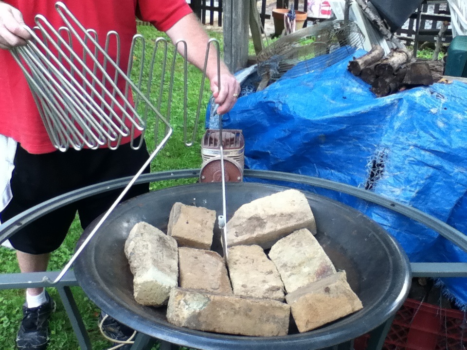

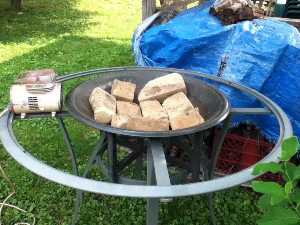

Here's my forge. Just need to attach a pipe to the blower

What are we looking at here?  I know the admins think it's a gas forge, but you said blower, and it looks more like a workable base for a side blast forge (just needs some creative trimming and a lot of clay/sand/dirt/something), but it's missing the tuyere.  I can't figure out what the...refrigerator coil?...is for.
Its a charcoal forge. The coils are from a sofa machine so they're ideal to get the air from the blower to the embers.

Looks more like a compressor than a blower to me. If coils are copper may not hold up to forging temperatures. Will be an interesting experiment.
I meant soda fountain. The coils are stainless steel, and have a slight hole for water. So I can use it for air transport. And it is deffinenty a blower

On my side blast I'm using 3/4 pipe for the air, I know you're enthusiastic but I don't think she's gonna work.

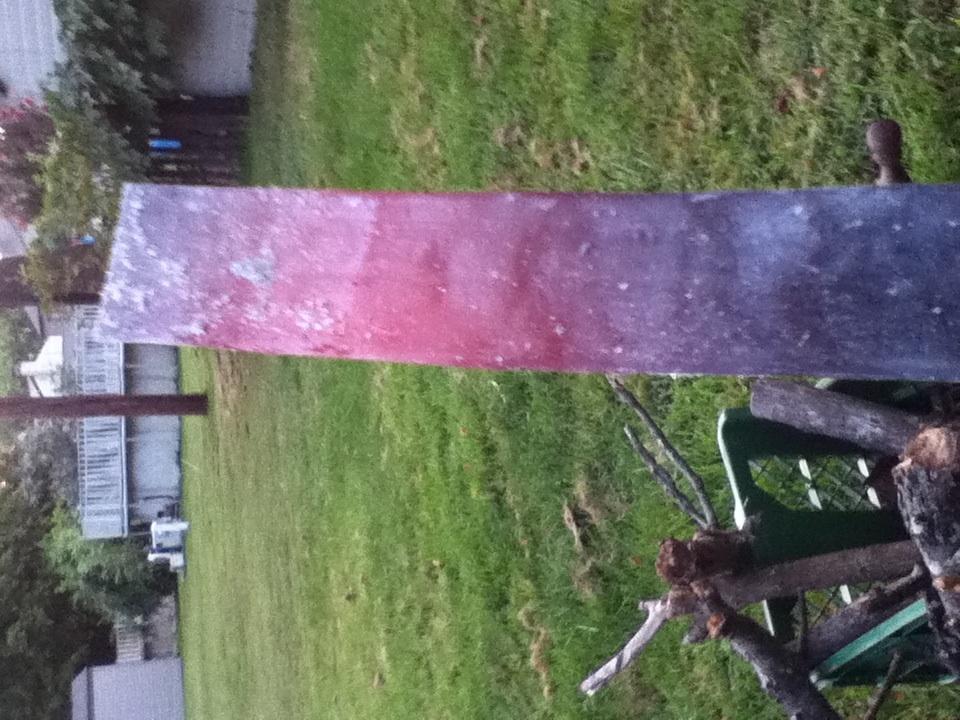

I know I'm not very knowledgeable about this but I think it will work. I got this aluminum pipe red hot with out a blower

So well, you're hitting about 975F, but you've got to double that for most steel. Aluminum also conducts heat differently. If you want to forge steel we're looking for 1600-2100F just to be safe, and even then you'll want more for welding.
J
Keep in mind a "black" heat on steel is still about 1000 deg, so you haven't even got any color in steel at that point yet.
