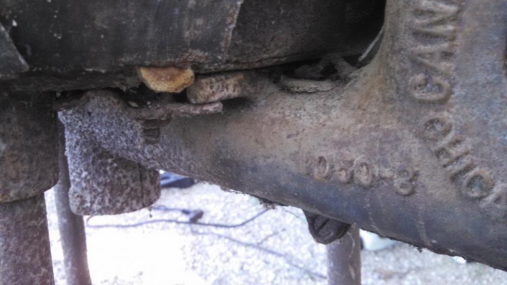

I recently picked up an old rivet forge made by Canedy - Otto Mfg Co, usually known for their drill presses and larger blowers. I don't have a lot of info so I hope some of y'all might be able to help.
Well I went to work restoring/refurbishing it as well as making upgrade like repairs in the prossess.
IMG_20150729_160335_141.thumb.jpg.a5363fIMG_20150729_160341_390.thumb.jpg.77b615

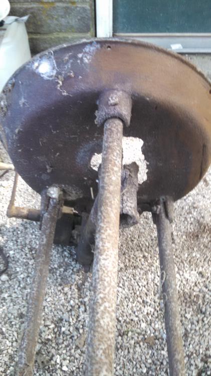

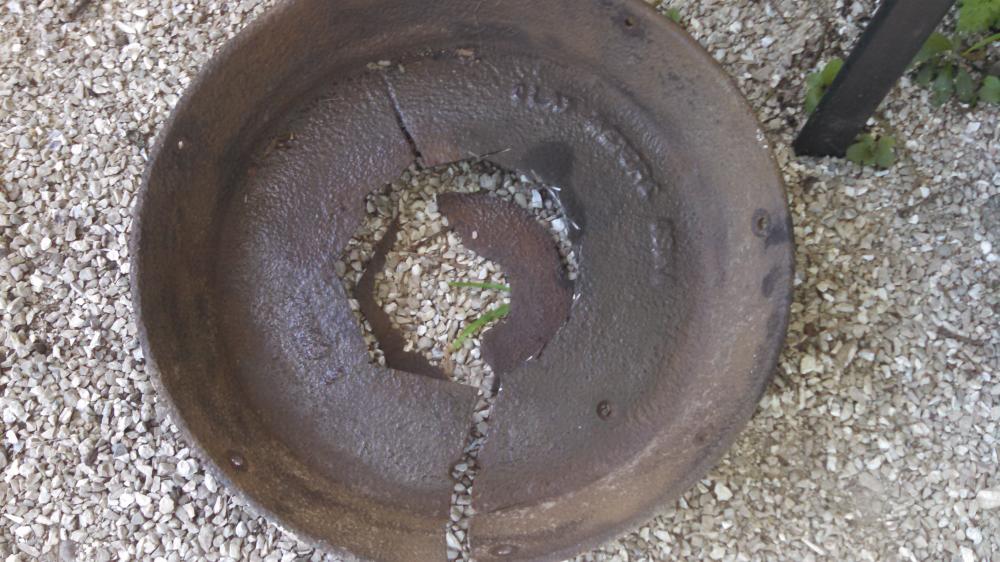

Here are some pictures of the forge as I got it. The blower does turn but its not smooth and I worry that with every turn it could break a tooth. It's definitely not clean or lubed. Inside the forge is a brake rotor and tongs. The rotor will come into play later.
IMG_20150729_161956_857.thumb.jpg.42e635IMG_20150729_162002_262.thumb.jpg.7d5222IMG_20150729_162009_502.thumb.jpg.0c3464
As you can see, its been neglected for quite a while. We'll start with disassembly and wire brushing.

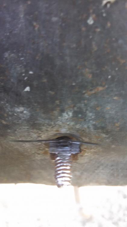

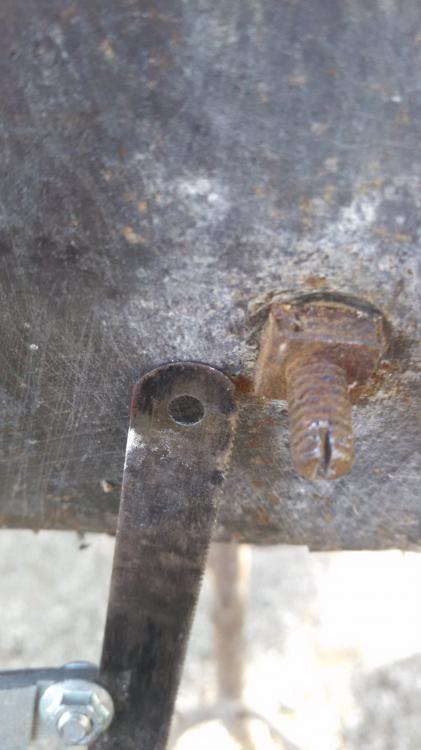

It all started off easy, but then there was one stubborn bolt.IMG_20150729_162551_078.thumb.jpg.d46ad9
I cleaned out and cut the slotted head, but it broke one of my flat head bits.
IMG_20150729_163317_553.thumb.jpg.e8cfbb
So I cut into the back of the bolt, still to no avail.
IMG_20150729_164332_973.thumb.jpg.fde6cb
So finally I cut it off with the angle grinder.
IMG_20150729_164710_208.thumb.jpg.2aec0a

I cut a layer off the rotor so it'd sit more flush to the bottom if the pot. I also cut the pot to fit the rotor. It is so cracked and decayed that I don't feel bad about cutting it to make room.
