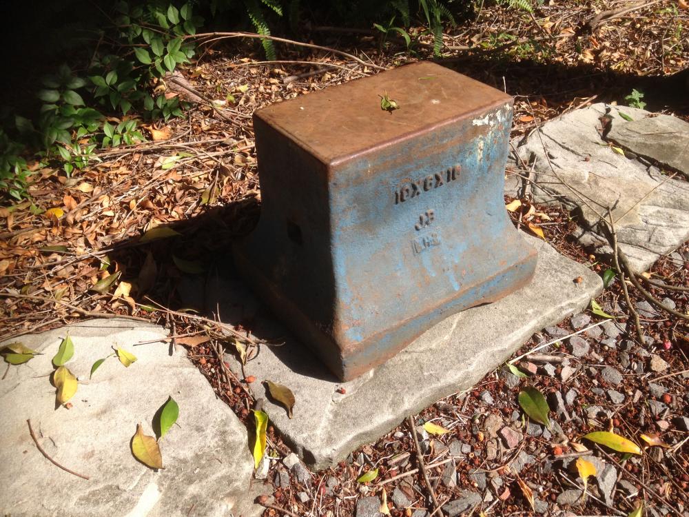

Great score glad to see it went to someone who appreciate them, now all you need is this.
