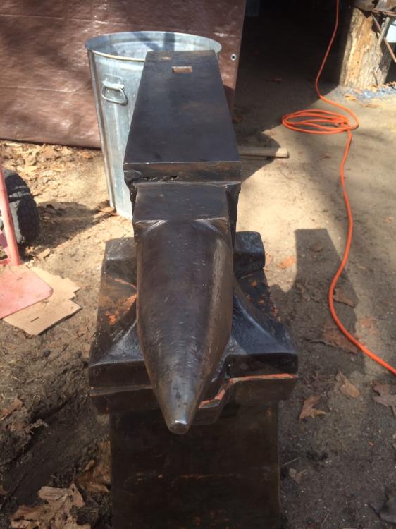

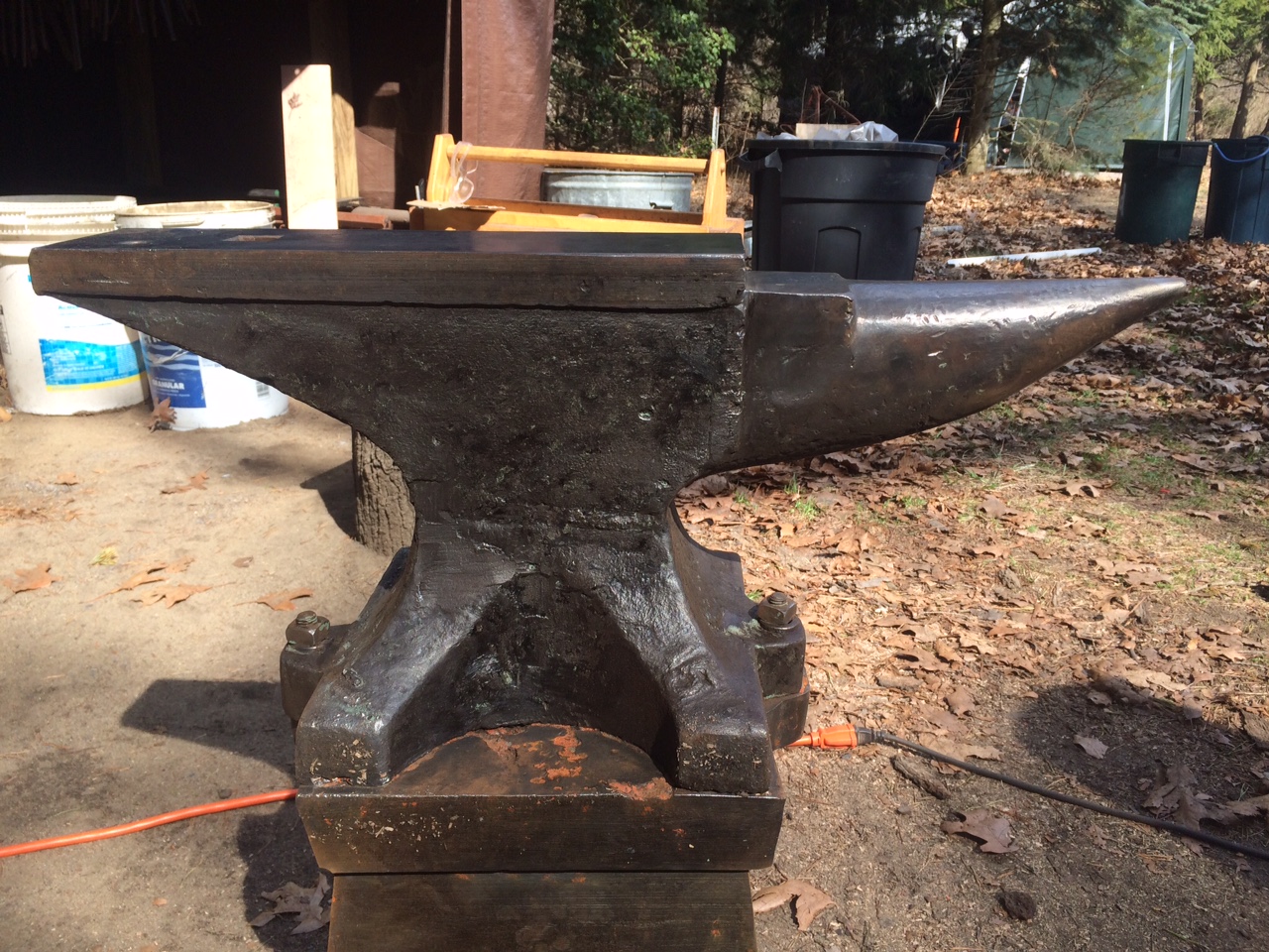

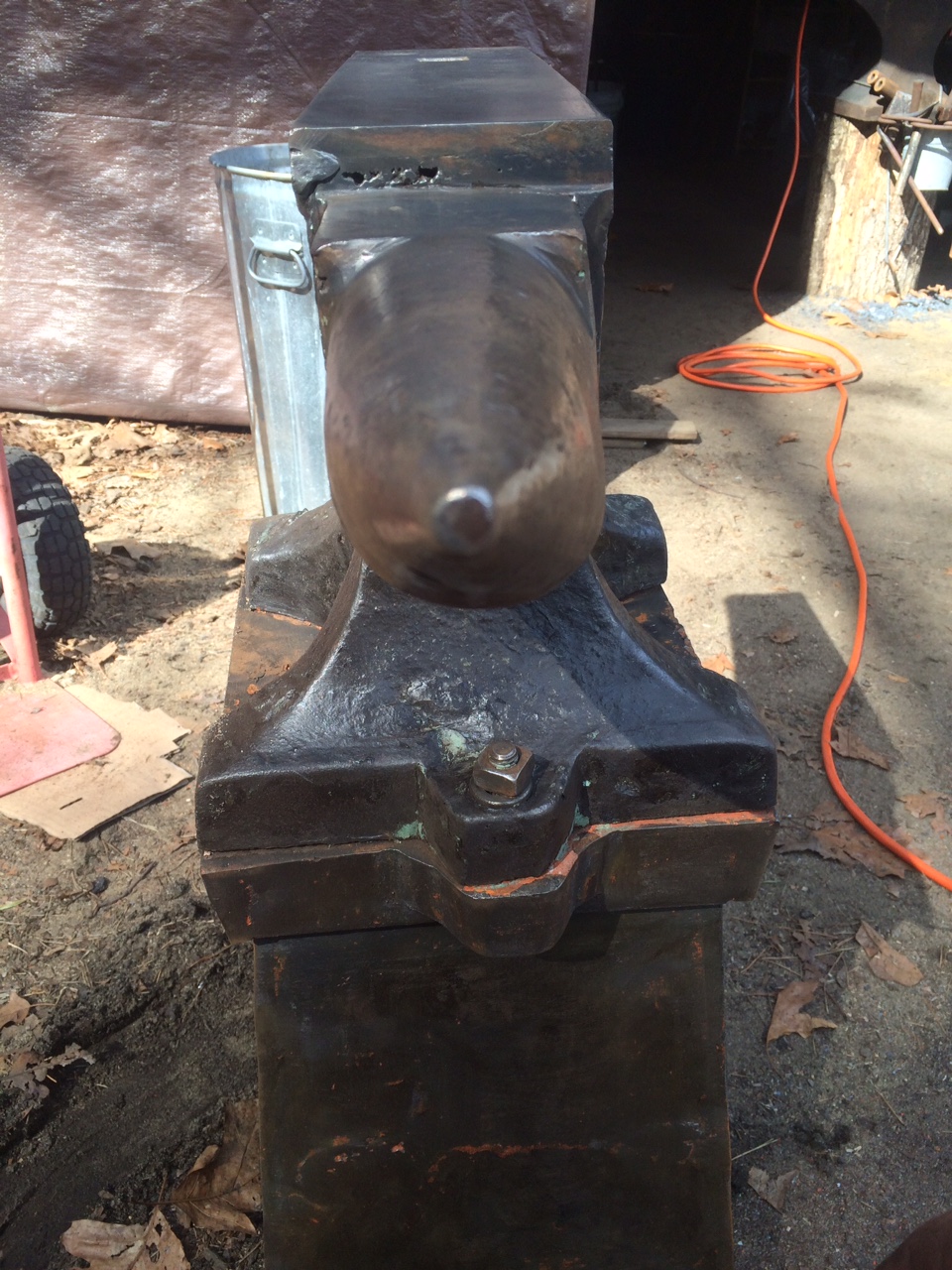

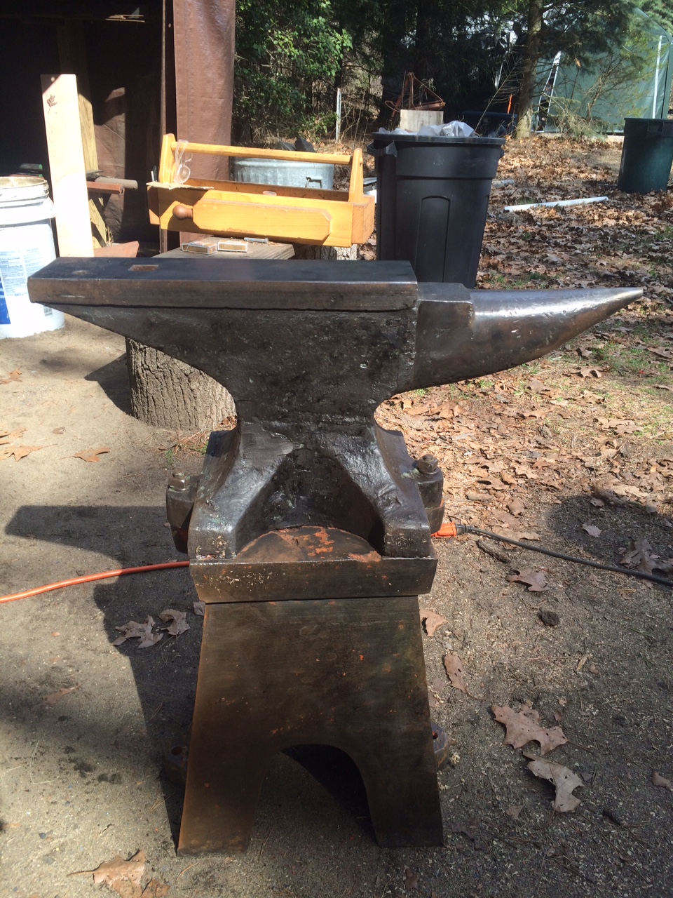

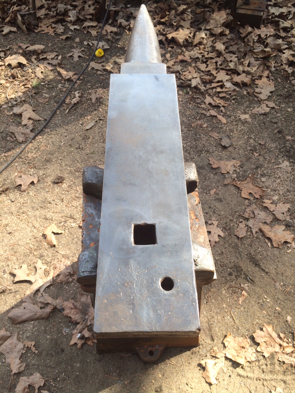

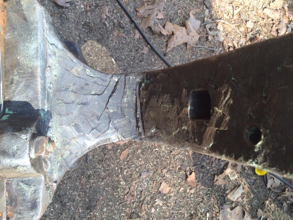

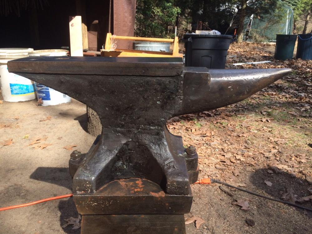

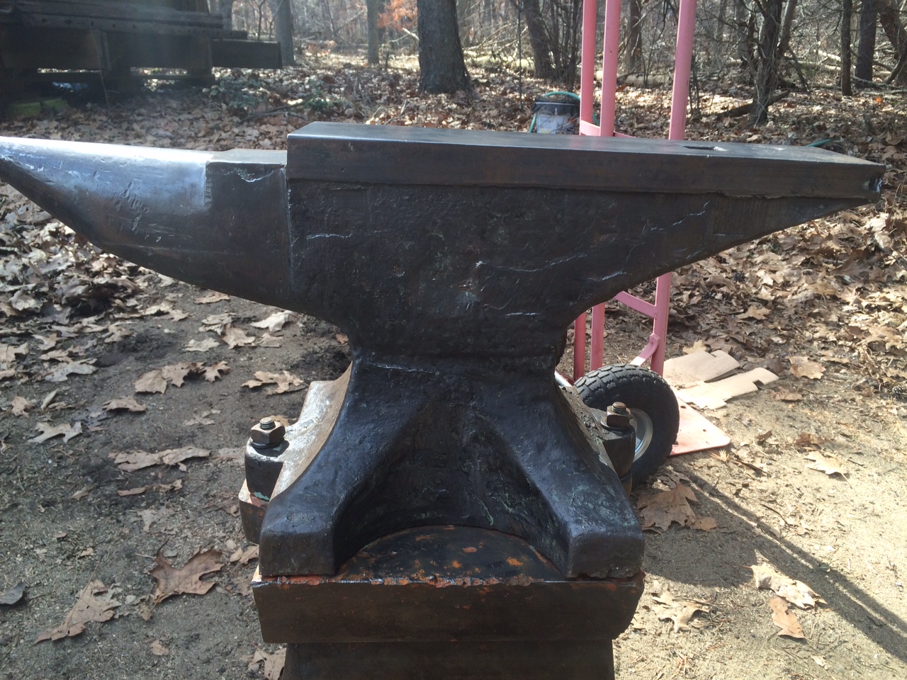

I got this because of the stand and a decent asking price. Both the anvil and stand were covered in paint which gave it a nice look but i wanted to see what I had bought. I'm not really up on Fisher history but I do recall reading that the later Fishers could be pretty rough...my Fisher appears to have been made with a putty knife. The rebound is great over the entire face with the normal drop out on the heal. The corners/edges are about as clean as they can be so there's no question of it's useability. The only stamp I've found is the weight stamp on the foot. I figured someone out there might like seeing how ugly a really nice anvil can be.
Nice old fisher and the stand great too.They have a good thick harden plate face what`s the rebound like?
I didn't bother with getting out a ruler but I'd say 90% or better over everything in front of the hardy.
Why do you say this is a Fisher? It doesn't look like any Fisher I have ever seen. The lack of the logo on the side would make me suspicious. Mine is tough to see, but it is there.

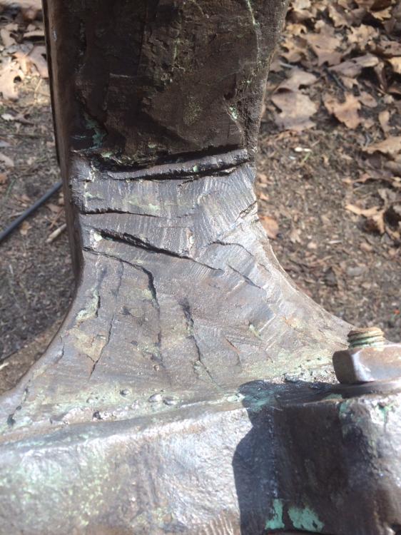

Yes, it is a FISHER anvil.  Probably made in the 1962 to 1979 era of production by Crossley Machine, still in Trenton, NJ.  The "putty knife" marks are from an air chisel that was used to clean up and remove extra iron from a bad casting.  They chiseled off excess metal from under the heel and a bit on the side face, then did minimal grinding to smooth it out slightly.
The lack of FISHER and the logo is common on Fisher anvils from this era.  Most of the moldmakers were former Fisher employees, but Crossley was very concerned with costs, and cut out some steps to save even minutes or seconds.  The stand is also a Fisher/Crossley product, but it is not marked as earlier stands were.  Again a step to save seconds in production time.

Gorgeous anvil and stand.  I've really like to get my hands on a heavy stand like that.

I was guessing that the "putty knife" marks were from someone fixing a bad mold. Never would've guessed they were from post pour clean up. I saw (your) the Fisher display at ABANA and I was aware that they could be rough. At first I was a little disappointed with how rough it is. Then I saw how good the rebound is so I started to think of it as, Beauty and the Beast.
I haven't weighed anything so I can't say how much the stand weighs. I'm guessing it's around 50-75lbs as the pair feel a little heavier to move than my 198lb anvil.
