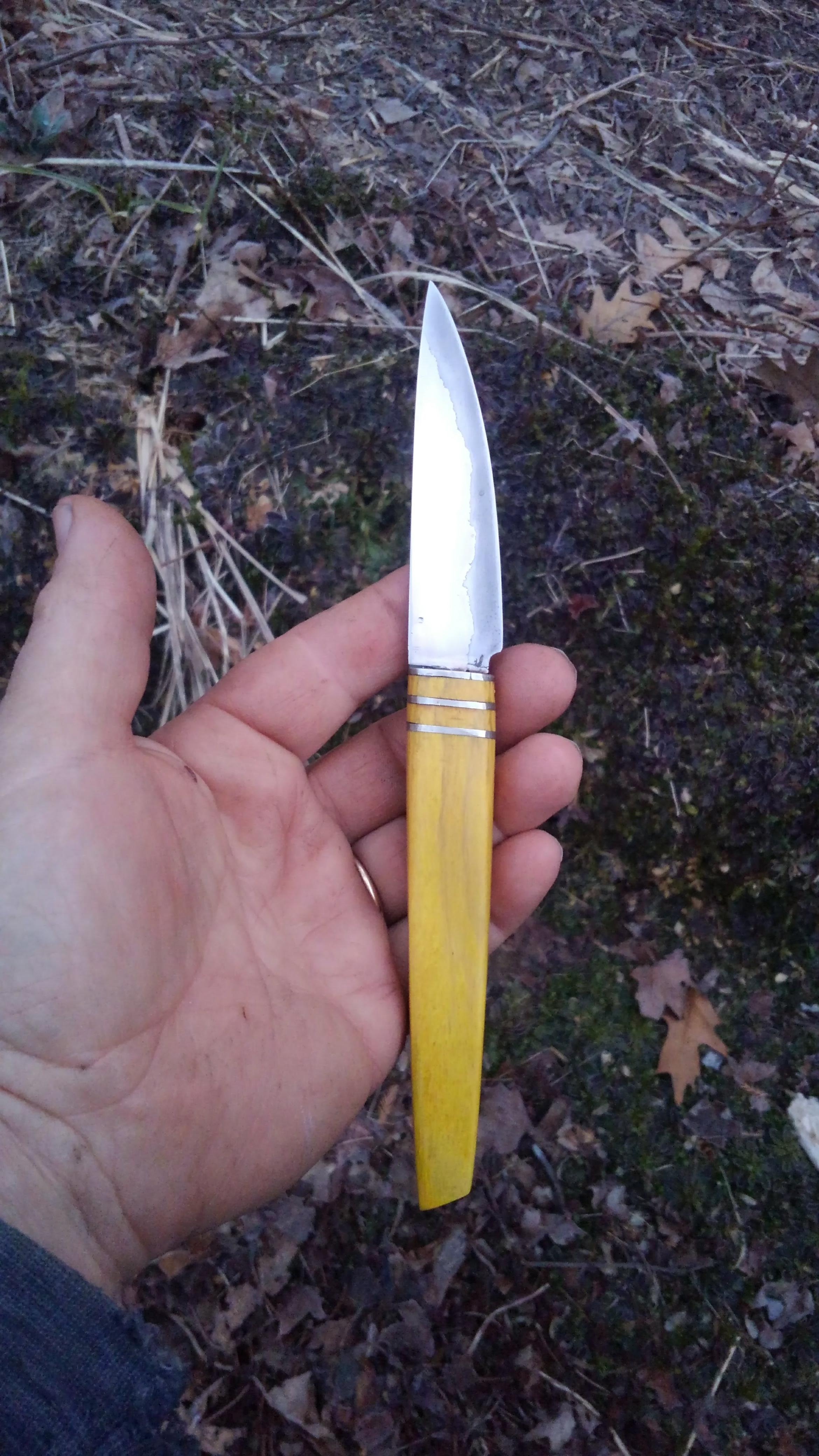

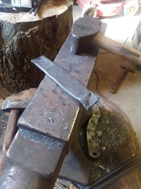

Still newbing around but this one stands out as a proud minute because it was the first success I had sticking stainless to 1095. The first attempt never took so  tried enclosing the whole sandwich in a thin wall tube with the ends welded shut and got it to stick in that O2 free environment.  It was exciting to pry it out of the wrapper and see that it welded. Small victories.
Osage orange w/nickel spacers
