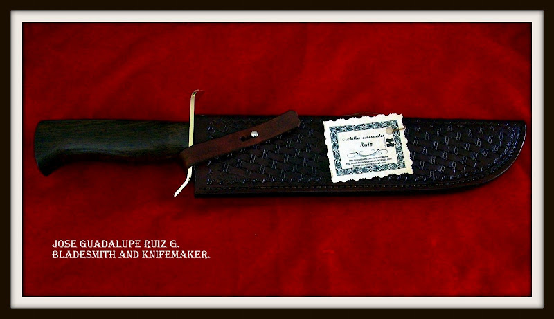

Hi every one!
At this time I want share with you my last one frontier bowie knife. It is on recuest knife for a good client.
- OAL: 39 cms.
- Handle material: cocobolo wood.
- S guard: hot forge brass
- Steel blade: O1
- Blade length: 27 cms
- Blade heigth: 5 cms
- Blade thickness: 5 mm
- Hardness: 57 Rc
- Leather sheath
- Diderential quench.

I love the knife, cocobolo is my favorite hardwood. What temperature can you hot forge brass at?
Jayson, The Complete Bladesmith: Forging Your Way To Perfection by Jim Hrisoulas has a wonderful chapter on sheath making. It's also just a fantastic book to own.

well about the sheath there is a lot of tuturial on the web; and here you can learn the basic use for some leather tools http://www.youtube.com/user/TandyLeatherFactory/videos.
The book about is talking TheoRockNazz is really a good book try to get it.

I love the knife, cocobolo is my favorite hardwood. What temperature can you hot forge brass at? Jayson, The Complete Bladesmith: Forging Your Way To Perfection by Jim Hrisoulas has a wonderful chapter on sheath making. It's also just a fantastic book to own.
The cocobolo wood is one of my favorite woods too. well about the forging brass I just put it in my press hot it with my acetylene torch to a red color and bend it.
