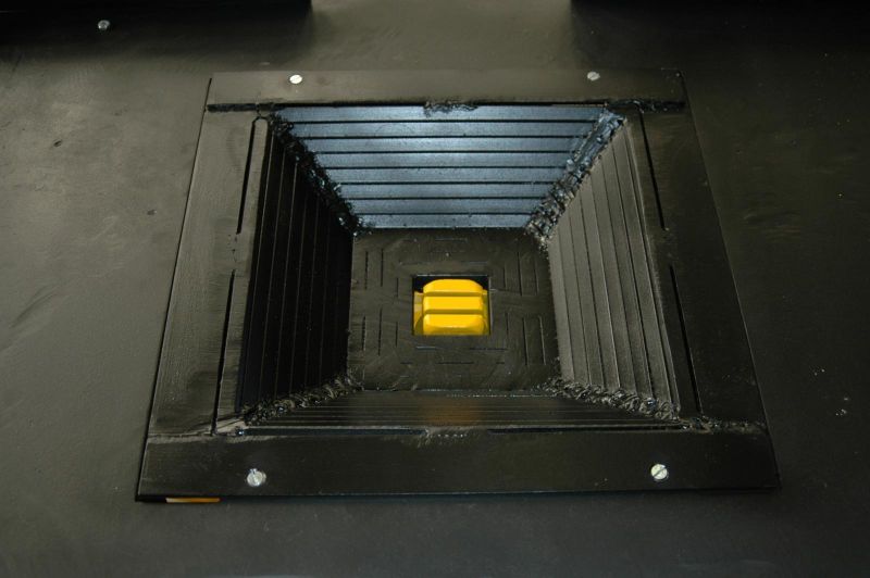

Here are some pics showing one in use
post-816-0-37804800-1317226010_thumb.jpg post-816-0-09104200-1317226122_thumb.jpg post-816-0-98689100-1317226160_thumb.jpg

I'm using coal in my forge I just thought I would keep a hot fire longer if the pot was deeper. To me I seem to go through a lot of coal when I'm working and yes I do try and control my air blast to only as needed. I also wet my coal every few minues to help me control my fire, but through other post just thought I needed a deeper pot. Even though I do use a rivit forge every blue moon that has no pot at all.
Jacques
That pot looks great in fact I may try and copy your design, I really like that. I see that you have it screwed down though, my pot now is a drop in and not fastened down for possable heat expectation, I'm guessing that is not a problem for you?

Will I finely found 2 - 5 foot lengths of 5" x 5" x 1/4" angle iron that I cut up to make my new fire pot. This time I made it about 4 1/2 inchs deep and 9 inchs square at the top and 5 inches at the bottom. I even put in a clincker breaker which the other one did not have (didnt know about such of an animal when I first started). After all is said and done the new fire pot works great and the difference is really great nice. Did not use near as much coal as I have in the past and kept a good hot fire going. Wish I had done it long time ago.
