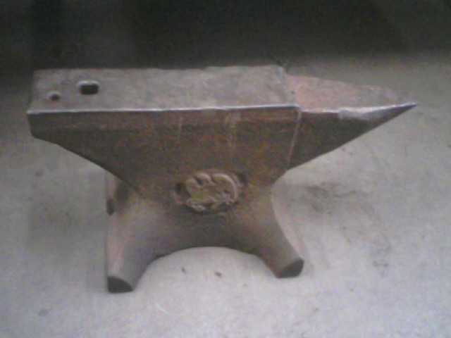

Sorry I can't help you but I came across an anvil with the name FISHER on it and on the side it has an eagle. I weighs in the 100# range, can anyone tell me anything about this type of anvil?
I dont want to go out on a limb here but I think that must be a Fisher anvil, lots of info on here about them
If it looks like this>
Then Its a fisher-norris eagle anvil, If I'm correct it has a cast iron body welded to a forged horn and tool steel face.
A picture of your anvil will help identify when if was made, and condition. If you post a photo, I can tell you a lot about it.
Yep, 'cept for the part about a forged horn.
