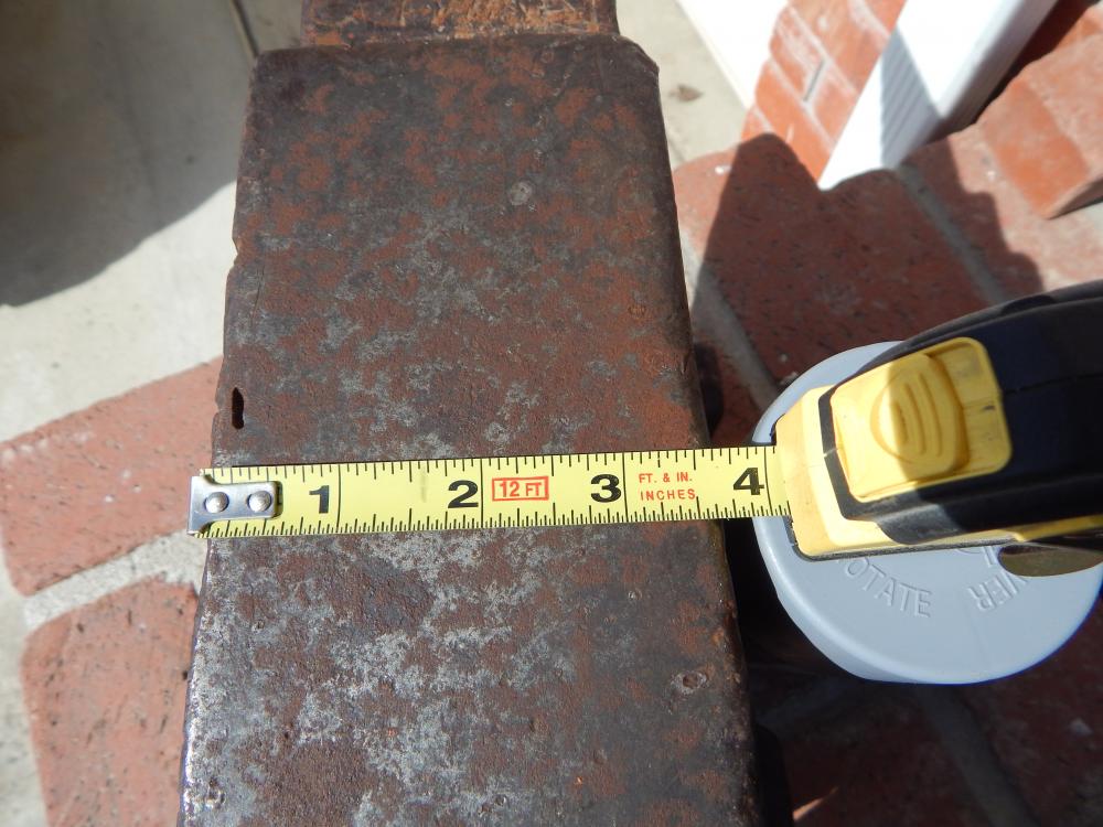

  12. I cannot find anything on this old anvil and I'd like to ask some of the fellas & ladies on here if they can help. All I can find after wire brushing and flour coating it is the numbers 11 and 22 under the base. It's a good anvil, great ring and rebound. Any help would be appreciated.

  14. This was one of my favorite projects last winter. It's truly a good thing I don't do this for a living, I'd starve due to how slow I go at getting everything just right. There's sure a lot of talent on this forum, I love to see the younger ones getting into this craft too.
