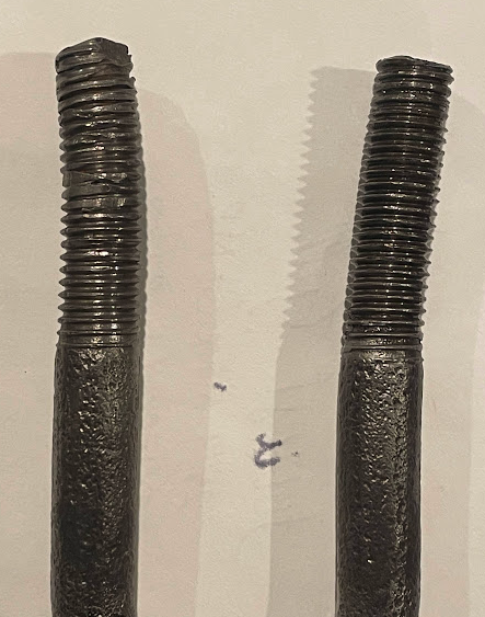

    Thank you, ILikeShinySteel! I think that using nuts to protect the threads during the "heating and straightening" process is a fantastic idea! I have acquired the proper nuts. I'm able to thread 5 nuts on the "healthy" leg of the u bolt and only 2 nuts on the "unhealthy" leg of the u bolt. This is quite a process and I am doing so many things for the first time in my life. I have also enjoyed reading your posts about refurbishing your vise in Australia and I have made note of your insightful use of penetrol! Thank you so much for sharing!

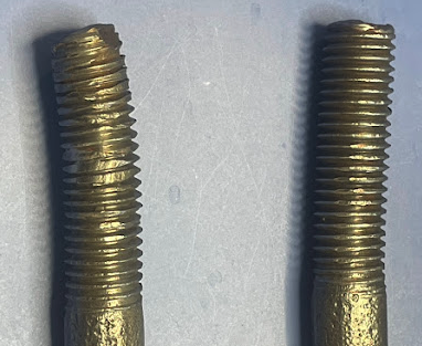

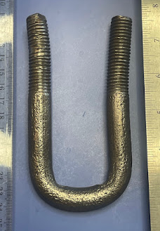

    THANKS EVERYONE FOR ALL THE HELP!! I have been SLOWLY making progress!! And I am THRILLED to report that the threads on the U bolt are looking FABULOUS!!!!!! Over the course of the last few days I have acquired my very first tap and die set. Through unpredictable circumstances I had the opportunity to spend more than I planned on an Irwin/Hanson tap and die set and so I did. While it was a lot of money for me, I paid about 1/3 of retail. And, as we all know, good quality usually costs a lot. So, here we are. So, AFTER I acquired the t&d, I still didn't wanna cut a bunch of metal off the threads. So, I ACCIDENTALLY DISCOVERED, that our good friends at AutoZone would loan me a Thread Chaser/Restorer Set for FREE! You pay a full price deposit and then that is refunded to you when you return the thread set! Amazing!! That set was SO HELPFUL! Not in the obvious sense. BUT, in the sense that, while the thread file and thread bolts WERE helpful, what they MOSTLY helped me determine that I had NO CHOICE but to use the Irwin T&D set to cut the threads and hope it came out. So, that's what I did and it took A LOT of work. But, I coated the parts lightly with cutting oil and went slowly and just worked my way down back and forth and back and forth like I saw in a youtube video on "how to use a tap and die set if you're 51 and have no idea what you are doing" (nailed it!) Anyway, more to come as one leg of the U bolt accepts the repaired nuts just fine but the leg of the U bolt that has a sharper turn towards the tip will NOT accept the original bolts as they are too deep and won't make the bend without re-folding the threads again. So, now I need to brainstorm how I can gently straighten that 1 leg of the U bolt just enough to allow the nut to thread on. On the other leg of the U bolt the nuts thread on like a song with only 1 finger! It's so smooth now! Yahoo!!! I'm trying to attach pictures that show just 1 leg repaired and then both legs of the U bolt repaired. I sure hope this information is helpful to someone else in the future. That would just be awesome! I don't know how obvious it is, but, one of those photos shows 1 leg repaired and the left side still mangled. Then, the other photo shows the threads on BOTH legs looking SPECTACULAR!!!! Now, I just need to repair that bent tip on the one leg..............tbc

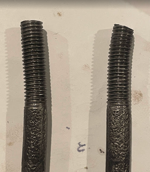

    Y'all are just too cool. Thank you all so much for the gracious replies! 1. George N.M., thanks for the warm welcome from balmy Wyoming! I have many dumb questions and I plan to ask them all! Yahoo! 2. JHCC, I do not have access to an oxy torch yet. That might come in 2027. But, I've seen enough videos to understand the method you are referring to and the drawing you supplied is spot on. I very much appreciate the visual reference! Thanks also for the various thread repair with file suggestions. I'll need to wait until next weekend to take a crack at the threads. I think I'd like to see if I can make some progress with a thread repair file. But, need to acquire that item first. I have a tap and die set but I don't want to remove too much material when repairing the threads. At least, my goal is to remove minimal material to regain function. One step at a time! (ps, I have accessed the "Frosty T Burner Build" and I'm looking in to building that in February, maybe, but I digress. It's not an oxy torch. But, just a baby step in that direction. Another shout out to Frosty, for generously sharing his expertise in that regard as well.) 3. Swedefiddle, agreed! I may need to go the route of a brand new u bolt. Presently, I'm romantically tied to the idea of using the original. But, time will tell. 4. ILikeShinySteel, I love the idea of using penetrol and had never considered that before! Us people that live in humid climates totally understand the constant and relentless nature of rust! I am adding that to the short list of potential protective coatings. Your vise looks fantastic!! 5. Mike BR, I REALLY appreciate this suggestion as that thought had never occurred to me. I'm now going to dry fit the vise and give it a thorough examination to try and figure out why both of those u bolt legs got bent in the first place. Especially since there really isn't any reason for them to be bent. It's a bit odd, for sure. 6. JHCC, so true. Beware the temporary that "works for now......"

    The threads on the U-bolt are pretty messed up and then also each shaft of the U-bolt is bent. I'd like to do the best I can to restore the threads and straighten the U-bolt shafts prior to putting it all back together. I have never done anything like this. Any ideas/suggestions that you may have would be greatly appreciated! If more pictures are needed, I can do that to! Thanks!

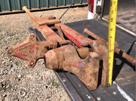

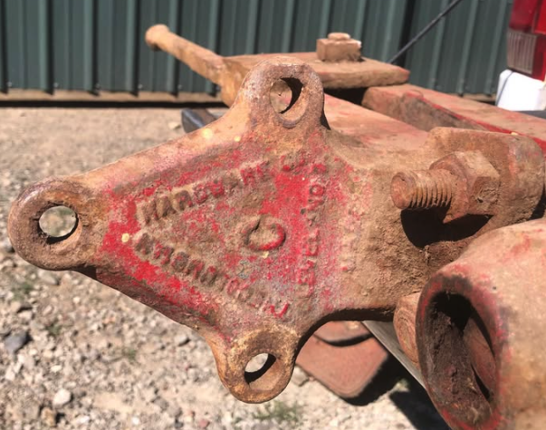

    Thanks for the kind welcome, FrostyFromAlaska! Having a name like Frosty is ALWAYS an adventure! As for what I am making, I'm currently, for the very first time, restoring/refurbishing a Columbian Post Vise precisely like the one pictured above! The jaws on my vise are 5 1/2 inches, the top looks EXACTLY like what is in the picture. And the bottom is stamped with the number "20". It's quite the undertaking and also a privilege. I'm about 2 weeks in to the restoration and focused on taking it one step at a time and learning a lot along the way! The world of vises and steel and ALL these things is brand new to me and I'm grateful to be here and be exploring. I wish, perhaps, I would have discovered this world maybe 15 years ago before prices exploded. But, it is what it is. I'm here now. (the attached photos are of how the vise looked when I bought it)
