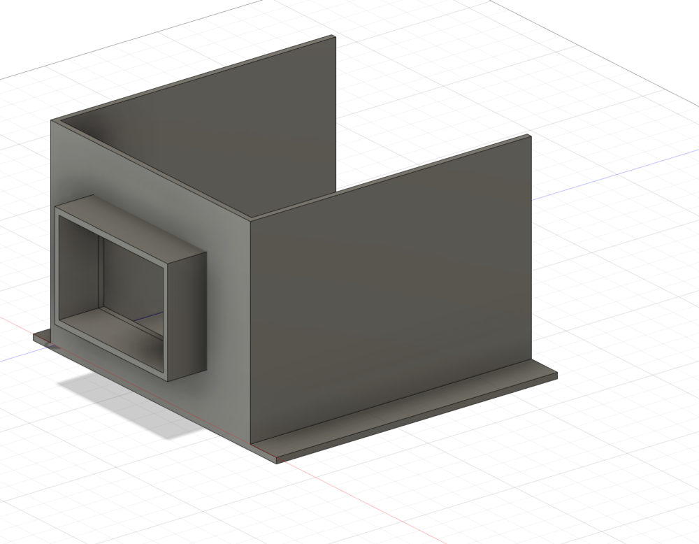

  12. Jake18 replied to Mikey98118's topic in Gas Forges
    About to start building another forge, what do y’all think of this design? still deciding on what burners to use and the spacing of them along the length. I’ll probably also add slots near the bottom to slide in a kiln shelf. The less colorful image is it drawn to scale with each square equaling 1/2 inch

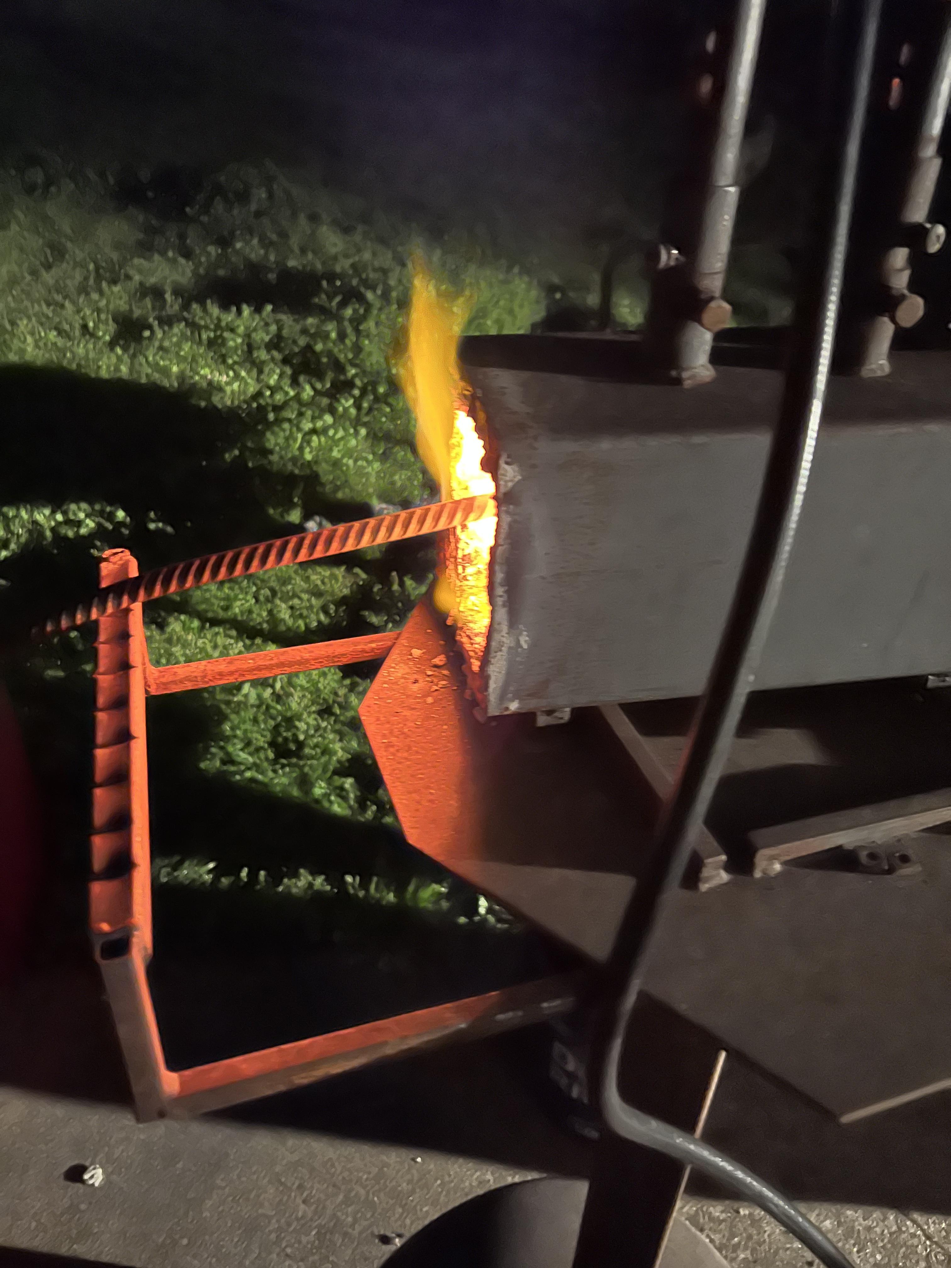

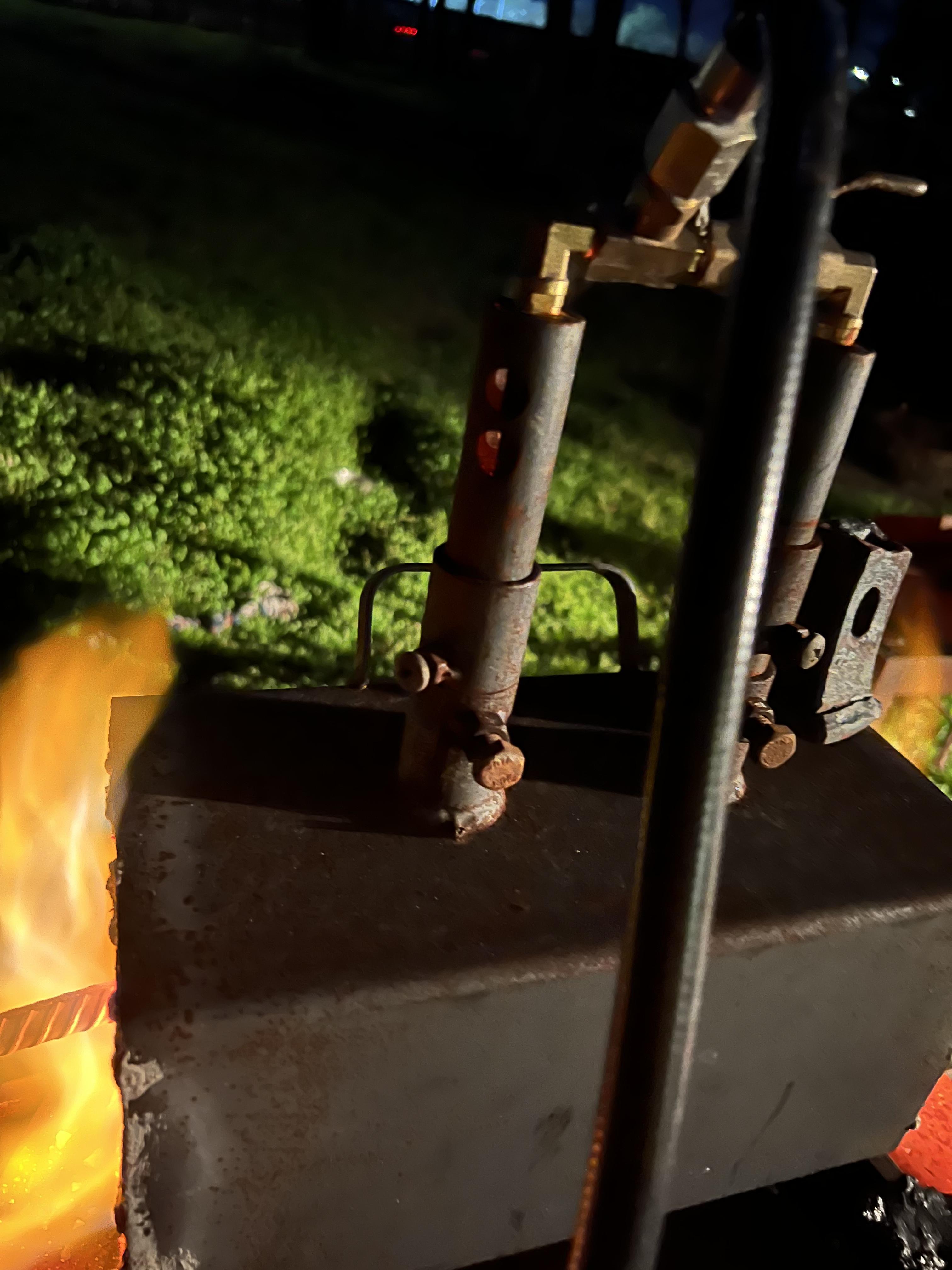

  15. Jake18 replied to Mikey98118's topic in Gas Forges
    I got a question now. I’ve been using my buddy’s forge since I was not happy with the one I built and am working on making a better one, and his gets pretty hot but having an issue with “backfire”. The flame will go back up to the nozzle but only for a moment before going out. There is a lot of dragons breath coming out from it even at low psi. Which to me says that it is running rich(or it could possibly be from the burner only being about 4 inches from the floor of the forge?). Anyways, my guess is that the orifice is too big, creating a very rich flame at too low of a speed to pull in enough air. I’m also thinking maybe this can be improved by drilling out the holes into fill slits to allow more air. I’m not sure though. Before I just dealt with this cause it still works but realized it’s a learning opportunity so here we go.
