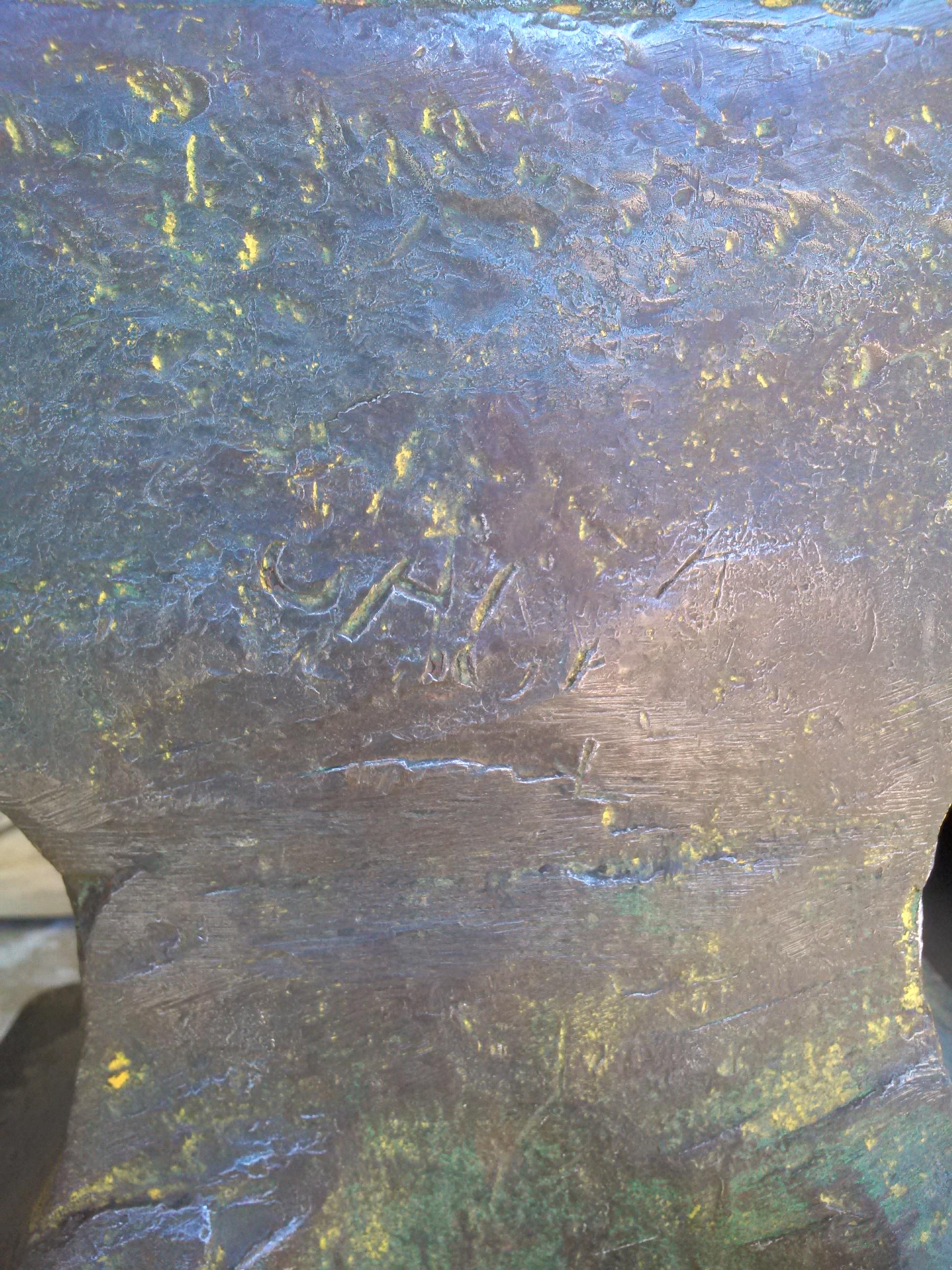

ThomasPowers: Here's the underside of the base if that's what you were referring to there were no markings that I noticed. There are no stampings on the heel side of the foot: -

Alright, looks like I just barely have letter fragments that was hidden under the paint. Got the foot stamps cleaned up too so that long number string now reads: A 108151 Here's to hoping we can finally figure out the brand... -

ThomasPowers: The indentation in that picture is shaped like this ">" with the open end pointing up around the 11'o clock position. Also, after looking at the base carefully I think that letter "A" before the long string of numbers might actually be an "N" if so would that change who the maker might be? -

Frosty: Good to keep in mind. George N. M.: Thanks for bringing to my attention that good ergonomics for a bad back is something to think about. JHCC: Thank you ThomasPowers: I finally got pictures of the base on the horn side and found some markings that are hard to read, I'm hoping once I clean it up it'll show up better. The underside is mostly solid with a small hollow under the waist. On the underside of the horn there is a hole on the waist that does not pass through, the heel side does not have a hole in the waist if that helps narrow down the manufacturer. The anvil is 100 pounds, I don't think it's been through a fire that I know of yet. A previous owner before the seller spray painted all over it for some reason. From what I could read of the markings the first picture looks like: A 1 1 8 1 5 4 Second picture looks like: 7 5 The anvil measurements are 25" from horn to heel, 3.5" on width of the face. Height is 9", foot length is 9.5", foot width is 8" -

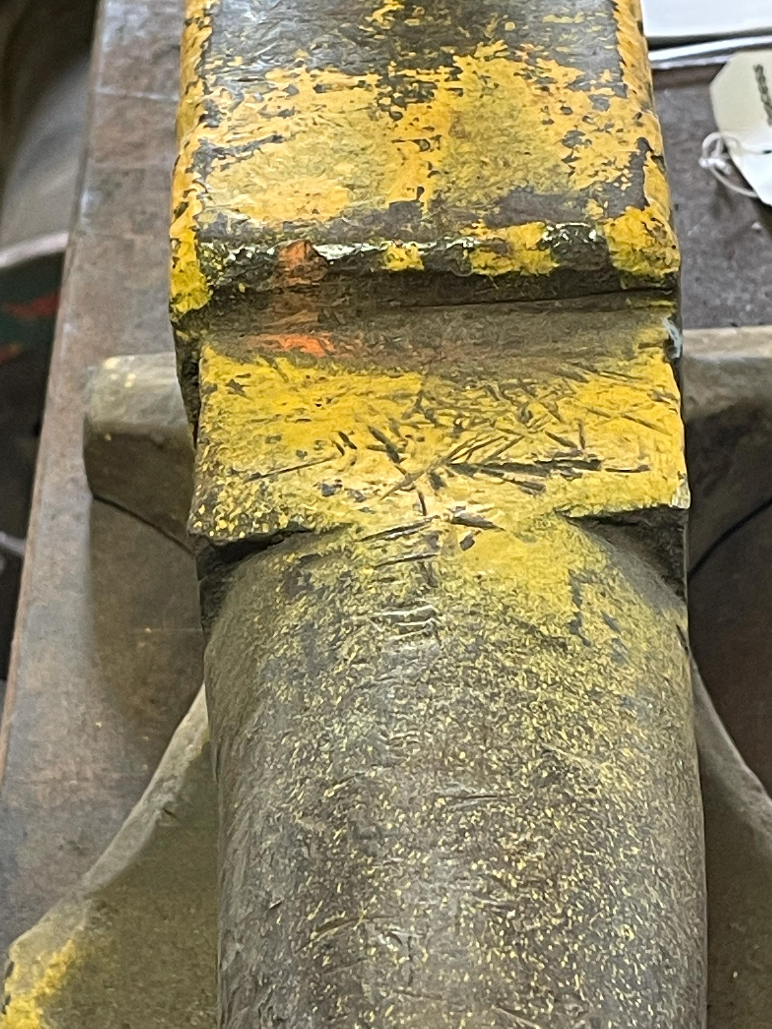

Twistedwillow I feel comfortable in saying below $300 for this anvil. Got it on forum rules and reading that. And it would appear I'm having difficulty finding that dang edit button so I can remove the "at" symbol. -

Thanks! I was debating between wire wheel, wire cup brush, or something similar to the Scotch-Brite Clean and Strip XT Pro Disc for removing paint off metal. Maybe I'm overthinking the small things, I'm also somewhat new to using angle grinders. -
Hey all, first time posting. I got lucky within the last three months of getting a Mr. Volcano Hero Forge and recently bought a used anvil from someone who wanted to get rid of it. So my questions are this: 1) What kind of grinding wheel should I use to get this paint off since I don't want to mess around with chemicals? 2) What grit wheel should I use to clean up the cut marks on the cutting step? 3) Anyone know what brand this might be? I didn't see any markings so far, but I also haven't had time to take a very close look at it yet. I wonder if there are any faded stampings under the paint. I'm thinking it might be a Trenton? Any input would be greatly appreciated.
