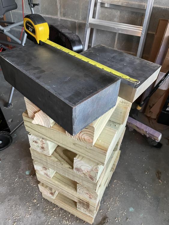

  6. I’m building my new forge. Everything is going wonderfully. I’m getting so excited to get this thing done and bang some hot steel on my recently-acquired anvil. I put down two layers of 1” 8# ceramic fiber blanket, got it all sorts of rigid, started applying the refractory, got it all finished and wrapped up with a wet towel in a garbage bag and BOOM… it hit me. I forgot to drill my burner hole. Is this a major setback or will I be able to just drill right through it? And right after I just ruined what was going to be an awesome handle for a Gyuto I’m working on. Face palm!

  8. I just finished layering and rigidizing the ceramic fiber for my new forge. Can’t wait to hammer on this thing. I couldn’t flatten/shorten the stump I found. It was eating up the chainsaw blade I was borrowing so I decided to glue and bolt a bunch of 2x10s together, sanded down the top and set the anvil down with a layer of caulk. This thing is quiet!!
