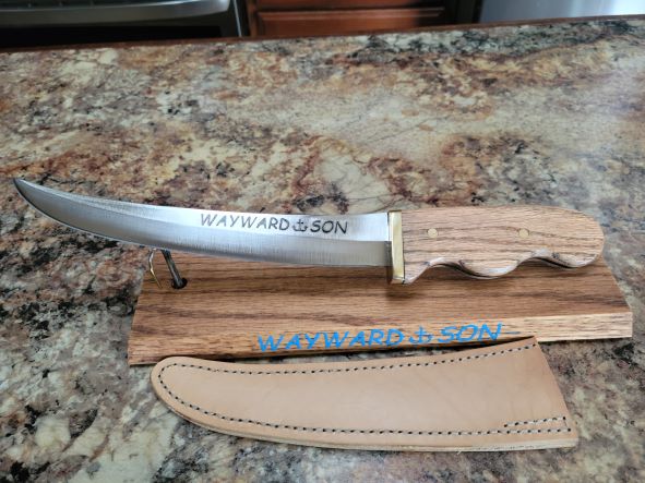

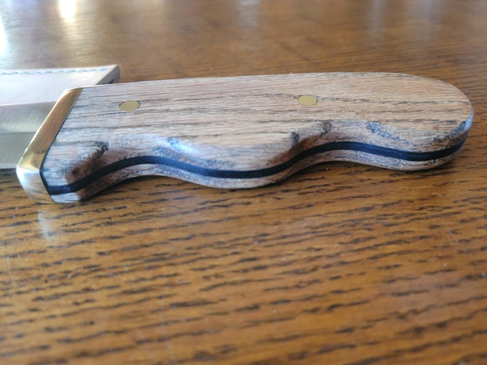

    Here's a knife that I built that now calls it's home on a Tuna boat in NJ. It's a fillet style just made heavy duty for tuna. The blade is 1095 which is my go to material. It has what I call a modified hidden tang. The blade is sandwiched between the Red Oak handle scales and then a leather spacer is used to fill the gap. The owners boat name is etched into the blade. I also made a display stand for it. Brass pins and handle accents.

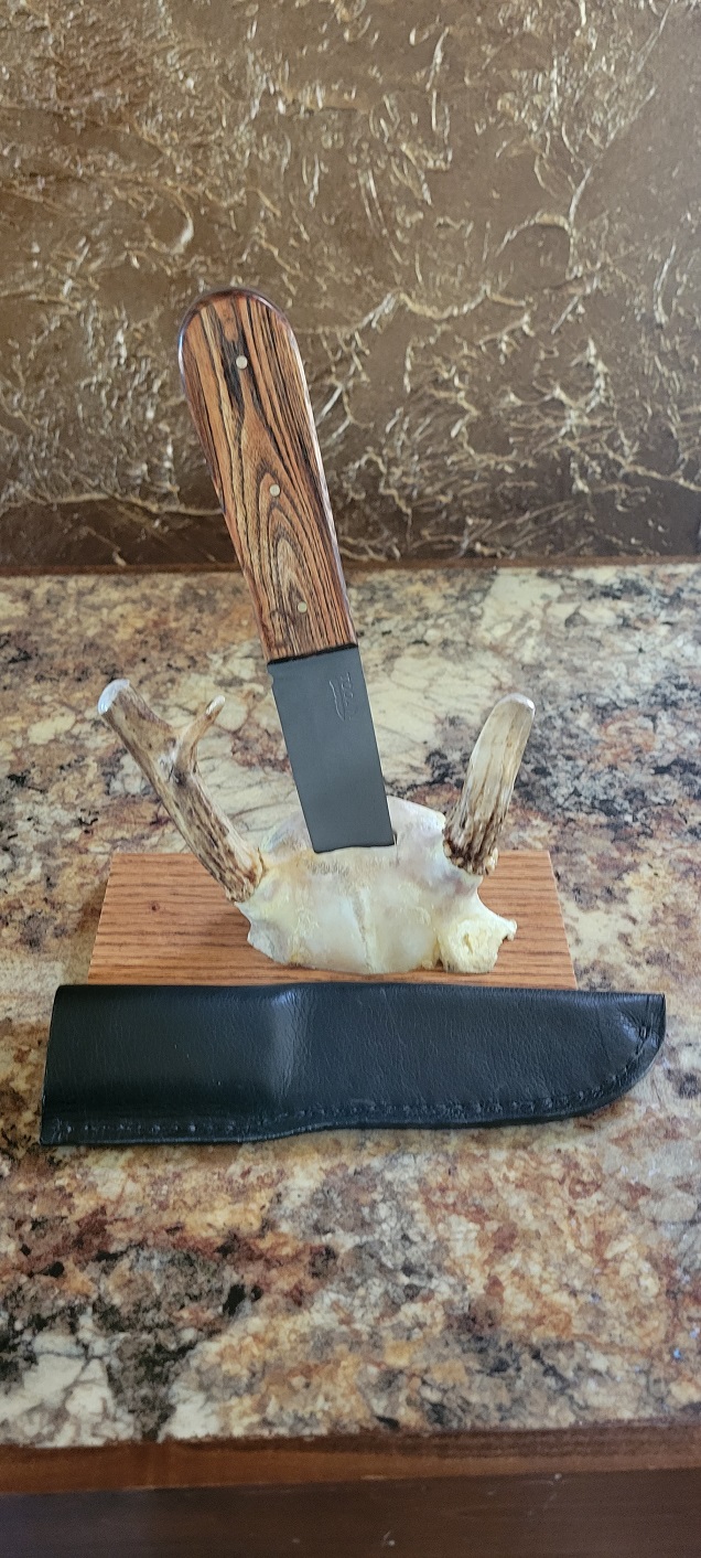

    I figured it time I post some of the knives I've made. This is the latest other than being sharpened it's done. The blade is 1095 and has been glass bead blasted and then into the vibratory tumble also with glass beads. Handle scales are Locust with brass pins, black leather sheath and display for the new owner.

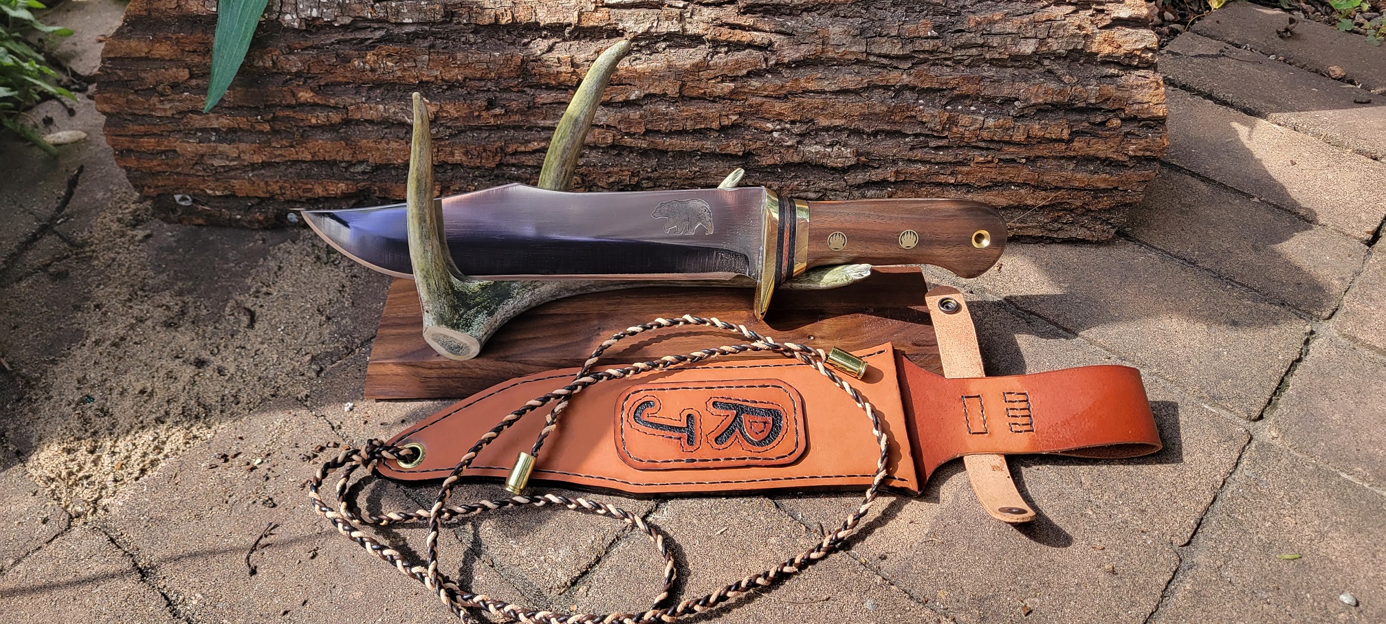

    Here's a pic of the first knife out of the forge I built. The handle and display are black walnut, it has tri color braided leg strap, bear claw mosaic pins, bear etch and the owners initials inlaid into the sheath. Over all length is 14".

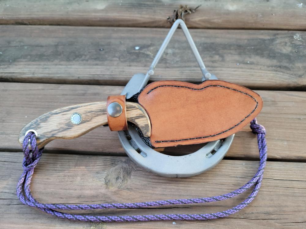

    Well the forge build was put on hold for a while as another build came in. I had an order for a knife and it took priority over all. Here's the finished knife. It has a white oak handle, the blade is 1095 that has been stone washed, it also has the first mosaic pin that I have ever made. The gal who order it is big time into horse's so I made a display stand from an horse shoe.
