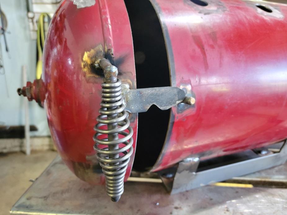

    Frosty I do plan to cut an opening in the door. No real reason to open while forging unless the piece I'm working on is that large. If it becomes a problem cutting it off and welding it back on in another location won't be an issue. Thank you for your thoughts and concerns.

    Well I did a little more work on the forge. Both doors cut in, hinges made and installed. Real simple door latch and handle's. So far I have $12.00 into it and that was for the handle springs, everything else is scrap I had laying around. I kind of got ahead of myself when I drilled the holes for the burners. I'm going to relocate them for better burn and efficiency. Not a problem with the old ones just weld in a patch. Material for this will come from the opening I cut into the doors. I'm not going to cut those out until I get the forge lined, this way I'll know exactly where the floor will be. Slow process now as I'm waiting for ceramic wool to line the forge. I'll update the build as it progresses. As always comments or suggestion are appreciated.
