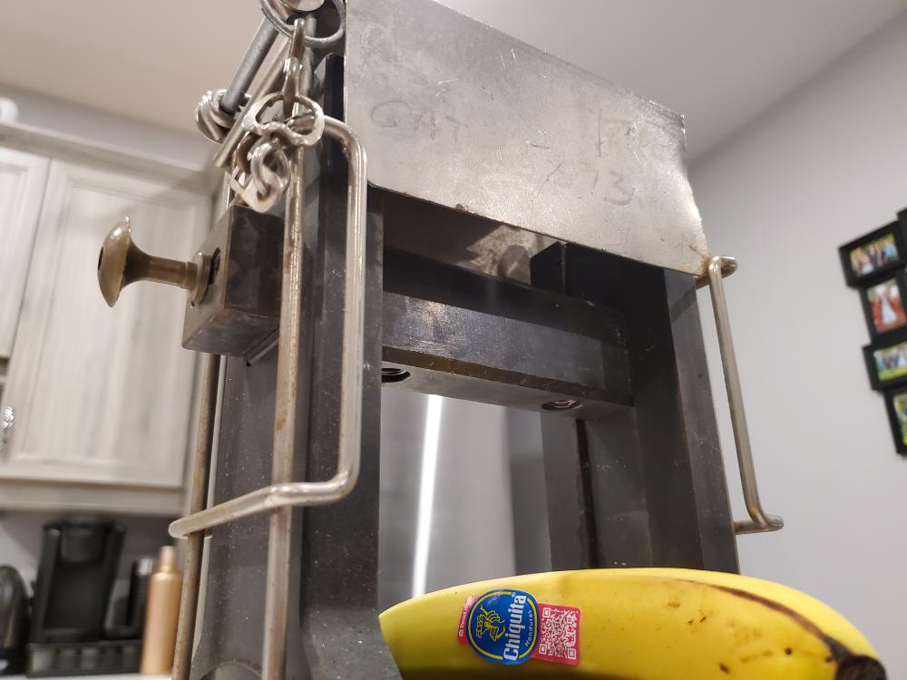

  2. So I picked it up, guy knocked off more money because ill have to customize it, he didnt have to but really nice of him. Banana is for scale. I took pictures in the kitchen before my wife came in so it would be bright instead of the dreary shop. I knew it would be small, in terms of the opening but I didnt think the cylinder would be as short as it is, he said its roughly an inch long, maybe a little more, ( he also thought the cylinder was 3 inches in diameter) so I think that means I will need multiple dies (that do the same thing) of varying thicknesses to accommodate the work, if i have something that is 3 inches thick, my dies cant be bigger than a half inch each, but if I have work thats only a half inch thick I will need larger dies to reach the work before maxing out the cylinders reach.....does anyone forsee i problem with my line of thinking on that regard? I am going to design a type of spring return mechanism that also holds the dies. Another problem I forsee is in the 3rd picture, the top die slids in, I wouldnt be able to have a drawing or flat die on it because id never be able to pull it out of its housing to switch, unless thats what the 2 screw holes are for? I havnt really looked at it closely, I just got home and snapped some pictures, hopefully this weekend I will be able to examine it some more. Any thoughts, questions, concerns, witty tunes or bad jokes lay them on me! Cheers Phil
  3. No worries Brianc! All thoughts and comments welcome. Ive looked up the pump that goes with this unit and it is a full hydraulic power pack normally, so thats what ill be looking at. My only concern is the forging end of things..I didnt realise how small the opening is, its basically a 4 inch by 4 inch square, then take into account 3/4 inch dies, the opening would be 2½" tall but i guess for knife making that should be big enough? Thoughts anyone? Ive also been trying to find the cylinder size online so that i can figure out how much GPM i need to run it at a decent speed but so far no luck.. Cheers Phil
  4. Going to pick it up later in the week! Thanks for all the help! And yeah ill probably just stick with the lever to be honest. Though I suddenly have an image in my head of a cave man pounding on steel with a lever Ill try an figure stuff out on my own with it but i may come back for some guidance! Cheers and thanks again for sharing your knowledge! Phil
  5. Hi Alan, Yeah I think both of you are right, he doesnt known the terms but he described it and its a single action, it can only apply force in one direction. And its the bottom die that moves up to do the squishing (hammer die) and then comes down by gravity. I don't know if it really matters where the hammer die is.. Frosty i can picture perfectly what you mean by manual action effectively making the stroke restart right away when you hit the pedal.. so its not going all the way up (or in this case down..) so manual is ideal in this situation. So he said he would part with it for 250 bucks. At the end of the day, what do you guys think? Im prepared to spend the money on if you guys think it will work, ive found a few 10000 psi power packs for 300 bucks.. Cheers Phil
  6. So.. Contacted the guy and made an offer, he accepted but asked what i was going to use it for and he said it wouldnt work for me..its only a 2 way cylinder and not a 4 way and it's really slow, it takes a good 15 to 30 seconds for it to go all the way down so its not quick enough to work the steel while its hot, i might get one or to presses in, unless that was one of the things you ment by pimping it out Frosty? Cheers Phil

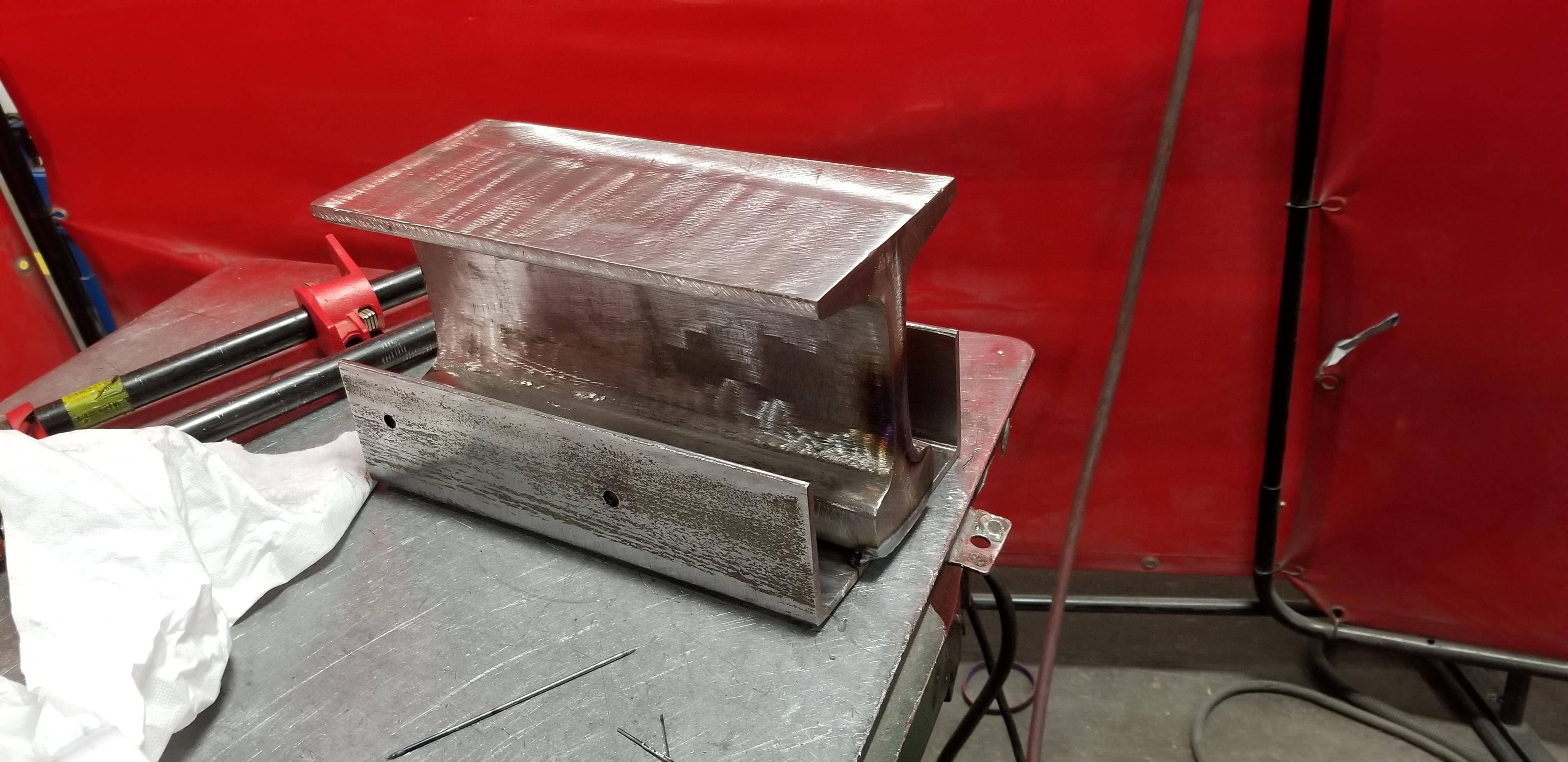

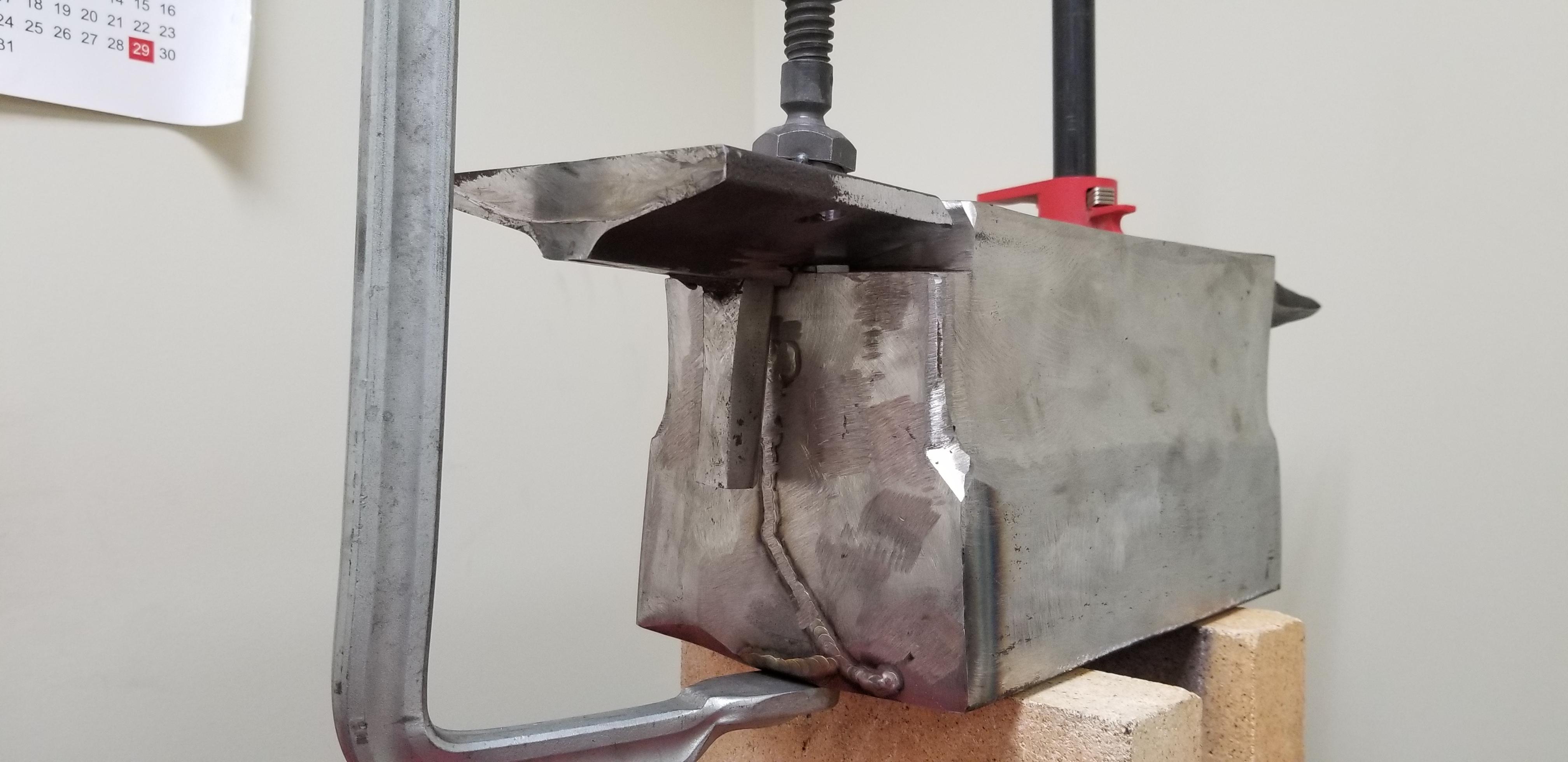

  18. Hello all, I think this is the correct place to post my anvil in progress, if not let me know. Let me start by saying yes I'm a little nuts to spend this amount of time on this project, but I was on a budget and work didn't mind me using filler as we have alot of waste anyway.. It started out as a chunk of RR, and then I got this crazy idea to make a full sized anvil from it.. I still need to weld the horn, and heel and feet on, but after 6 months on all my breaks at work, after multiple passes of Tig welding it is finally almost done..total cost of material was 40 dollars, I bought some rod of high carbon steel off a guy to weld into cavity to speed up the process, but every square inch inside is all welded together, no seam welding or the like at all so no gaps to cause vibration. I know I will lose most of my hardness when I do my pre and post heat for the welding so I'm trying to decide if I want to risk re hardening the face but I'm not sure of the best idea, I might just go the route of work hardening it with an air hammer instead of risking a heat and then quench... Let me know what you think, as well as any ideas! Cheers! Phil The Bearded

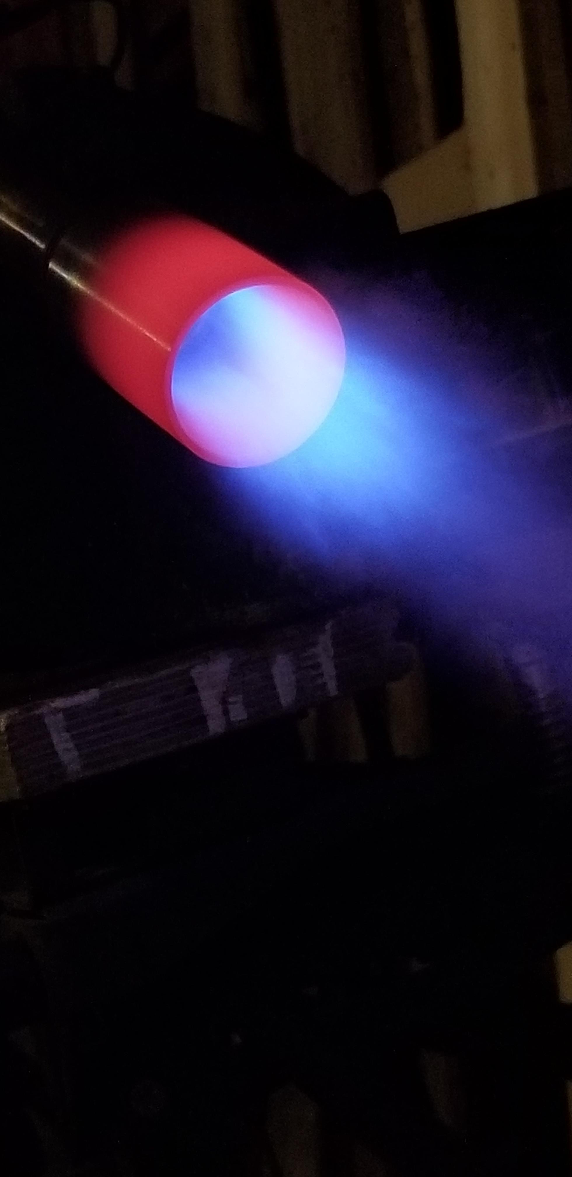

  19. Well thank you everyone for the terminology lesson, I'm going to re-read this page till that all sticks but definitely opened my eyes to what means what. Frosty I like metaphorical dangerous advice, it's alot of fun! But actual dangerous advice.. Not so much Cris, I'm probably just as green as you! The little orange fllickers you're seeing occasionally are probably flecks of debree from the nozzle, grinding dust, particularlets from an abrasive pad or cut off wheel, they go away after a while. An orange fan at the end of the burn being constant is more propane in the ratio than oxygen I'm pretty sure. Cheers, Phil the Bearded
  20. So oxidizing means too much oxygen, which I took to mean reducing? Do I have the terminology mixed up? On that track rich would be propane rich I assume.. I looked at the picture in better detail and now see a tiny bit of green between the primary envolope and the "tertiary" envolope, is that what tells you it's reducing which I'm now understanding means reduced oxygen and more propane...? Sorry to hyjack your post Cris J, I shouldn't have commented about your pictures until I have a better understanding of what I'm looking at, my apologies.. Phil the Bearded
  21. I don't know if this is acceptable for me to critique as A, I'm pretty new and B, this is Frosty's burner, but I would like to take a crack at it. Forgive me if it's not. Looking at your flame.. If I had to guess I would say it's a little oxidizing, I see purple on the fringes and white in the center, ideally you want no white and a deep blue hue..now I could be seeing it completely different in the picture compared to what your seeing in person because of what the camera does. Also it's hard for me to tell but it sort of looks like your ratios on your T are off..? I think Frosty's design for a 3/4inch burner has 1 inch air openings... Again it's hard to tell but it looks like your openings are bigger than 1 inch or your burner tube is smaller than 3/4inch..again I could be wrong. Since I'm new I would definitely wait for the greater knowledge of the others here, especially Frosty since it's his Design. Again forgive me if I shouldn't have added my 2 cents. Cheers! Phil The Bearded

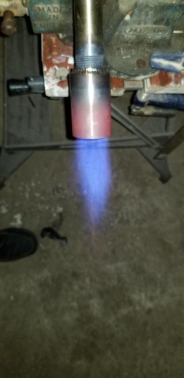

  22. Mikey A great analogy if I ever heard one! Thanks for the tip! Cheers! Phil the Bearded
  23. Too funny Frosty! I have actually followed all those differant designs in this thread and it's all very interesting to me. I think it made a differance in my burner but positive in some ways and negative in others.. maybe made the burner slightly unstable do to mixing speed possibly? I might try and lengthen the tube to see if that settles it back down, I know I have a good base model to go from, but I can't help trying to always make it better... I'm sure nobody here ever feels like that..ha! Thanks! I might just add visual design into my criteria from now on So then my crappy hard fire brick might work a treat then, the wife will be glad to see me get some use out of them after she found out the money I spent on... Well... Basically fancy rocks because I found out later, unless you want to forge a pizza, they are basically useless.. True words Mikey.. Not everyone has that welding fan belt for instance.. Cheers! Phil the Bearded

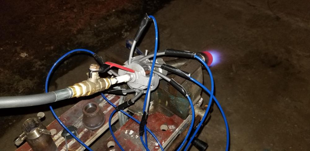

  25. So this is my little contraption to initiate a swirl at the top of the intake reducer.. I think it's working but I need to change something else to make it work? This is only a prototype/concept, if it's viable I would make a more thourgho setup with properly placed I let's and the such. Thoughts are much appreciated! Cheers! The Bearded Welder
