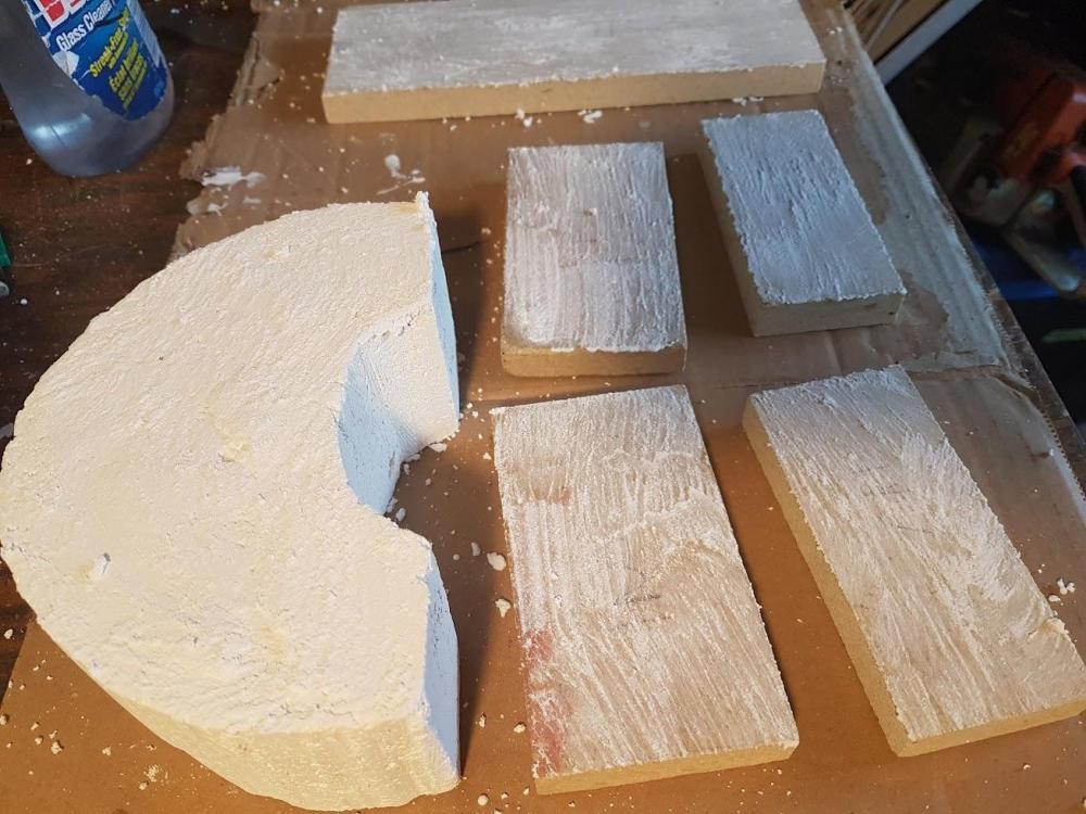

    Good eye - it's a repurposed Windex bottle with just water... I sprayed a fair amount of water on first, but the bricks just suck it up so fast they didn't seem very damp before applying the plistix... Same with KOL inside the forge.

    I'm assuming it's Plistix 900 - I ordered from Wayne and the bags were just labelled as Plistix. I asked but he hadn't heard of this happening and didn't have any suggestions for why it's behaving weirdly. I had read Glenn's thread, but hadn't noticed the last post: I wonder if me first 'buttering' the surfaces with water may have been the cause of it not sticking?
  5. Trees
    T Burner tuning
    Yep, buttered the surfaces first but no difference. The thrift store blender idea is great - thanks Pnut. The cloud of fine plistix dust coming out whenever something rubs a coated surface in the forge makes me feel like I should be using a respirator whenever I use it... Might make sense to buff off with a scotch brite pad and vacuum as much of the poorly bonded stuff as possible before trying another coat with the blender trick.

    Latex paint was the thickness I went for on average. I also tried thinner and thicker to see if it would help but the results were always the same. It would clump easily upon contact and dry (almost on contact) to a loose powder that would slough off, no matter how thick or thin the coating or how long I left it to dry... Like this: Each coat was more or less the same, even when firing between coats. I get a constant dusting of fine plistix dust every time I pull out the forge or something rubs against one of the surfaces. Mixed it well each time too. Noticed it felt extremely gritty when mixing, I'm guessing that's normal, but really wondering if I got a bad batch the way it behaves when it dries... Another weird thing. I tried mixing a batch that had dried overnight in the mixing container with fresh water the next day, and it behaved the same as the stuff freshly mixed from the powder.

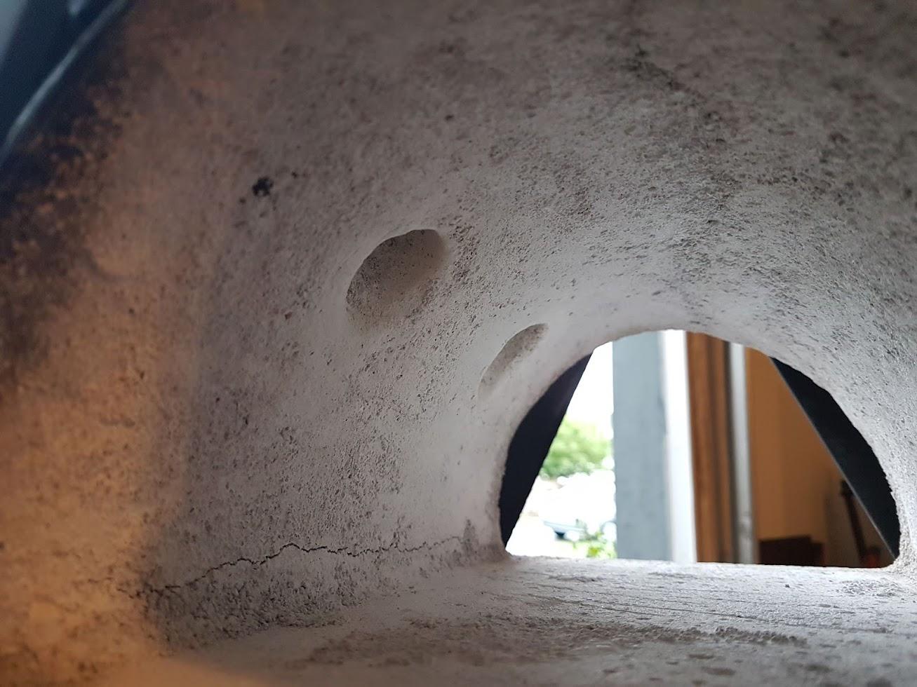

    Thanks Frosty - I should have mentioned that the other troubleshooting I did last night was to push the burner in and out and tilt it as it was running and it wasn't changing anything. Both burners were installed about 1/4" into the cast (KOL) nozzles. The forge is 2" kaowool covered with a 1/2" KOL & Plistix on top. The burner ports were cast using a wood form with a 1:12 slope for nozzles. Thomas, here's some photos of the setup (I'm not lighting it in the wood shop). Problem burner is on the right. I didn't think the kink in the supply hose above the burner would affect the burner that way - It looks to me to be a pretty minor constriction in front of a much smaller orifice. But I might be wrong on that one: Removing the burner mixing tube I may have found the culprit! I must have forgotten I put on a third coat of Plistix since the last firing (see the last pic in the first post where both burners seemed to be functioning much better). The port on the funky burner has some pretty big clumps of plistix making the nozzle rough and irregular. I wouldn't have thought it would affect performance that much, as I think even with the bumps the nozzle is still wider in ID than the mixing tube but is that the most likely culprit? I probably won't get a chance to test fire it tonight after scraping the plistix clumps off as it's pretty stormy over here, but will post back when I get the chance. Maybe while I'm at it I'll shamelessly plug my other post on the Plistix application as it was giving me fits and I still haven't figured out what I was doing wrong with it: https://www.iforgeiron.com/topic/68680-clumpy-plistix/?tab=comments#comment-747713 Here's the rough port followed by the cleaner one where the other burner seemed to be functioning OK:
  9. I have a recently built propane tank forge with two 1/2" Frosty T burners. When I fired it up tonight (fifth firing), one of the burners was behaving a little differently than it had before. It was much quieter than the other one and the flame was weird looking, not really staying together. I thought it must be a blockage in the fuel supply, so I detached the propane hose from the top of the burner to see if the orifice had some debris in it, but the MIG tip looked clean (gave it a couple swipes with a torch tip file anyway just in case), and I couldn't notice any obvious fuel restriction on that side of the system. Could it just be that the MIG tip extension in the T needs adjusting for fuel/air mix in the T, maybe it somehow got bumped deeper or shallower relative to the air intakes? Or does it look like it must be a fuel supply constriction somewhere? When the forge got up to heat, metal on that side did seem to visibly scale up a lot more, so I'm guessing that could either be a sign of fuel supply blockage or a MIG tip that's too far back? Any insight or suggestions where to start would be greatly appreciated. Here's what it looked like tonight - the naughty burner is in the foreground and the flame is mostly visible as the blue on the forge bottom and a little broken blue flame trickling down the wall, compared to the other side which is a uniform lighter blue cone (though hard to see in this picture): When I turned off the better functioning burner: Another shot from when it was a bit hotter, the flame in the foreground is almost making a dark blue halo on the floor: The floor here: And here's some pictures from previous firings when it was behaving differently - I haven't (at least knowingly) adjusted the burners between then and now:

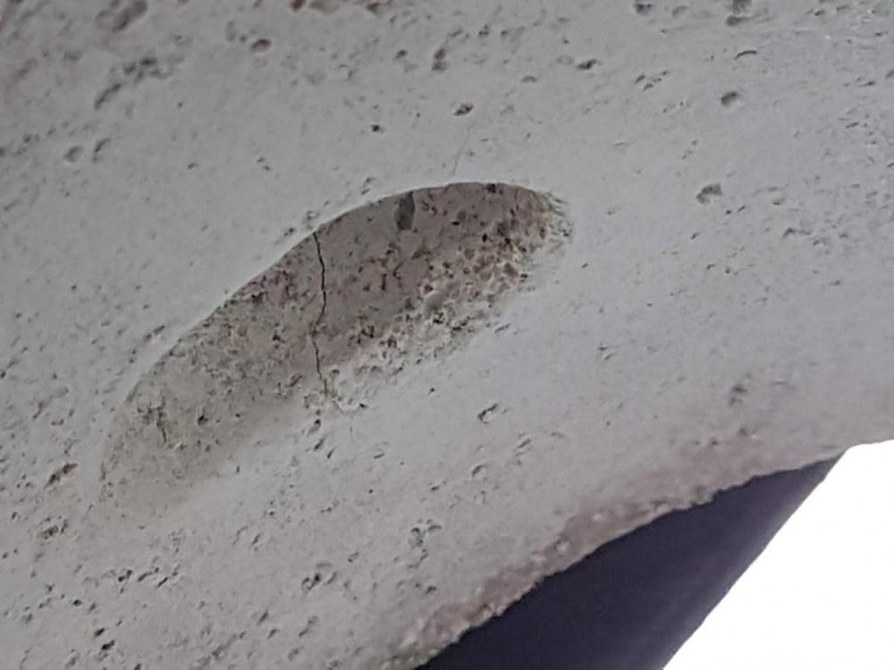

  10. And now to piggyback on this post - after the first real heat of the Kast-o-lite in the forge body, I've noticed some of the dreaded cracks appeared. I was heating up the forge to finish burning off the stinkies in the cured KOL before applying 2 coats of Plistix to the whole inside. Am I correct that these cracks can be effectively patched with the Plistix, or should I be trying to get a bit more Kast-o-lite in there first for added strength?
  11. Interested to hear people's experience applying Plistix... I was putting my first coat on the kiln shelf pieces that will be my forge doors and the K26 firebrick piece that will be the removable divider. I stirred the powder well with the water to maybe slightly thinner than latex paint to start and used a paintbrush. On the first brush strokes it would clump massively - like it was instantly drying and clotting together, leaving the areas between the clumps with barely any Plistix on them. Was similar for both the kiln shelf (high alumina I believe) and the firebrick, but a little worse on the brick. I tried 'buttering' a couple pieces of the kiln shelf first - not drenching but spraying quite a bit of water on it, but that maybe seemed to make it worse? Also tried mixing thinner and thicker with no improvement. The picture was taken after spending a bunch of time smudging out the worst of the clumps. Is that just how it goes with the first coat, or is there something wrong with my technique? Also - I've noticed that once the remaining mixed Plistix dries a bit in the container, it seems revivable by mixing in more water. Wondering if I put a lid on the container, if the same leftover mix could be used in a day or two if a bit more water is added again?
