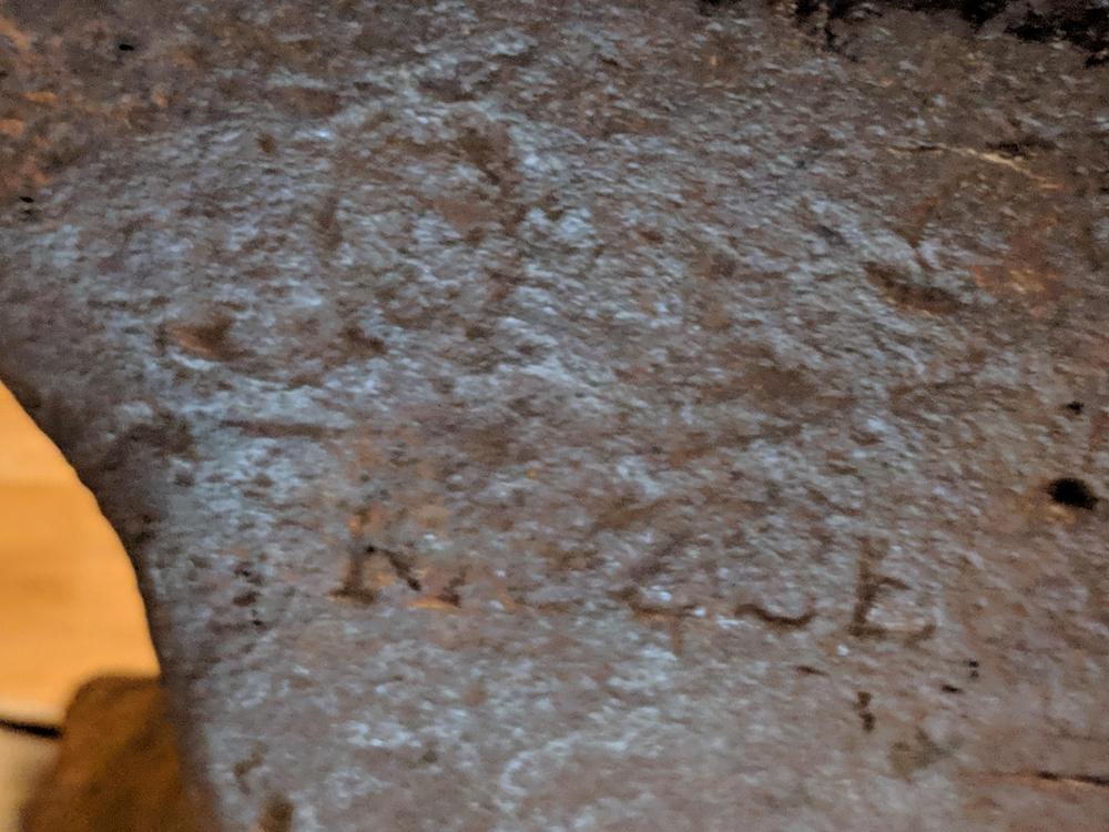

  4. Thomas, I'm sure you are familiar with the weight marking systems LOL. So I will definitely take your word for that. With the big have only weighed around 10 lbs though? Also I just cleaned it up with a wire brush some and this is the best picture I have. I'm sorry if it is not the right size, I'm trying to figure out how to resize it from my phone

  6. When It was weighed at the junkyard it was 71 LBS. I gotta think with the horn and all it had to be near 100. But in the grand scheme of things it really Doesn't matter much. I mean I think its awesome to know the history of it. But I couldnt have said it better than many of the posters in this thread, And especially Swedefiddle! Well said sir. Maybe call it the Double Deuce Mouse? LOL

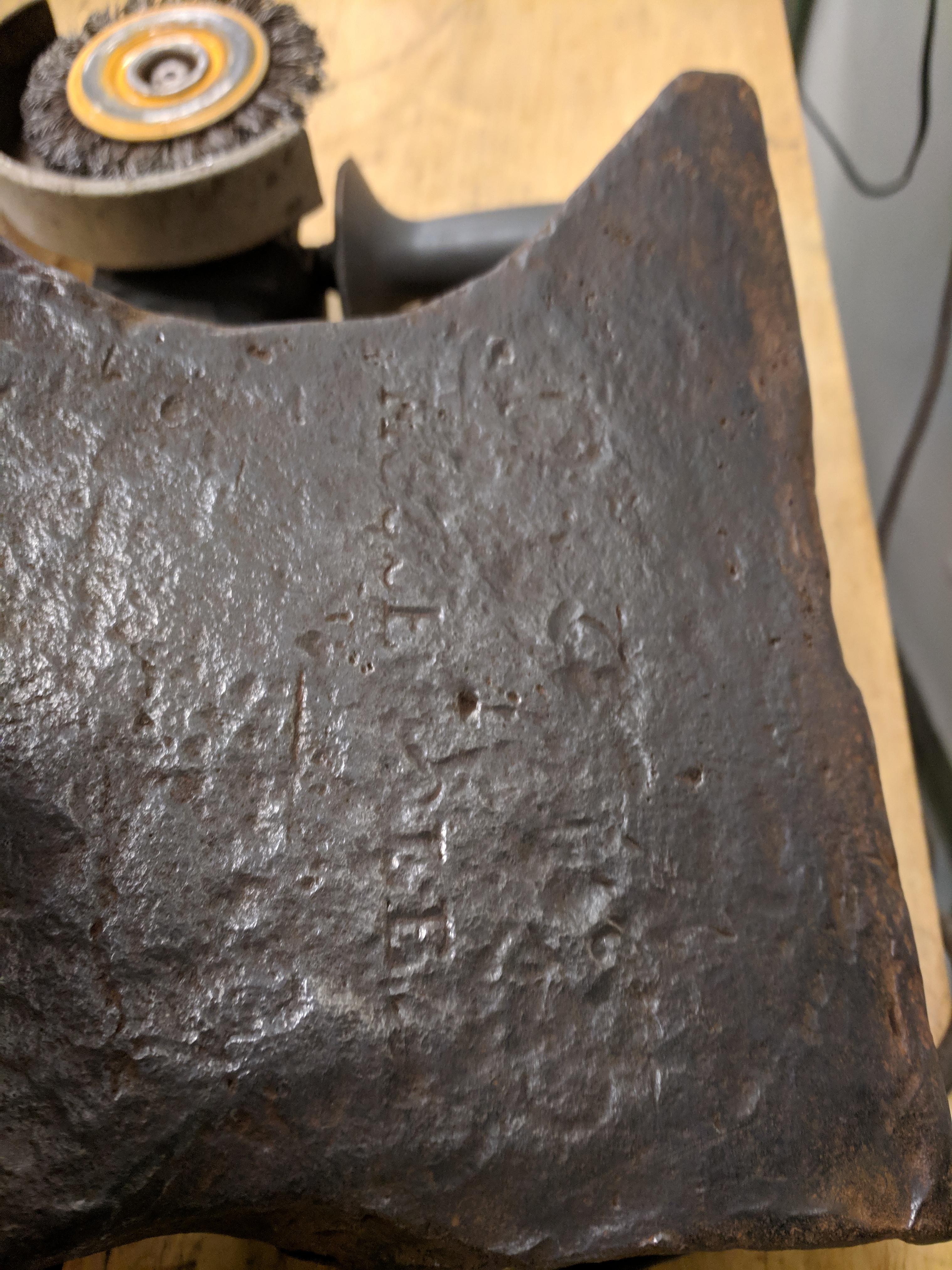

  7. Yes and No, The best I can figure is its still pretty much the same words as I thought it said before, but they seem to be easier to read now (except that Im still not super sure of the mouse part) If any of that made sense to you then I am glad ... Im not so good at getting my point across sometimes. But I was able to find a couple of the weight numbers and they are above the "Whatever the word is... Hole" stamp that it has. I think it is a 0---2 something---25 And I checked all over then end for a clogged up pritchel hole. There is no sign of one at all

  9. Thanks JHCC. Oh yeah, What area? I was born and raised in Dana, still living there too LOL. It has changed a lot over the years! I went to college in Orlando for 1 year, and when I got back it was soooo different

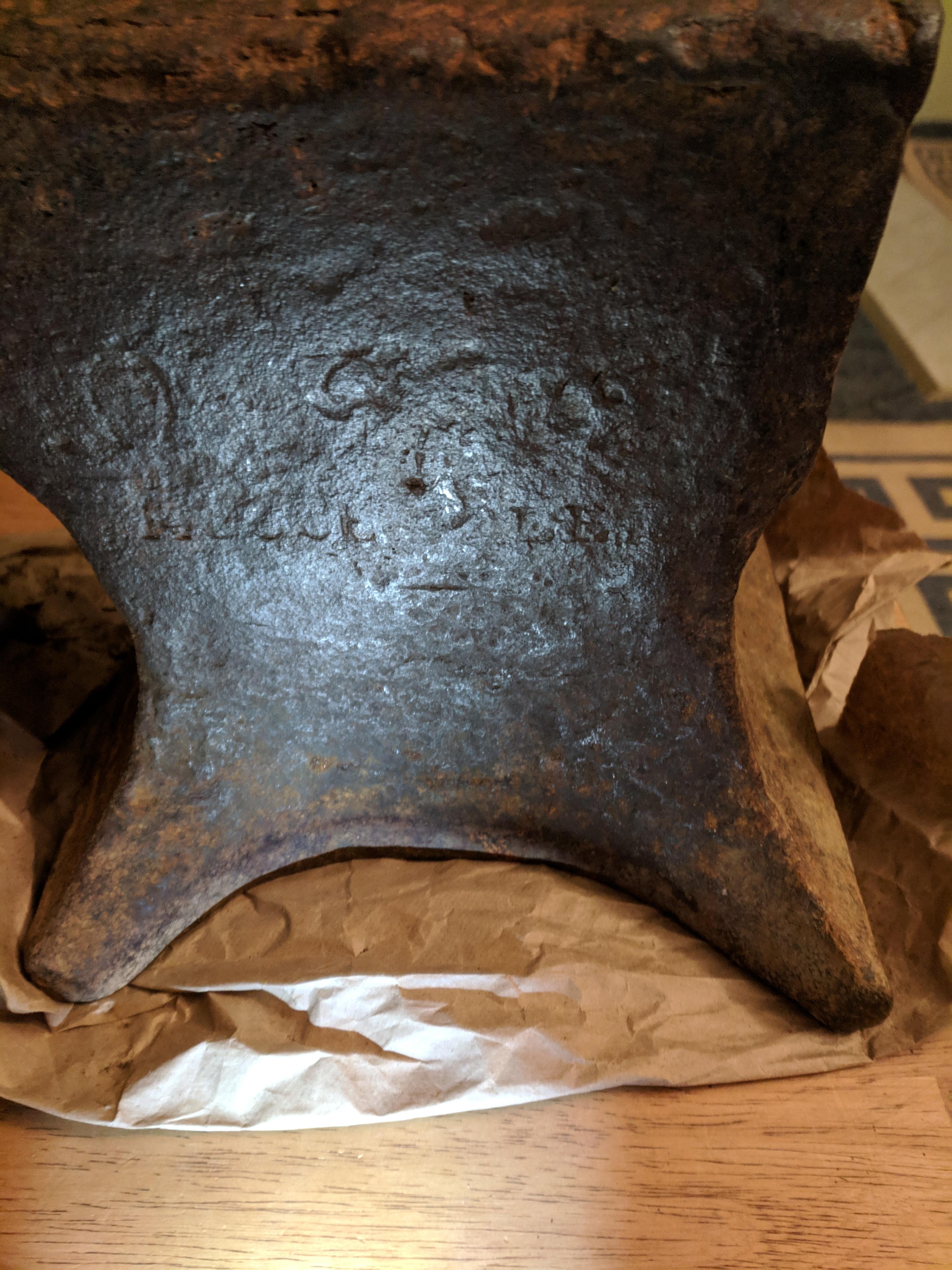

  10. I cleaned on the anvil a tiny bit today, as most of my tools are elsewhere at the moment. I had a grill brush and an old toothbrush with soapy water. I found some writing on one side. It almost appears to say something "hole" i was thinking maybe a mouse hole? It looks like it has an emblem stamp on it as well.

  14. Hi all. I am a newbie here, This is my first real anvil. I found it while looking for an ASO at my local junkyard. It seemed to bounce my 8OZ ball peen very well, and was only $22...A whopping 30 cent a pound. It is beat up but hey, gotta learn on something right... It weighs 71 pounds, But has the Horn (bick?) broke off of it, so I think it may have originally been closer to 100 pounds. I have no clue who made it, or what it was originally supposed to look like. If anyone could help me identify it (I know some here seem to think its a useless point,) But I think it will help me to know how it looked so I can return it to its former glory, and a good working order. I have not wire brushed it yet, as I read here that some anvils have thin faces, and I don't wont to hurt whats left of the face. (Another reason I was wondering who the maker is) so I know the dos and donts of the particular brand in question. I can not find any markings on it, and it only has a hardy hole, not a pritchel hole. If that helps. Also being new to Anvils I don't know if any of these are normal. But It has a hole in the bottom, akin to the hardy hole, but not going all the way through. And a set of holes (one on either side as well) Again not going all the way through to the other side. If anyone could help me I would be much appreciative, And I really would love to know if it would hurt it to have a bick or round stock or something of the round shape welded back to it (If I develop the skills and need for it). Thanks all in advance, Justin / AKA: Dana 1942
