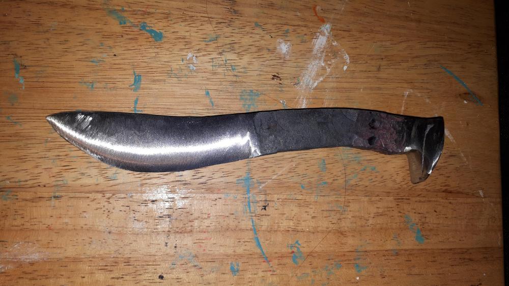

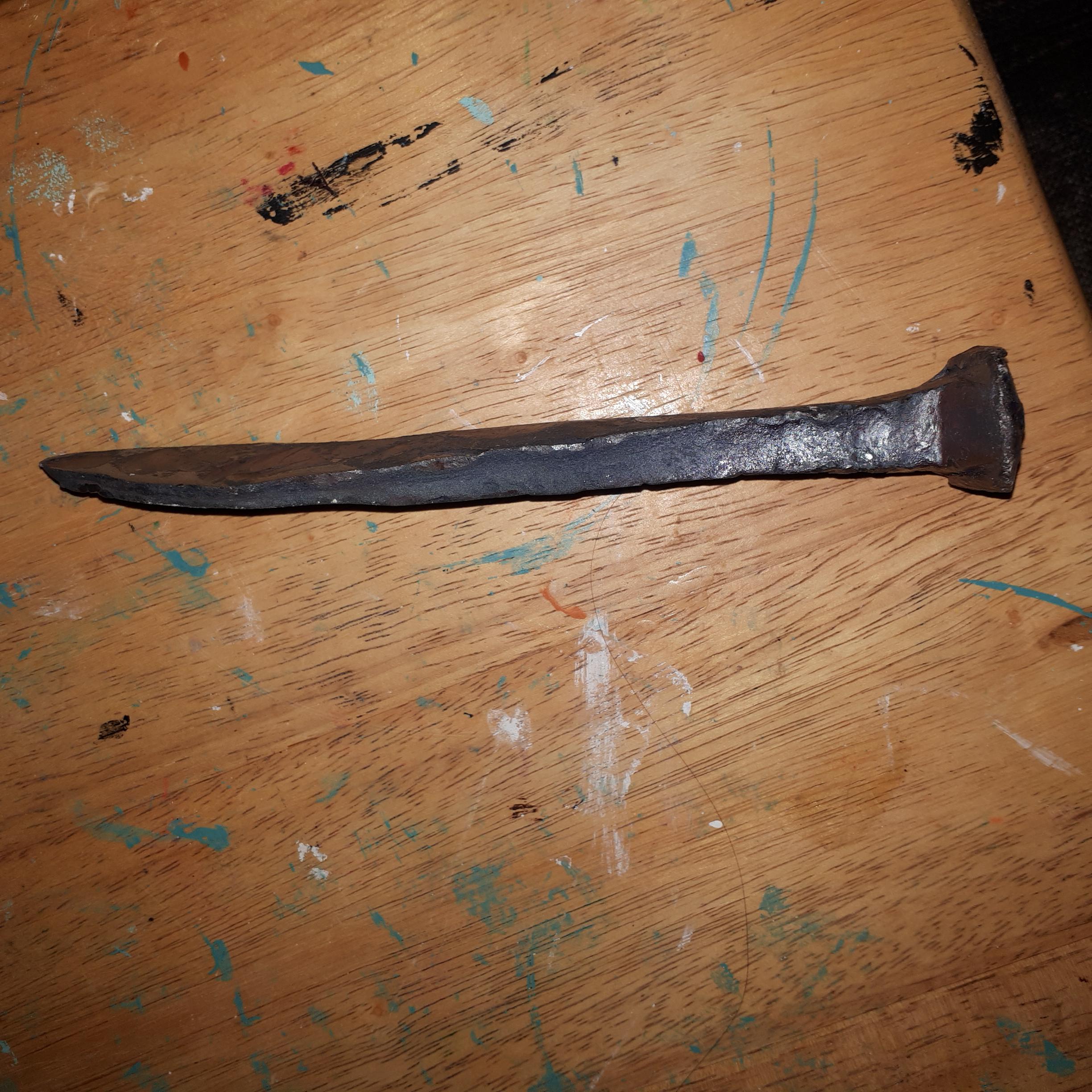

Ok so this afternoon I ran the forge for an hour and hammered my first spike in to something resembling a knife shape(to me anyway). The forge ran well and the refractory actually was glowing a soft orange. Q1. is that expected? I am assuming yes. Q2. I am trying to draw out some length and width while battling the tendency to twist. Any advice? I need to work on my grip strength cause after swinging the 2lb hammer for an hour I can barely type this message... haha -

Ok I will look in on the kiln shelf. I couldn't wait I went back outside. It took less than 8 minutes and the spike was red hot. -

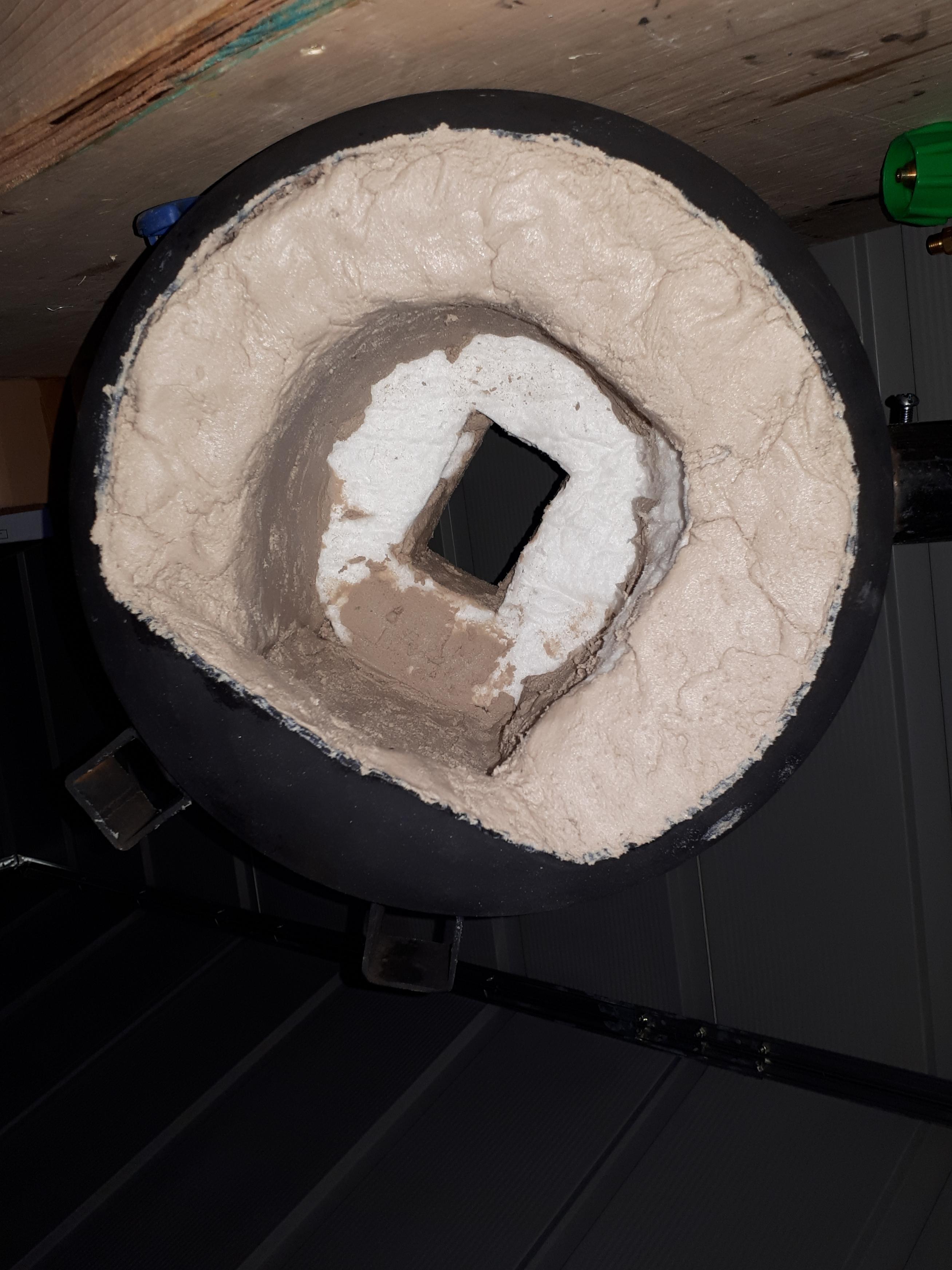

Ok I will move back the burners. What would be a better floor, I was thinking that using the brick would allow it to be replaced easily later. and I'm not sure what you mean by "You need angle on the forge face to use bricks to control heat loss." -
20# propane forge is operating Kaowool, refractory cement and plistix. double sidearm 3/4" burners with stainless flares. Good blue flame seems to jump out a good 2 or more inches. Q1. How long should a single railroad spike take to heat up to forging temp? Avg.. just to have something to expect or compare too. Q2. Should the stainless flares get red hot or does that mean I should get them pulled back a little more? Q3. Flames run blue but have an occasional orange flame puff and then continue blue. Does this mean something else needs adjusting?
