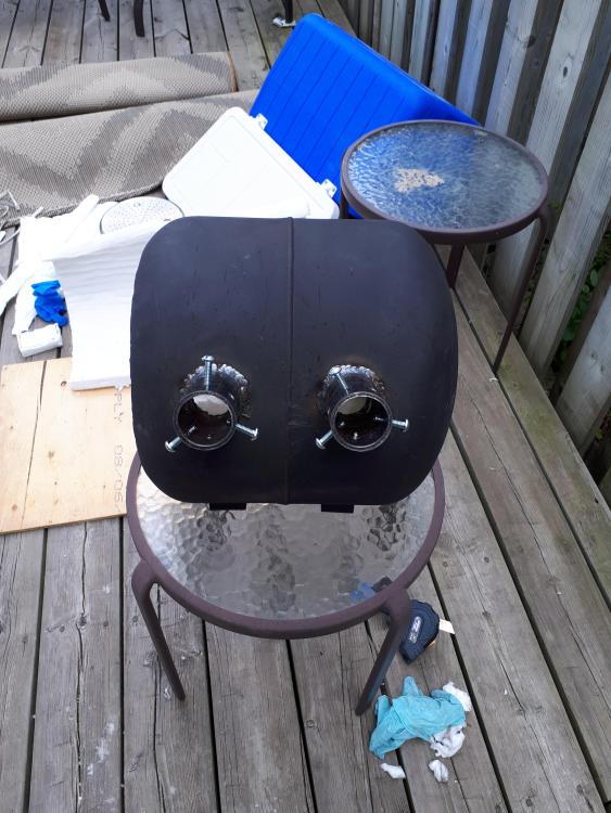

  9. 20# propane forge is operating Kaowool, refractory cement and plistix. double sidearm 3/4" burners with stainless flares. Good blue flame seems to jump out a good 2 or more inches. Q1. How long should a single railroad spike take to heat up to forging temp? Avg.. just to have something to expect or compare too. Q2. Should the stainless flares get red hot or does that mean I should get them pulled back a little more? Q3. Flames run blue but have an occasional orange flame puff and then continue blue. Does this mean something else needs adjusting?

  14. yes I found them at Bardon supplies
  15. And part of my refractory is on
  16. So today I got my collars tapped and welded on to my tank and I have finished my two 1" layers of Kaowool. I also got my mig tips silver soldered in place
  17. I have 14T mig tips but they are not "tweco" they have an "ms" stamp on them. I asked at the pipe cutting shop for 1/8" schedule 80 and I believe that's what they gave me. I was thinking about getting and end cap and drilling and tapping it to screw the mig tip in to.
  18. Thank you for the help Frosty. I have gotten to a larger city and have been able to get 2 of the proper ward reducing tees, and I am ordering 2 SS Flares from Zoeller forge. My biggest problem now is that the 14t mig tips seem to be to small for the 1/8" black pipe. Any ideas for me?
  19. my front end opening is 10" wide by 8" high and back is 3x5
  20. that's my front end opening. I will use 2 " of kaowool, refractory cement and castable ITC 100. Here also is what I have so far for burner peices.
