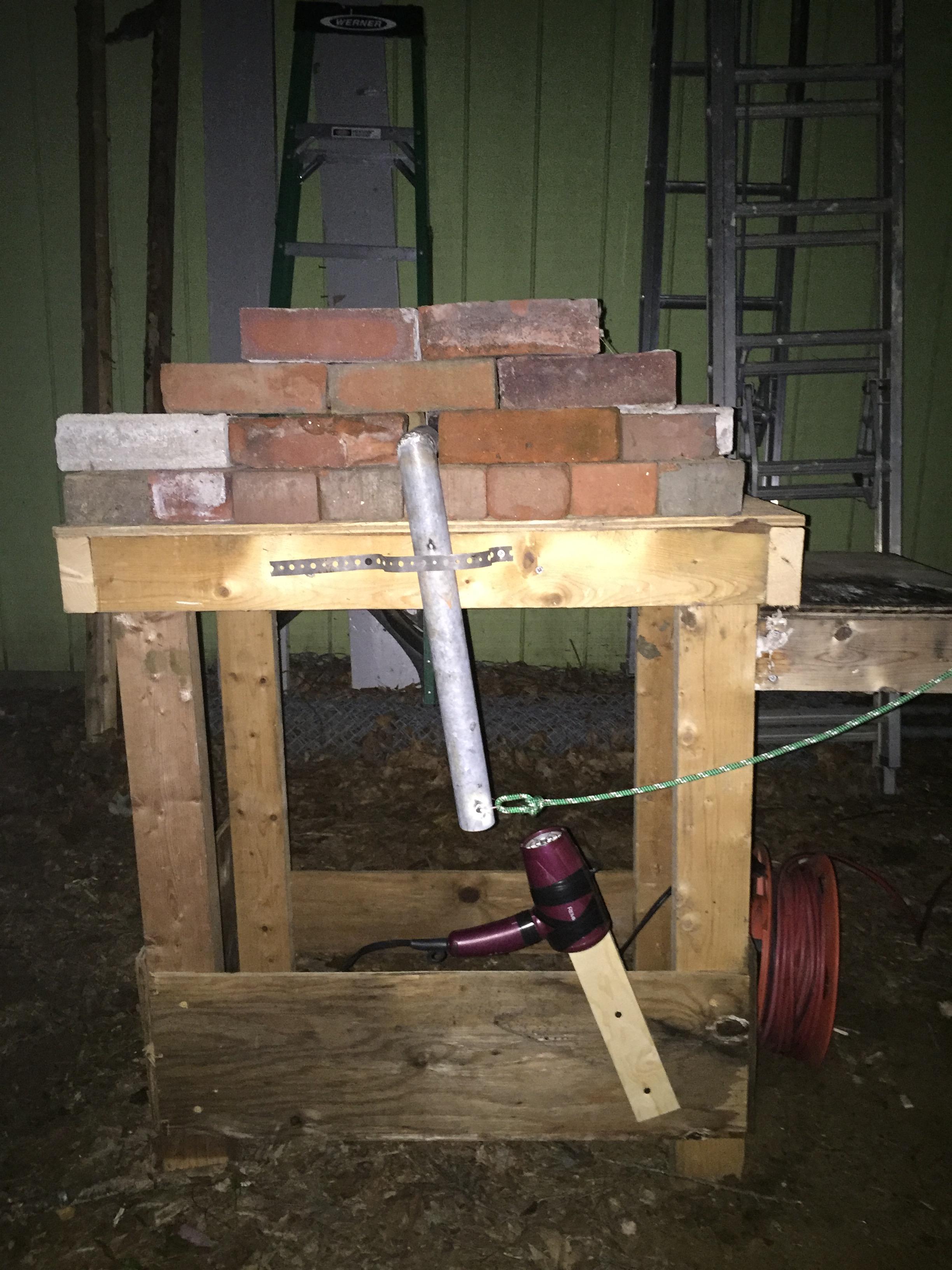

Riffing on the JABOD idea, I decided to use what was handy, namely a pile of scrap 2x and plywood, some old bricks leftover from a neighbor's tumbledown chimney, the wifes long-forgotten hairdryer, and a bit of old fencepost pipe (relax, I am aware of hot zinc issues, and wore a respirator for the welding and first fire, thanks for thinking of me!). The bricks are piled up two-deep on the floor, and arranged so that the gaps between bricks dont line up. Nothing is mortared, so as the bricks burn up, which it will, I can just re-stack it all. The hardware store in town sells smithing coal, and so after a bit of faffing about getting the coal to coke and the bricks warmed up, it works quite nicely! I lost 6" of the rebar shortly after I took these photos, got distracted in the garage and left it in too long, and it melted right off! I just left the dryer on low, and the tuyere pipe swings in front of the dryer to adjust the blast; the pipe stays surprisingly cool in use, and when I was done, I just took it out so it wouldnt burn up in the after-fire heat. I set the dryer off at an angle, so if the blast control line gets knocked off, the fire will die down instead of run away on full blast. It's not perfect, but its not too bad for the investment. This was just a first fire and a test; I'm working on getting my anvil on a stand and so hopefully in the near future I'll actually get to do some work and get to know the forge. Hopefully I can make this little pile of bricks work for awhile.
