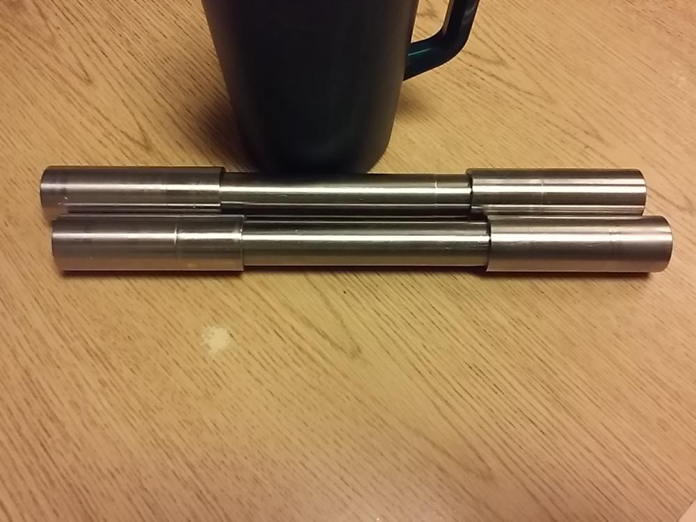

  1. Yes, the chokes are 4" at present. I figure I can cut 1 of them down, for the stepped flame nozzles. I want to try tapering the chokes, and see how that goes before cutting any parts shorter though. Today I tried milling the slots in the burner tube. Man is 316 a pain, talk about something work hardening. I started out with a titanium coated 3/8 bit with a mist coolant, and went to a carbide bit dry. I'm not a machinist, but I need to do a little research before trying the second burner. I fried both bits. I patched the forge early this morning, and it came out reasonably well. I put a 100 watt bulb in it and turned it upside down to heat for tonight. We'll see how it looks tomorrow after Chruch. Maybe a real heat lamp tomorrow. I need to get some IR reflector ordered.
  2. While planning my next steps to take on lining the forge, I decided to get started on my burners. Half a day in the garage with the lathe and some 3/4 & 1" stainless 316 scraps i picked up the other day and this is the results. Lots of machining left to do, but this is a start.

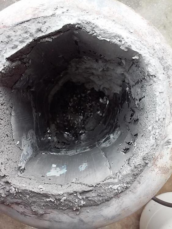

  3. Thanks for the replies everyone. The mizzou I bought is a gunnable type, The directions for regular mizzou are not to exceed 11% by weight, and recommends 5 pints per 55lb bag. I hope my attempt to pour cast with it is not a total failure. I think it can be saved, but I won't be using this method again. I have complete voids where no mizzou flowed next to the inswool and I have lots of visible air pockets. Despite 15 to 20 minutes of probing with 2 different sized rods. Also the cardboard I inserted to cast around was nice and round when I put it in, but somehow became semicircular, with one very sharp corner. I'm going to mix another 5 to10lbs and try to patch what I have for now. That will still leave about 15 lbs for the freon forge. One other word of caution, don't use Al foil instead of plastic wrap. Most of it came out fine, but now I have to deal with getting the rest out before I can try to patch it.
