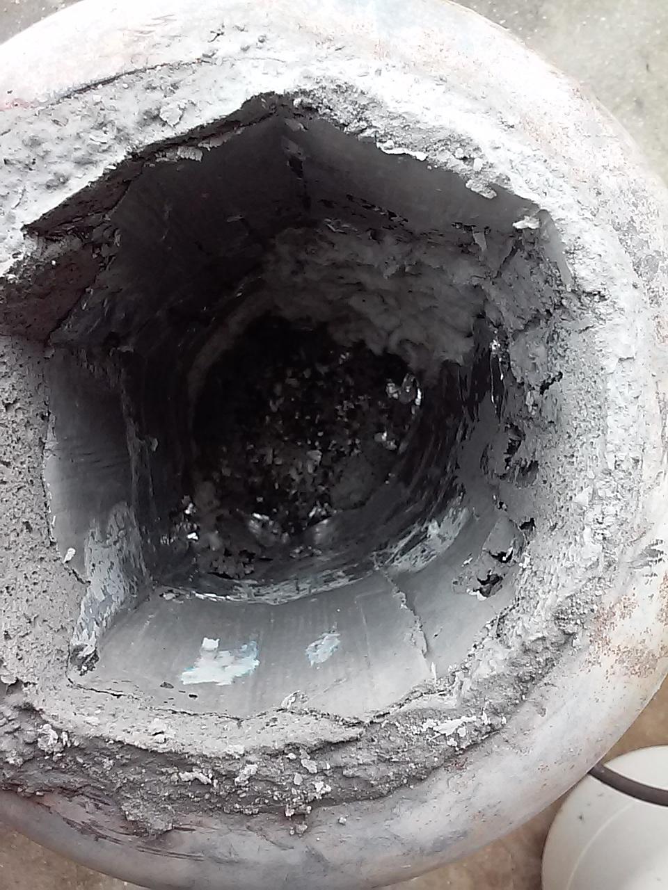

Thanks for the replies everyone. The mizzou I bought is a gunnable type, The directions for regular mizzou are not to exceed 11% by weight, and recommends 5 pints per 55lb bag. I hope my attempt to pour cast with it is not a total failure. I think it can be saved, but I won't be using this method again. I have complete voids where no mizzou flowed next to the inswool and I have lots of visible air pockets. Despite 15 to 20 minutes of probing with 2 different sized rods. Also the cardboard I inserted to cast around was nice and round when I put it in, but somehow became semicircular, with one very sharp corner. I'm going to mix another 5 to10lbs and try to patch what I have for now. That will still leave about 15 lbs for the freon forge. One other word of caution, don't use Al foil instead of plastic wrap. Most of it came out fine, but now I have to deal with getting the rest out before I can try to patch it.

Sorry, I'll try to take some using the tablet on the freon bottle build, from the beginning. Just a comedy of errors on this one, starting with too small a hole. Maybe I'll finish up with some pics from here, but it was nasty cutting that tank with the inswool already installed. Definitely changed my mind about cutting my torch holes with the plasma cutter. I'll have to run to Lowes tomorrow to pick up a hole saw. Any problem using a carbide tipped for the metal and cutting through the refractory? I'm thinking 2" or is that too big? thanks, Ken
I've been trying to locate a freon bottle so that I could make both forges at the same time. I didn't want to mix up Mizzou and have too much left, if I could use it in a second build, but that hasn't happened so I decided to go ahead with the 30# propane tank build. I started out by marking the semi-circle around the carrying handle and cutting the tack welds off with a 4.5" grinder. Then I used my plasma cutter to cut through the tank around the semi-circle (it was full of water and standing upright, so no fumes could fill the tank). I cut straight across the open end of the semi-circle, thinking I would use that to build a shelf area later. It got interesting when I tried to cut my 1" inswool and insert it through the hole. It didn't fit, so being hard headed, and not cutting the hole out larger and circular, I decided to cut the inswool into 2 pieces. I got that installed and intalled a second layer of 1" inswool for 2" thickness, and off set the gaps. I forgot to rigidize the first layer, so I made up a little over 1/2 gallon of colloidal silica and sprayed the liner real well with my pump up sprayer. Not having a burner built yet I realized I had a turkey fryer with a high pressure valve, turned the tank upside down on it and began to cook it off for several hours, just to make sure that I had driven off all the water and rigidized the silica. Yesterday, I looked several places for a 6" sonic tube (cement form tube) to place in my forge so that I could cast the Mizzou around it into the inswool. No luck there, so I decided to use a 4" dryer vent and wrap it with cardboard until I got up to the 6" desired. I tried fitting that into the forge this morning and it would barely fit if I used a putty knife to hold the inswool back while trying to insert the tube. I decided there was no way I was going to be able to insert the tube and then pour the Mizzou down past the inswool. So I decided to use the plasma cutter to cut another 1/2" out all the way around the forge entrance. Boy what a mess, I used the shop vac to clean a lot of it out of the inswool, and had to pick a lot out by hand. Take it from me, go ahead and cut a nice 8" hole when you start, you will fight a lot less demons along the way. I decided to re-rigidize the liner. Then per Frosty's instructions I covered the outside of my liner tube with aluminum foil, I didn't have any plastic wrap, to keep it from drawing too much moisture off of the Mizzou and affecting it's thermal qualities. I was barely able to squeeze a transmission fluid funnel (long skinny) down between the tube and the inswool. I mixed up approximately half of my 55# bag of mizzou, to peanut butter consistency and place a layer about 1/2" think on the back, with the tank standing up. I then mixed it to a very thick soup and tried to pour it down the funnel using a 1/2" rod trying push it through and it would not go. I cut about 2" off the end of the funnel till I got a 3/4" opening and it still wanted to plug, so I finally added a little more water. Finally it was able to flow as long as I would fill the funnel and ram rod it down the hole with the rod. I know my tube got off center at the back, so I may have to address that issue, as it may only be about 1/4" thick on the bottom. I tried to use the 1/2" rod and an 1/8 rod to poke down through it to release any air bubbles, hopefully I got all of the larger ones out. Now to let it set for at least 24 hours or longer before pulling the tube. I know this is a long post, but I hope it helps someone else. Ken
