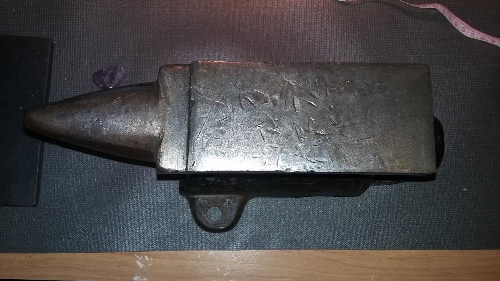

Heat treating an cast anvil face
CheschireCat replied to CheschireCat's topic in Heat Treating, general discussion
No, offense taken, however I would like to point out the fact the marks are from when I had first first started forging. Now a days, that particular anvil has both been clean-up and retired. My current anvil, 65lbs (Cheapo store bought ASO) has next to no marking on it. Like you said, those notts are hard to get out. As a hobbiest/novice I already have enough of them I don't need anymore. (That and I also got around to making a custom anvil stand. Perfect height for me, not to mention a few inches ajustabillity up or down.)- 14 replies
Ok, I thanks again for the advice. I am fairly new to metallurgy and blacksmithing in general, so I am asking alot of questions. But In my opinion it is better to ask lots, learn more and mess up as little as possible. Not knowing much about cast iron I sought out help. Simple as that. One of the reason I'm so interested in this anvil is the fact that I have another one lined up, a nicer one, (wrought iron body steel face.) I just need to finish pricing things out with the owner. Meaning I have this ASO left over. I figured at the very least I could experiment and learn form it.- 14 replies
I was recently on the Anvil section of the forums asking about replace a cast iron face with an steel one. I haven't quite yet decided on whether I will or not. However I am leaning towards not replace the cast iron face. Now my issue with the cast iron face is just how soft it is. I realize that sounds a little bit strange however it dents rather easily, (I was under the impression that Cast Iron was very brittle not soft.) So I was wondering if possibly when I refinished the anvil face with a Angle grinder I might have undone whatever temper there was on it. (Not knowing too to much about proper anvil care at the time) What's your take on it. Attached is a picture of the face. I'll see about getting more picture/video of it. Thanks -Ray
