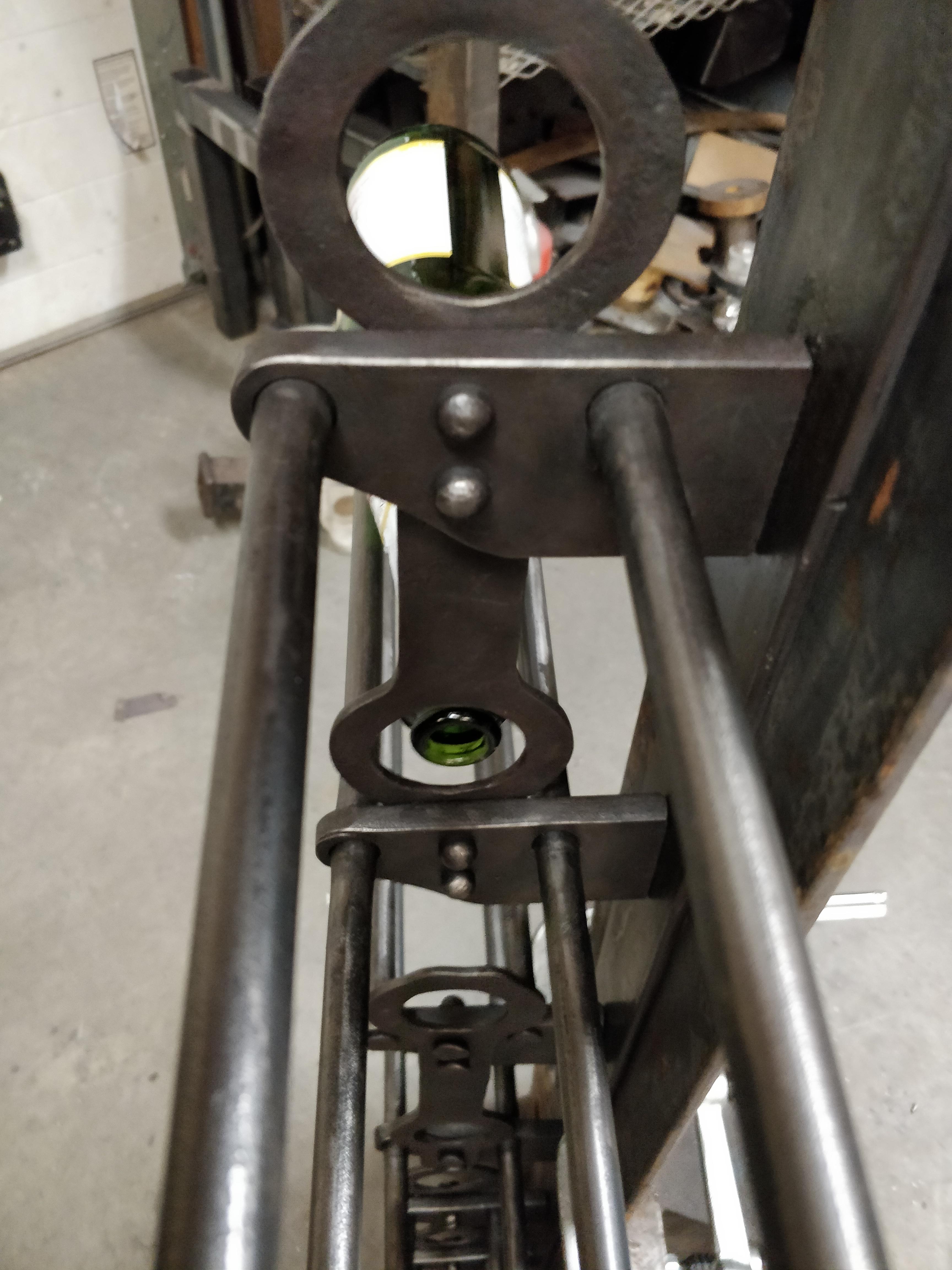

Finished my first wine rack today. Learned a lot, didn't scrap too many parts, and hopefully the client is happy.

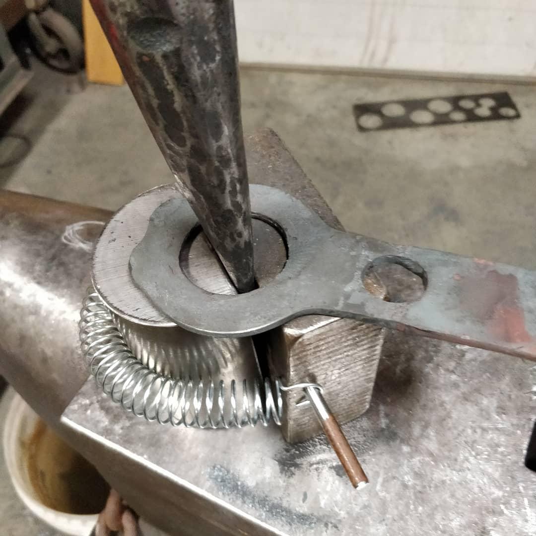

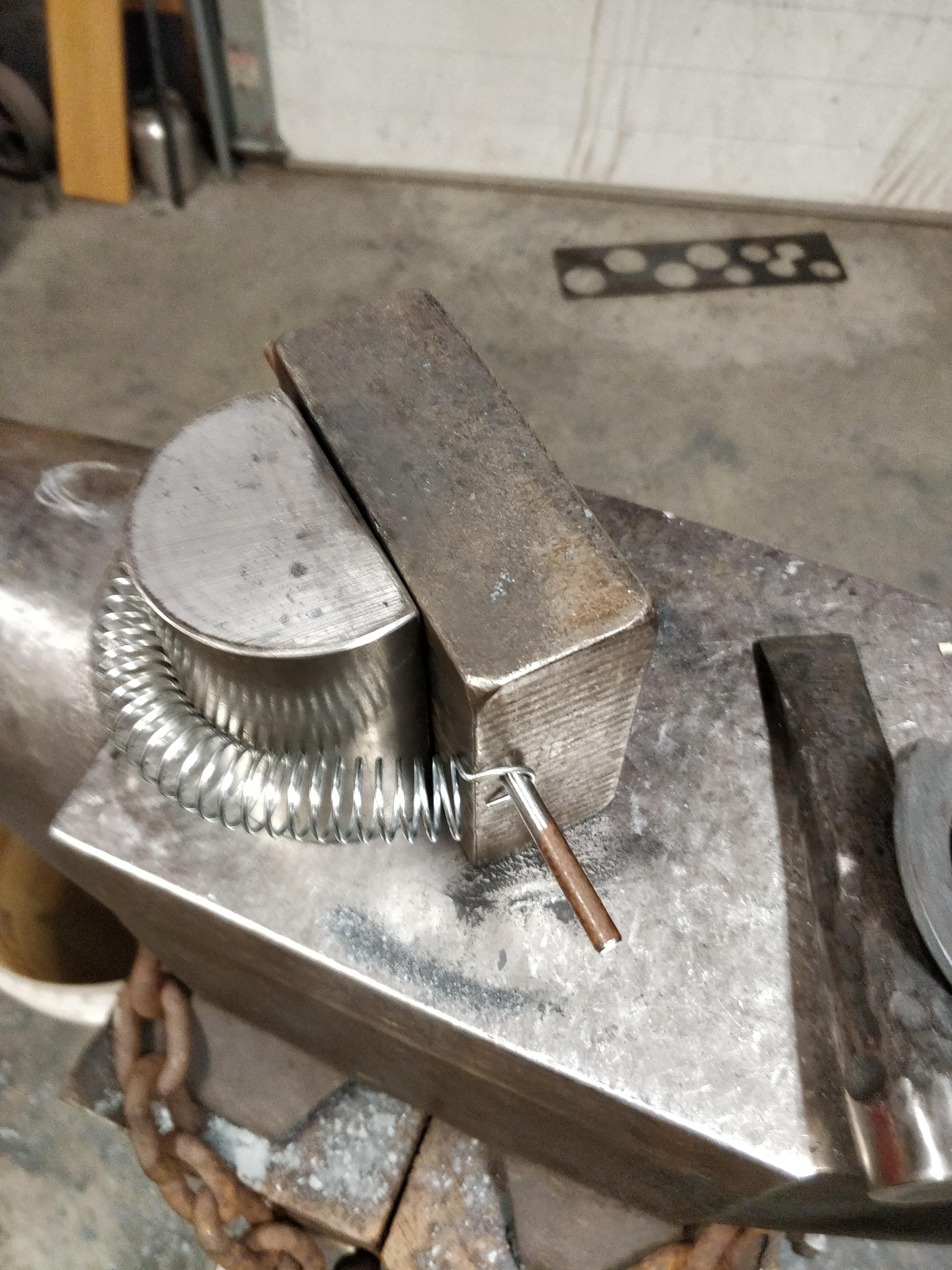

I needed to get some 1.5" holes drifted into 1.5" x. 188" flat bar. It was a struggle getting the slit hole opened up, so I rigged up this spring loaded bottom tool. It supports the work nicely without leaving any marks and gets the hole about halfway opened, at which point a swage block (or in my case, a chunk of DOM tube) finishes the drifting.
