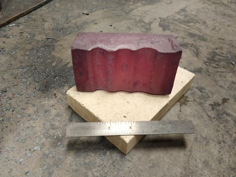

I am still tooling up my blacksmithing side of the shop, so today I tried to make a simple swage block. I have a 12 ton press with only 3/4" travel, but I was able to get 3 different radii on one side and a dishing die on the other.
