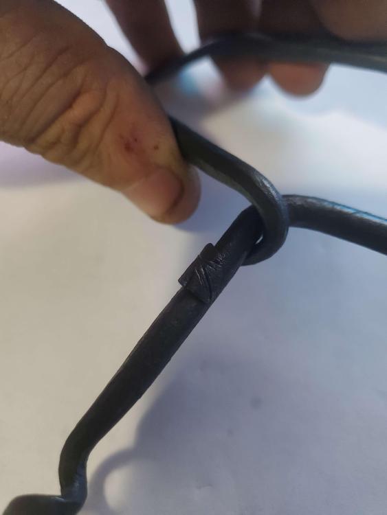

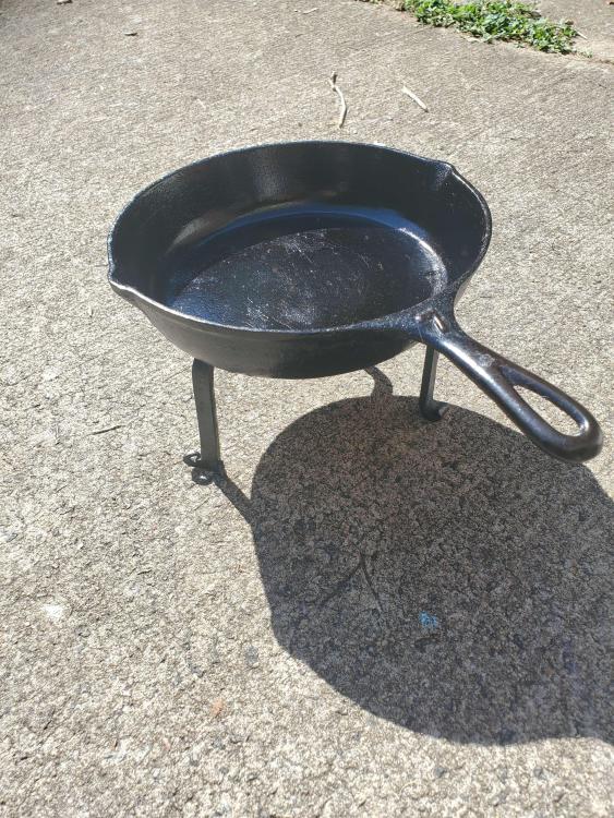

  3. Forged out a folding camping trivet last night. Pretty happy with the results. Did it all on live stream. heres a clip of me punching the hole in the main leg. https://clips.twitch.tv/CrowdedObservantSnailMcaT-1N_6e1U3rc2CWZ51

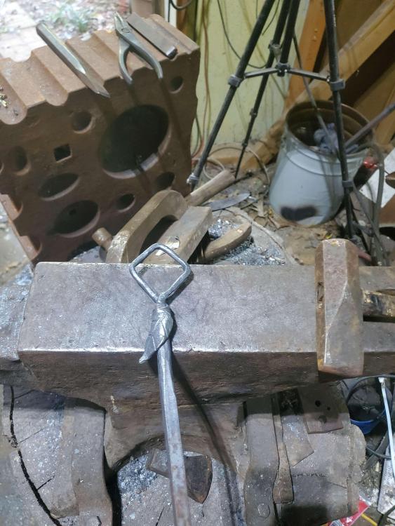

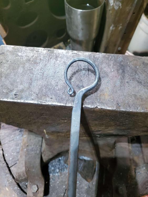

  7. Forged out a corkscrew last night on stream. Fun project. my proportions are a bit big but its totally functional. Ill get better picks when the sun comes out. The leaf wrap is probably the smallest leaf of my life. Maybe a 1/4" leaf in total. Since im right handed, I laid onside side of the handle on the fattest portion of my horn to give it a slight radius, then flipped it and did the same to the opposite side which gives it a bit of an S shape. I think it took me about 90 minutes by the time i was finished fiddling with it. Coated with coconut oil to give it some protection.
