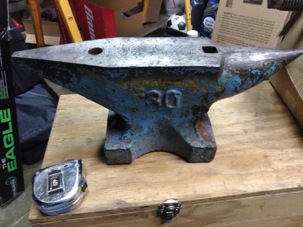

  2. I bought this anvil on Saturday and can't find much info. It weighs 66 pounds which confirms my thought that the 30 meant kg. There is a square hole on the underside. There is a series of numbers under the rounded horn 463 9. I can't see any other marks with the paint still on it, but I thought the color might help someone identify it. The edges are almost new and far too sharp for most of my forgings, but dont worry I won't go crazy rounding them all. I know sharp is handy for some things. It measures 17 1/2" long, 8" tall, 3 1/2" wide on the face, and the base is roughly 5 1/2" x 8". The hardy hole is 7/8" and so is the round hole. Is it still a pritchel hole at that size? It rings very loudly when struck on either horn. A small ball bearing dropped from 6 inches bounced back up to over 5 1/2 (the distance I could see with my phone propped to record it). Any advice is appreciated. Thanks for checking it out.

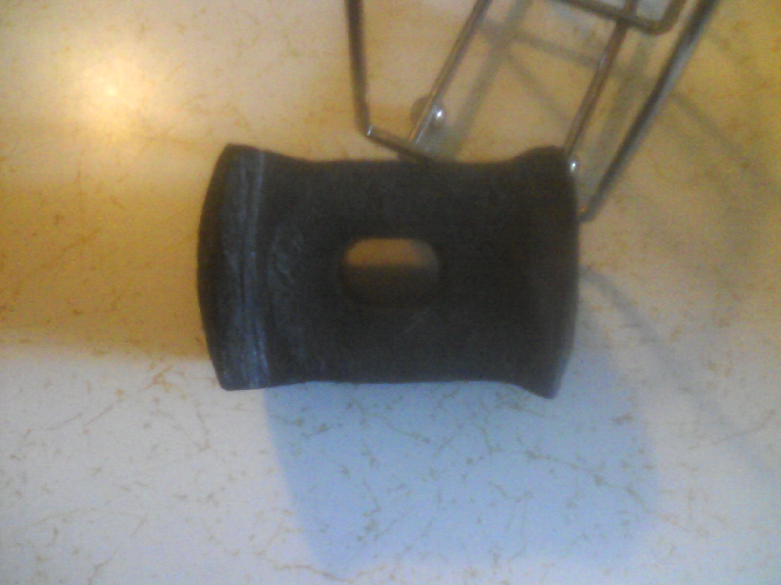

  18. I have been working on a hammer head while I try out my new gas forge. The material is 4142 1 1/2" square stock. I started with a 2lb. piece with 2 offset holes drilled to help guide the punch. My wife held the stock and punch while I swung the sledgehammer. The hole punched well, but I didn't have a hardy hole. My current anvil is a 3x8x13" piece of S7 with a couple different radii cut and shaped on the ends similar to Brian Brazeal. If you're wondering why the odd alloys, there was a crazy sale I got in on with our local group. I took it to a class I was helping with, and worked on drifting it during the lunch break. The anvils were too high to get a good swing at, so I didn't get very far. I decided a striking anvil would be helpful for all the normal reasons but especially the finished price of under $75 for supplies. Drifting the hammer eye proved fairly easy with this. The faces of the hammer were upset slightly then shaped into a rounding hammer similar to a Nathan Robertson (no fullering). This is the style that the MN Guild teaches in a class I took. After final drifting and shaping. I normalized it three times with the last time leaving it in the forge after shutdown to cool. I ground the faces to 220 grit before hardening. Finished weight was 1lb. 13oz. I heated the head up slowly from a cold forge turning it over for even heating. Then quenched it in used fryer oil, moving it constantly until it was cool enough to handle. I tried testing it with a file to check for hardness, and it didn't seem very hard. The file didn't take much effort to scratch the metal not just take off the black color. I had read conflicting reports about oil vs. water quench with 4140/42 (most documents say the two steels can be used almost interchangeably). I reheated the piece and quenched in water. Which seemed to harden much better. About this time my wife was getting home, and my little guy woke up from his nap. I was doing some quick clean up, and the hammer head fell on the concrete patio. After I helped with a couple things and ate lunch, I started to wire brush the piece before a cleanup grind to show temper colors, and noticed a fine crack through the rounded end. There are some pretty obvious things that I would do differently, (slow down, don't drop it, and don't wait to temper for more time than it takes to get a shiny enough surface to see colors) but I have another 4'+ of the stock, and don't want to repeat this learning experience. I have done more research here and online including spec sheets, and don't think I did any forging outside of the appropriate temp ranges. The crack is a nice clean gray color not black as I have heard might be a sign of forging outside proper temps. I have seen some people say on IF that 4140 doesn't really oil harden very much past what you would get with tempering it to a straw color anyway. So I am wondering if I got as good as I can with a not quite awesome oil quench. Along the same line, did I really do the wrong thing with the water quench. This is only my second time quenching anything in oil. I have read in Mark Aspery's first book that he recommends using 4140 for most punches/chisels and using a localized water quench using residual heat from the bar for immediate tempering. I know hammers and punches have very different dimensions, but I am wanting to make both at present so I thought I would throw it into the discussion. If he covers this in his other books, let me know. I am getting those for Christmas (SSSHHH!!! don't tell anyone I know). Sorry for the long post, but you all tend to want as many details as possible for the best advice, which has been greatly appreciated.

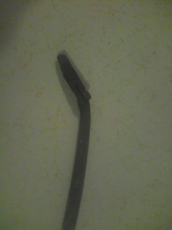

  19. This will probably be the last update, but I was able to get a successful forge weld! I was practicing making a rams head, and decided to give it a try. My wife has given me Mark Aspery's first book, which had gas forge welding instructions. I didn't clean the joint terribly well before bending it over, but brushed as well as I could, got it hot, applied a little borax, heated until bubbling, hit it 4 times lightly, then repeated as recommended. After I had finished the rams head, I thought destructive testing would be a good idea. As you can see, the 3/8" bar bent pretty far before joint failure. I am very new to forge welding (maybe my 3rd one), so if anyone has any suggestions they would be greatly received.

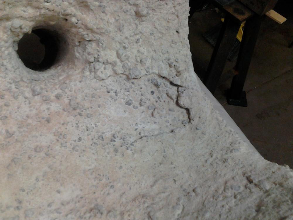

  23. Frosty- Thanks for the input. I have issues with wind since I am working outside. That particular night was pretty dead. Thinking about the wind issues, I did try to cover one side of the T at a time which has corrected the issue in the past. It didn't make a difference. I also thought about too much opening restriction. The tests there were inconclusive as well. Since the flame is not being drawn up into the burner, I don't think it is a safety issue. I will keep using it. If it persists, I will make a video, and try to figure out how to post it. I thought I was the only one that thought it was the spiders that caused my problems. I think about spiders every time I crack a high pressure tank before hooking up the regulator. Funny how some of those things stick with you 20 years later. bigb- Glad I can help. I hope including more information might fill in a gap in someones knowledge. The side where the fingers cracked it was a little tight to the base. I think I should have slowed down, and concentrated my pressure on the edge that was built up. Maybe I can be an example of what not to do.
  24. Fired the forge up again Friday night. I was able to bring a 2 lb. chunk of 1 1/2" 4140 to forging temp in about 20 minutes from start up. I enlisted my wife as the director for punching the eye. We did a test punch on a piece of 1/2" mild steel then worked on the hammer head. The MN Guild teaches a class on this style of rounding hammer that starts with the billet having two offset hole to guide the punch then upset the ends to shape. Since this was the first time she had ever done anything with hot metal, I was pretty impressed with how well she did in the dark no less. It is great making tools in my own backyard with other tools I made. I was also able to use the hammer head as an example of a practical use of upsetting when I was demonstrating the technique on 1/2" bar at a basic blacksmithing class yesterday. One thing I noticed while forging was some quiet puffing with little puffs of flame coming out around the hole where the burner is inserted. I tried adjusting the burner depth both ways, and adjusting the bricks covering the openings. Neither seemed to do much. I do have a thread protector on the end of the burner tube as a flare, but don't know if that would matter. The puffing occurred after the forge was warmed up very well. I will try removing the thread protector next time I fire it up. During heats on the hammer head I had no problem getting 1/2" MS to a nice yellow color, and thought I might get hot enough to melt a small piece if left in during a punching cycle. A leaf I was forging heated up in about 30 second toward the end of the 2 hrs the forge was on. Most of the forging on the hammer was done Friday night, but I worked on drifting the eye on the lunch break of the class yesterday. I am using a Brazeal style shape anvil I made, and am lacking a hardy hole. A striking anvil is next on the tool list.
