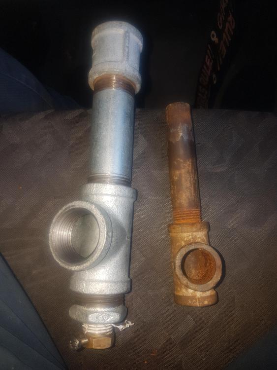

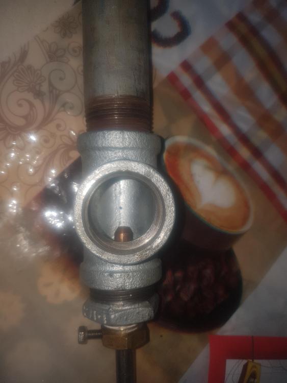

  6. Ok sorry guys i should of mentioned a few things. Firstly the reason im using the 1/2 brass plug drilled (on a lathe as well as the stainless tube for gas delivery) is because i had this made a few years ago for my 1/2 i ch burner and right now im not in the position to get a 1inch plug drilled as i jave no access to a lathe anymore and also i have limited tools including lack of a drill this brass plug is perfectly center even with the 1/2 to 1 inch adapter in place. I will attach some more pictures to give you guys a better idea of the burner design, if someone in the us is willing to collect these items i would be more than willing to pay for them aswel as shipping, i know thats a lazy way of doing it but the people on here will know exactly what to get aswel as what theyre called. Let me know what you think of the pics The welding tip and stainless supply line can literally go all the way to the brass plug, you could hold even just the tip of the mig tip in with that set screw, as well as this it can also go right the way down the burner mouth so it has fully adjustability with that part, i dont currently have a choke on this due to not having a drill. Thanx for the advice, i didnt mention this but i dont plan on using it as a side burner forge i just stuffed it up when i cut the hole so all i will do is shift the insulation abit so that the burner points straight down into the fire bricks instead of the kaowool wall

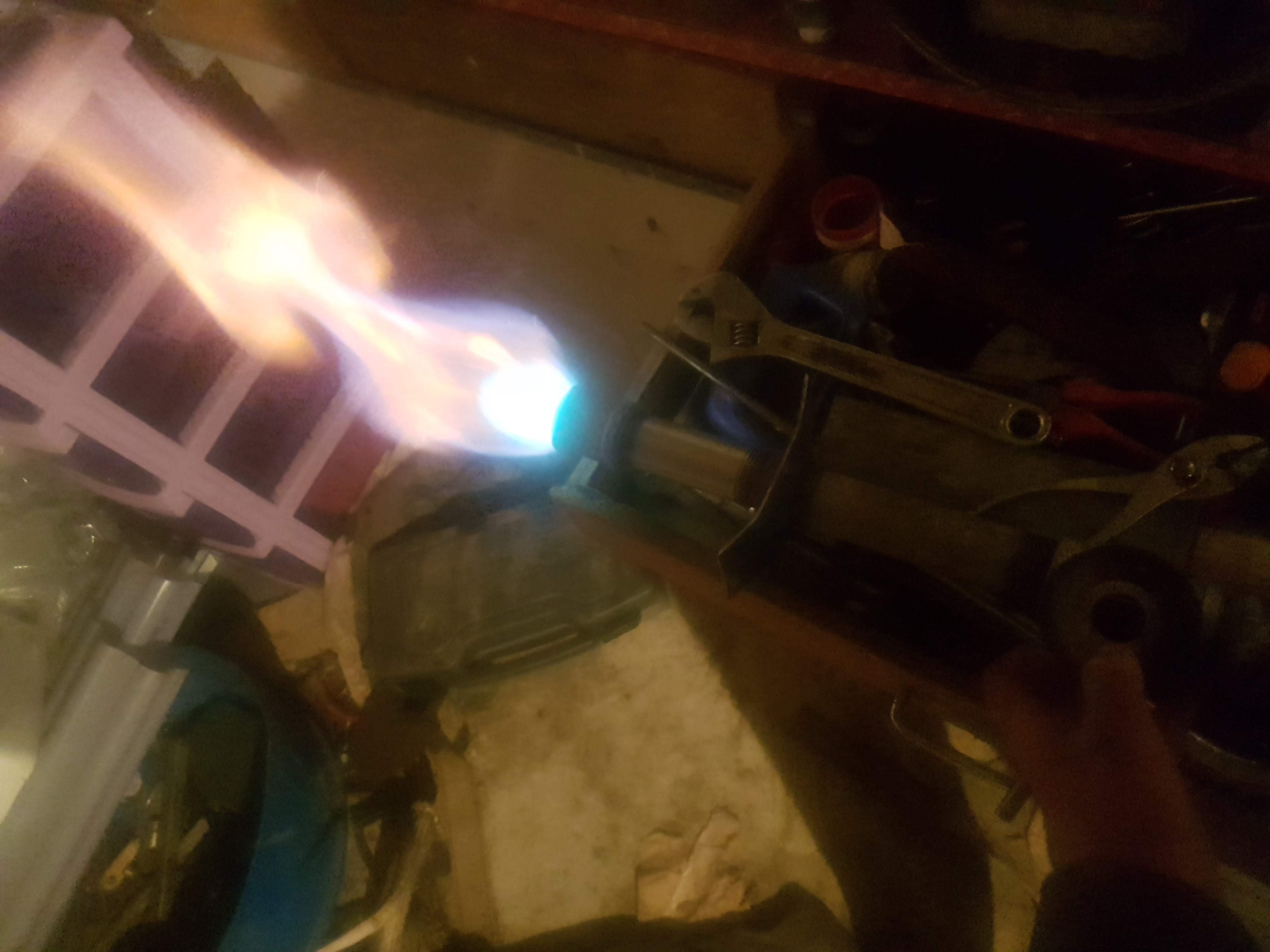

  7. So pulling the gas supply tube back only seems to make that wierd noise get louder and more unstable sounding. I might be wrong in saying this but could a almost empty bottle be causing this? I know it sou ds dumb to questioning that at this stage but i can still here liquid in it and it still has enough pressure to burn the 1/2 inch burner set up no problems.
  8. Hey Frosty, as always your the first to help so thanx. Firstly thanx for the warning about the galv burning although im aware of it already its good to see people out there still care for others. As to the 1"x8" your guess is as good as mine ive literally looked at every local store in my area for longer nipples but all they stock is the small ones i got, there is a store abit further awaythat aparently stock a number of specialty connections including black pipe but my problem is i only get off work 3 days a month and all my days are on the weekend when unfortunately this store is close not to mention its miles away from my area grrrr. As to your advice for adjusting the gas tube a bit further up the burner body I have honestly tried every position it could be in including as far back as the brass plug alows, this is why i am pulling my hair out at this.

  10. Hey guys so ive made a new forge from an air compressor and a new 1 inch burner and for some reason my burner flame doesnt seem to wanna stay put it keeps jumping from a good clean cone shape to just plane blue flames and is making a wierd sound i can only describe as a combination of a bottle cap rattling and a popping sound. The burner parts ive used are the best i can find in my area and the burner tube is the longest i could find in one section so i got 2. Burner parts are as follows: 2 1 inch nipples 4 inch long 2 1 inch to 1 inch connectors A 1 inch T A 1 inch to 1/2 inch bush A 1/2 inch brass plug center driller to fit my jet inlet A .8mm mig tip (ive tried varias sizes with no change) A stainless steel tube for gas supply with the end threaded for the mig tip. Im unsure of the real names of these so bare with me. Please if anyone can see why this isnt working please point it out because im usualy not too bad at getting these going. I have the burner connected to a 9kg lpg bottle with a 0-15 psi regulator which ive used flawlessly in the past with my 1/2 inch burner setup this burner was idetical to the new one except it doest require a bush to convert it from 1 inch to 1/2 inch for burner jet tube. Pics will be added for referances. Thanx for any help Forgot to mention the flame as ignites inside the burners down tube so basicly instead of burning at the end of the burner like it should itll be lit inside the tube
