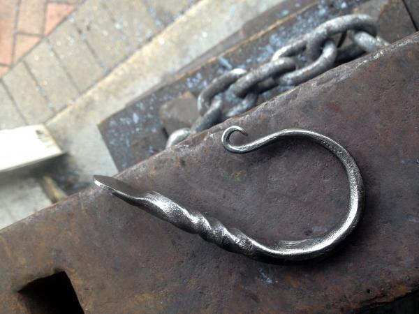

  12. Alec Steele made a great video on making hooks that I used to make my own with some success! The jig took 2 mins to weld up which allows you to do nice uniform hooks!

  16. I had a go at a different style today and managed to get it down to just over 15 minutes per hook! Still need to work on how I'm going to attach it- I'm going to get some brass screws, square headed bolts as suggested and try forging some nails and see what looks best. The first one I tried went a little wrong as the scroll wasn't uniform with the others, so I used it to replace a cheap plastic hook, I countersunk the hole and just used a normal screw with a black painted head and it looked pretty smart, so that's always an option!
  17. Thanks for the input everyone! The wood was in the same sort of condition as those used on pallets, but I'm fairly certain it's a softwood, I think it's supposed to be used on fencing. Either way, it was cheap and did the job- made it easier to sand down I guess! I burnt it and sealed it with teak oil. Considering the hooks are only held in by one screw, I think a good tight screw would be the best option- I can get brass ones rather cheap. Although I was thinking of cheating and using a nail but dropping some epoxy into the hole to hold it in place. I have an almost infinite supply of Plexus which is unbelievably strong, so that could be an option to make sure it stays tight!
