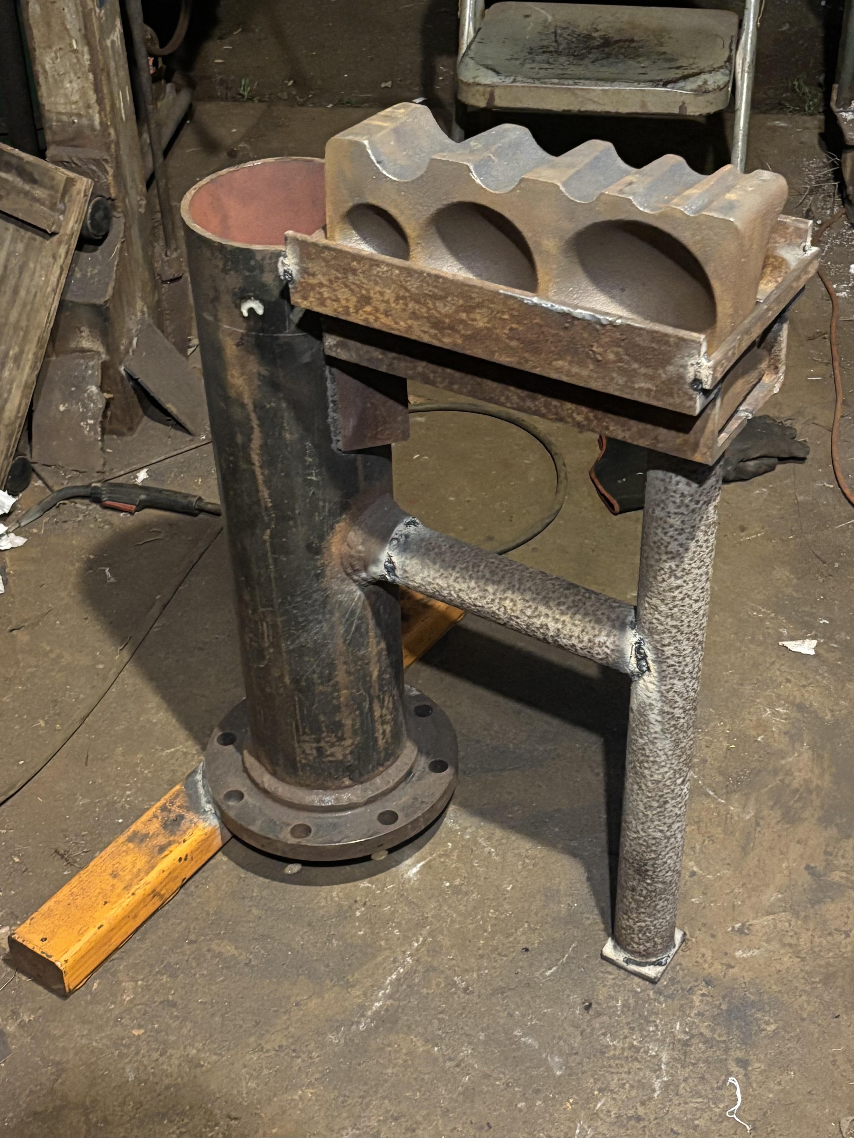

Thanks, Greg! I'm currently designing a stand that will hold both it and the Columbian vise I picked up earlier in the day.
(The dishing bowl patterns were also very nice, but I've been having good luck with the ones I made from old welding cylinders.)

Update: I made a stand for the block. Regardless of whether a narrow or a wide face is upwards, the working surface is about the same height as my anvils (as are the jaws of the attached striking vise).
557345253_10235923344457494_796502341948
557974423_10235909422229447_818137601049
The large pipe is filled with sand for additional mass and stability.

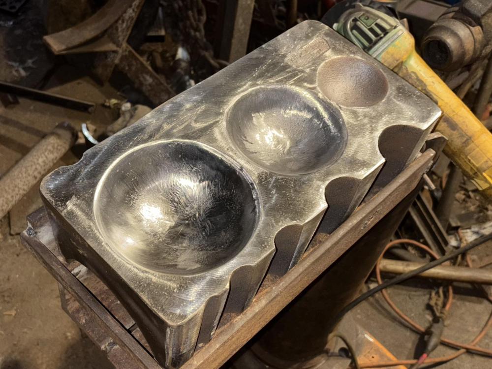

Looks like the photos I posted previously have vanished, so here they are again, along with some shots of the progress in dressing the block.
The stand holds the block both lying flat:
And on edge:
Since taking these photos, I've done a lot of additional dressing in the dishing hollows and the hollows on the edges, using a round stone tip in a die grinder.
