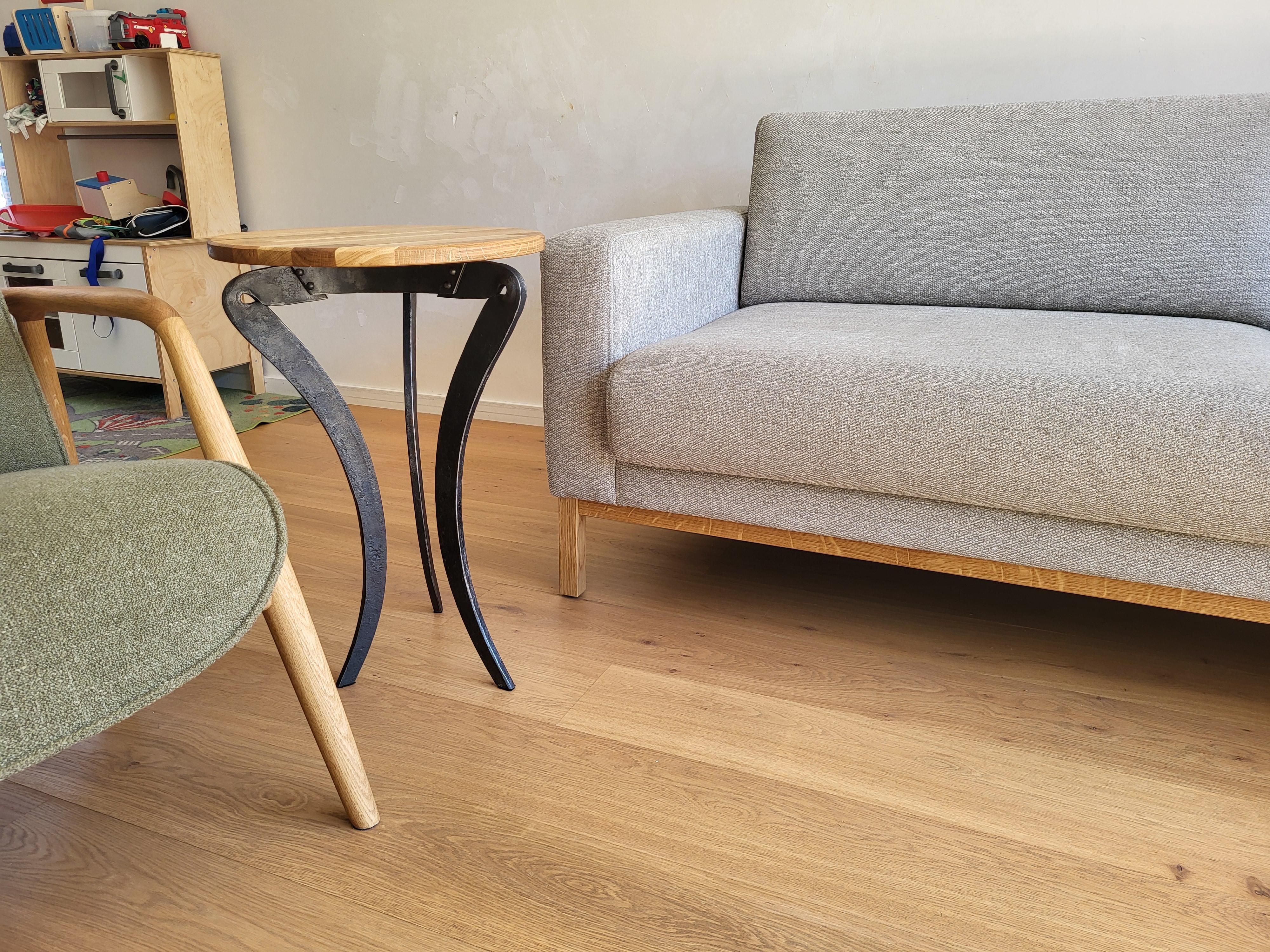

I'd be afraid of ending the legs in a near point like your side table would really scratch up your floor but a foot pad is out. So, how high does an object need to be to for your robo vacuum to "see" or bump it and turn?

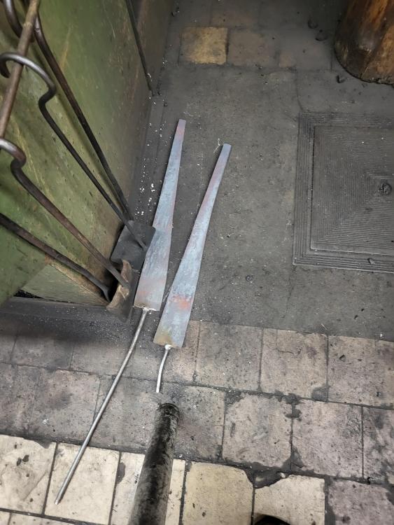

an update, I have a design (will take pictures of my sketches) and have start making a testpiece.
Will make pictures and update the topic.
