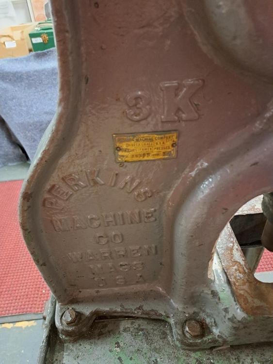

I ended up getting the press. I haven't found any more information online, but I found this in a Perkins catalog for power presses.  the "K" just denotes that it's a hand screw press. I'll try to get pictures, but here are some general measurements. It's a fair bit smaller that the #4 in the video above, but I think it'll still be pretty capable. The ram has about 6" of daylight, and the press is about 5'5" with the ram fully raised when sitting on the 2' tall stand. The footprint is about 26" square and the bar holding the handle and weight is 32" long

The press: image.thumb.jpeg.cdc6838046717a9bd689b7cce6d5d4b2.jpegimage.thumb.jpeg.189ab5525a3828b3ed0770a495c49833.jpeg
Made in 1956: image.thumb.jpeg.1d90a90a1924682e43f4a362253e4a0b.jpeg
The screw: image.thumb.jpeg.01de4fb676d42f3d908e90dfc6f0ac55.jpeg
The split nut. This seems to be different than on other presses. Examples I've seen from other manufacturers generally have a split nut and a lock nut, but on this press it's just this one that is threaded into the ram and held in place with a set screw. The set screw presses a copper slug against the threads to protect them. There are 4 holes in the collar, two on each half, presumably for a spanner. The cavity in the ram has a flat washer for the bottom of the screw to spin against, which sits in a bit of oil.image.thumb.jpeg.240133cb761961f57d370f7c86def88a.jpeg
The base plate on the press. The outermost holes are 1/2" and  attach it to the press body from underneath. The other two sets of holes are 5/8" and 5/16". The plate has a crack on the left side that goes through both threaded holes. The previous owner said it had never been an issue for them, so I have no immediate plans for trying to repair it. The tooling hole in the ram is 1-1/2" and has an adapter for 3/4" tooling shanks. The ram also has a hole that connects with the tooling hole, which may have been for knocking out parts that were being punched.

A couple thoughts to start. Have you looked at the patent drawings? They're available from the USG patent server, if not here look at the ones from the country of origin. They usually have detailed drawings, often blue print quality drawings. You have the serial and model number to go with company name and only have to delete your way through the adds.
 In drawing 1 it looks like the mounting bolts and the bottom of the die table aren't on the same plane, any gap under the bottom die(?) "feet" would cause flexing through the mounting bolts, the hammer isn't going to flex so metal fatigue stresses would build to failure. . . Somewhere, maybe the broken bolt holes?
I don't get how parts would get stuck IN the ram to require a wedge to knock out. In all probability it's to knock out tapered shanks as is the Morse #2 taper in the tail stock of machine lathes. The main hole in that thought being using a taper coupler with repeated impacts through it.
I hadn't thought to check patents, that's a good idea. I'll see what I can find there. I had imagined the base of the press underneath the die table was thick enough that it wouldn't be flexing, but I wouldn't be surprised if that was the case. I think it's also possible for it to have cracked some other way, like if a piece of debris was underneath the die table when it was bolted on, that could have also caused flex and eventually failure-- just an idea.
You're probably right about the cavity in the ram. It could be that it was simply to prevent tool shanks from bottoming out, upsetting, and getting stuck.
I had a sky balling kind of thought after sending that post, perhaps because of the direction the weight turns there is more shock loading on the left side. Or maybe more likely, those screws tend to work loose. Loose screws are stress risers though it's often a screw other than the loose one that suffers.

Nothing like those sleeves or wedges, but it did come with a box of punches and dies for punching various shapes in sheet metal. As far as I can tell, the tool hole in the ram isn't tapered. The shank of the adapter is straight (as far as I can tell) and there isn't the slightest bit of play between the two. It's possible that it's a percentage of a degree, but it doesn't seem like it. I also haven't noticed any wedging between the two when trying to remove the adapter-- it's a tight fit but it spins freely even after heavily using the press.
